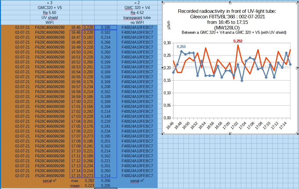

Here the influence of UV light on the measurements made by 2 geiger -muller counters was investigated. In one geiger counter the tube was transparent, the other contained a so-called UV protection shield, supplied with the purchase.
The 2 geiger counters were placed simultaneously on their backs on two lit UV light tubes*, over a period of 30 minutes. REMEMBER: "ON THEIR BACKS"!!
The research shows that the claim according to which the UV light gives increased measurements with Geiger counters equipped with transparent tubes has not been proven here: they are even lower than the measurements made by the Geiger counter where the tube is surrounded by an UV shield.
Mean value with UV-shield: 0.223 uSv/h Max.value: 0.292 uSv/h at 17:02 .
Mean value transparant tube: 0.205 uSv/h Max.value: 0.266 uSv/h at 16:48 .
Breizh
*The Hi-Tech Lamp with part number F8T5/BL368-U is a 7.2 watt (7.2W), 57 volt (57V) UVA Blacklight Lamp made by Ushio. This lamp has a 15.5mm diameter and an overall length (excluding base pins) of 287mm with G5 miniature bi-pin bases. This UVA Blacklight Lamp has an average life of 3000 hours. It has an initial UV output of 1.2 watts, with a spectral peak at 368 nanometers (368nm). This lamp is also known as Ushio F8T5BL, F8T5/BL and F8T5/UVA.

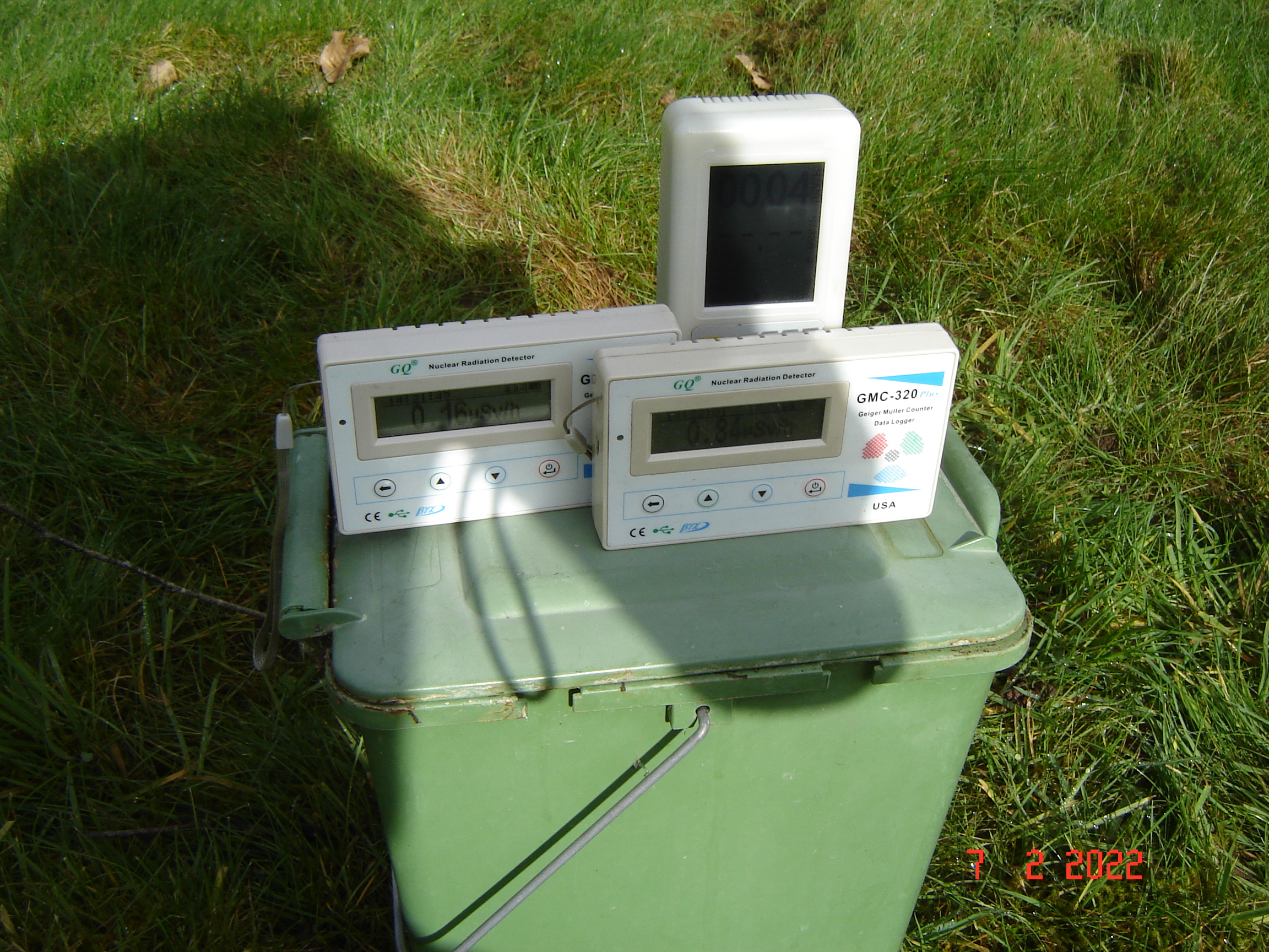

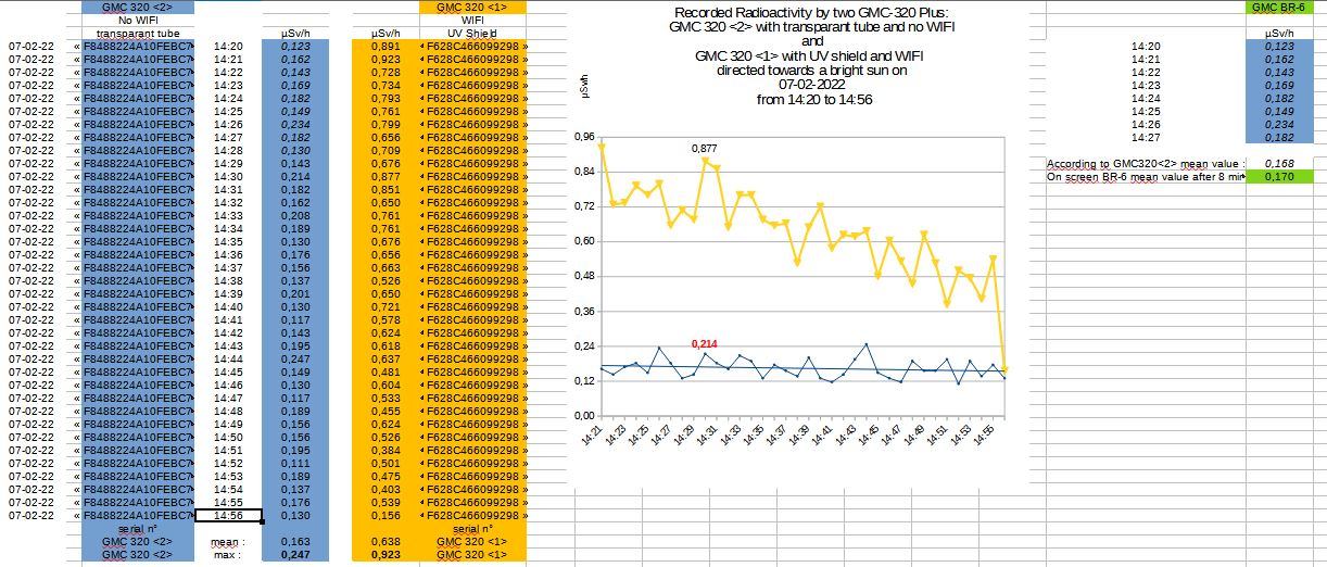

Here the influence of SUN light on the measurements made by 3 geiger -muller counters was investigated on 7-2-2022. In one geiger counter the tube was transparent, the other contained a so-called UV protection shield, supplied with the purchase.The third one the BR-6 does not allow to record the data but gives the mean value on its screen after 8 minutes.
The 3 geiger counters were placed simultaneously in front of the sun, from 14:26 to 14:56.
The research shows that the light of te sun gives increased measurements till 0.923uSv/h with the Geiger counter with an UV protection shield.
Mean value GMC with UV-shield: 0.638 uSv/h Max.value: 0.923 uSv/h at 14:21.
Mean value GMC with transparant tube: 0.163 uSv/h Max.value: 0.247 uSv/h at 14:44.
The BR-6 counter indicates only a mean value after 8 minutes of 0.170 uSv/h. Nearly in concordance of te mean value of 0.168 uSv/h calculated from 14:20 to 14:27 on the GMC with transparant tube.
Measurements of the last two GMCs indicate an operating error of the GMC 320 <1> under sunlight.
The finding of violet_sin is confirmed here.
Conclusion: there is a problem with the GMC 320 <1>, it has to be solved by GQ Electronics.

Hi Breizh, what are their readings without sunlight? I remember long time ago you had 3 meters. 1 was higher that 2 and we said that that tube is defective and would need to be replaced. Is it the one on the picture?

The influence of UV light on the measurements made by 2 geiger -muller counters was investigated on 2/7/2021. In one geiger counter the tube was transparent, the other contained a so-called UV protection shield, supplied with the purchase.
The 2 geiger counters were placed simultaneously on their BACKS on two lit UV light tubes*, over a period of 30 minutes.
End of discussion!
Breizh
Edited by - Breizh on 02/12/2022 12:34:50

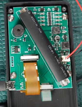

his Chinese BR-6 counter also includes an M4011 tube with anti-UV protection (a piece of electrical sheath with a diameter of 12mm)
(if it the same like this one):
Edited by - Damien68 on 02/09/2022 13:04:38

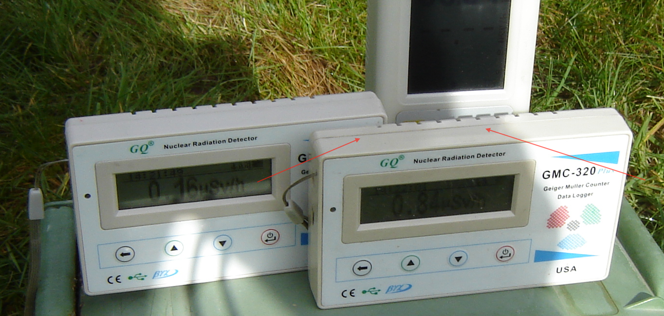

Posted - 02/10/2022 :  01:32:08  Show Profile  Reply with Quote
Hi Breizh,
to test the sensitivity of the counter to light, what is needed is to illuminate the back of the counter so that the light passes through the openings at the back of the counter and hits the GM tube.
it is not the meter display that should be exposed to light first.
I say this because in your photo you expose the front of the counter directly towards the sun. it is the opening on the back of the counter that must be sensitive to light.
it may be for this reason that you do not find any reaction during your initial test with the Hi-Tech Lamp at 368 nm if their is no direct enlightment of the GM tube through the openings of the case
