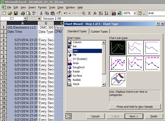

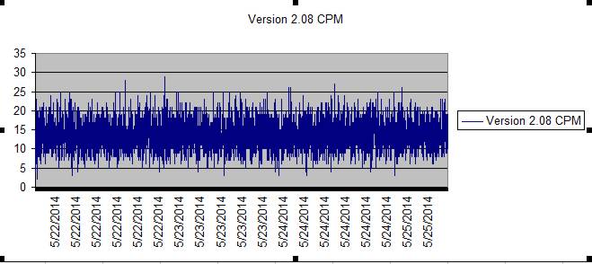

The graph normally is depending on the software you have.
I am using MS Excel spreadsheet software. It has graph wizard, you can just highlight the data you want to generate the graph and then click on the graph wizard icon.
Here are the steps:
1. open the .csv file from Excel software.
2. highlight the data columns you want to show on graph. here is the Date and CPM.
3. click on the Graph wizard icon
4. select line format
5. finish

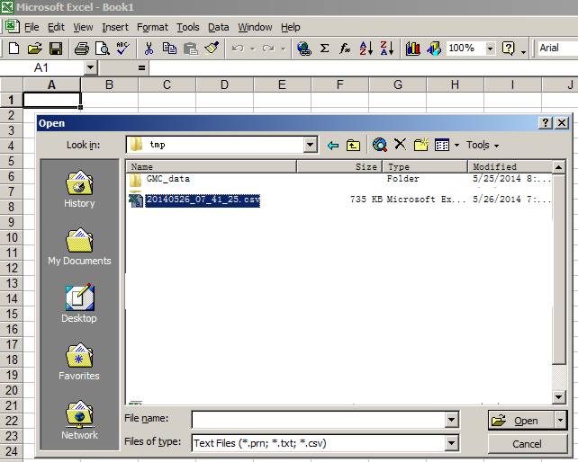

[b]Step 1: Load the CSV file[/b][br][br][size=1] 51.95 KB[/size=1]

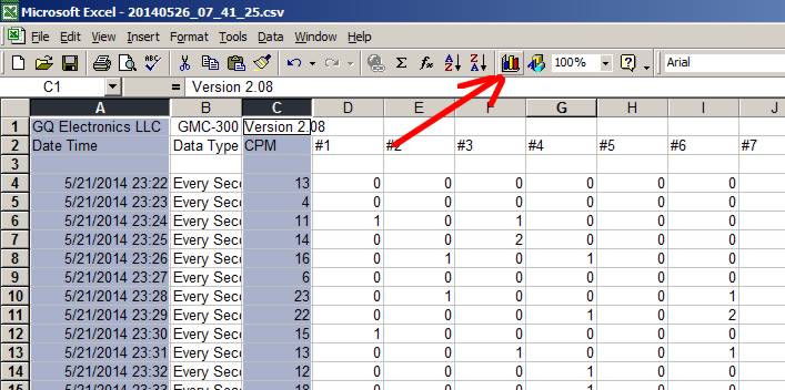

[b]Step2: Highlight the data you wanted(Hold CTRL key and then click on column letter cell. Here are A,C columns.)[/b][br][br][size=1] 57.92 KB[/size=1]
[b]Step3: Select graph wizard from toolbar[/b][br][br][size=1] 57.92 KB[/size=1]

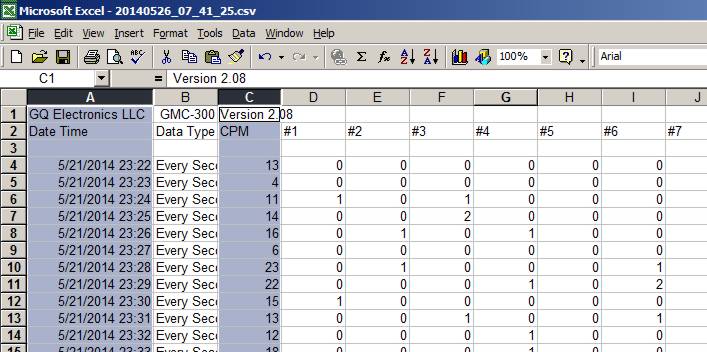

[b]Step4: Select line format from graph wizard[/b][br][br][size=1] 57.92 KB[/size=1]
[b]Step 5:[/b][br][br][size=1] 36.81 KB[/size=1]

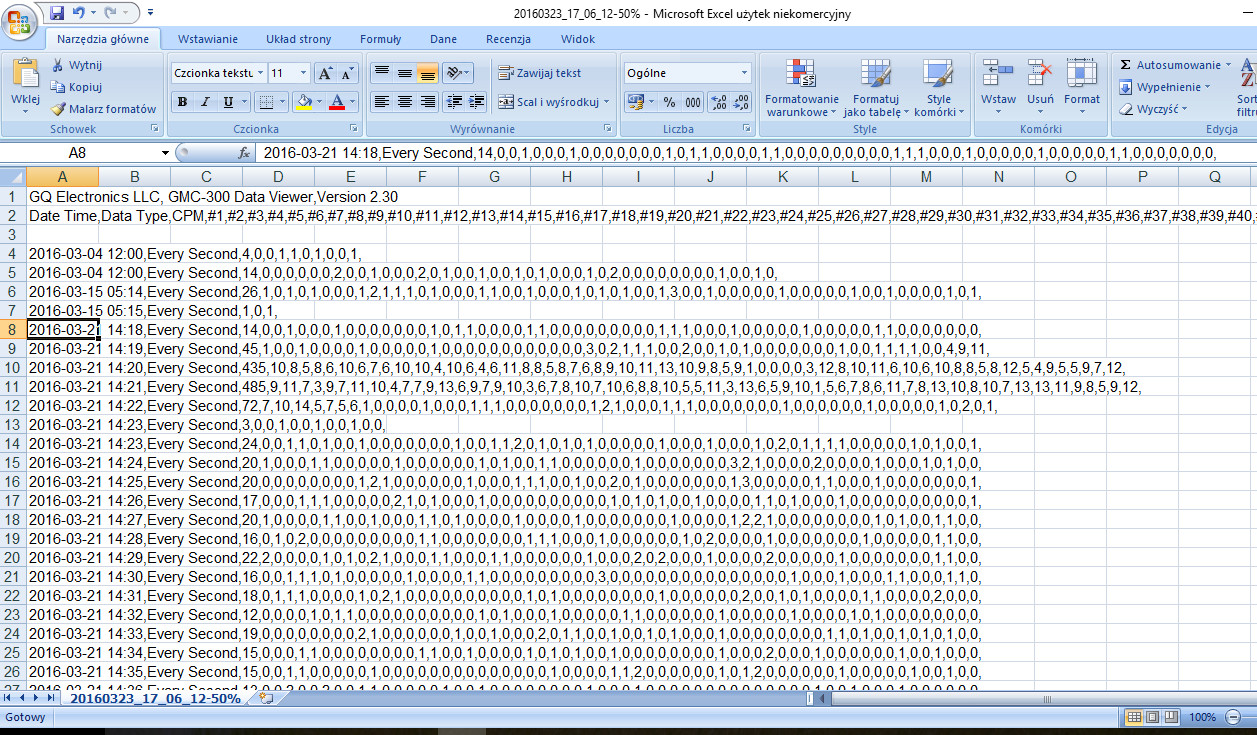

Thanks for help, but it doesn't work with my csv.
Problem is, that generated by my version (2.30) of data viewer csv is different that yours. I have everythig in "A" collumn. Please look on attached screenshot.
700662 bytes
Posted - 03/30/2016 :  16:37:14  Show Profile  Reply with Quote
you should open the data file as .csv.
Post your data file here. I do it for you.
