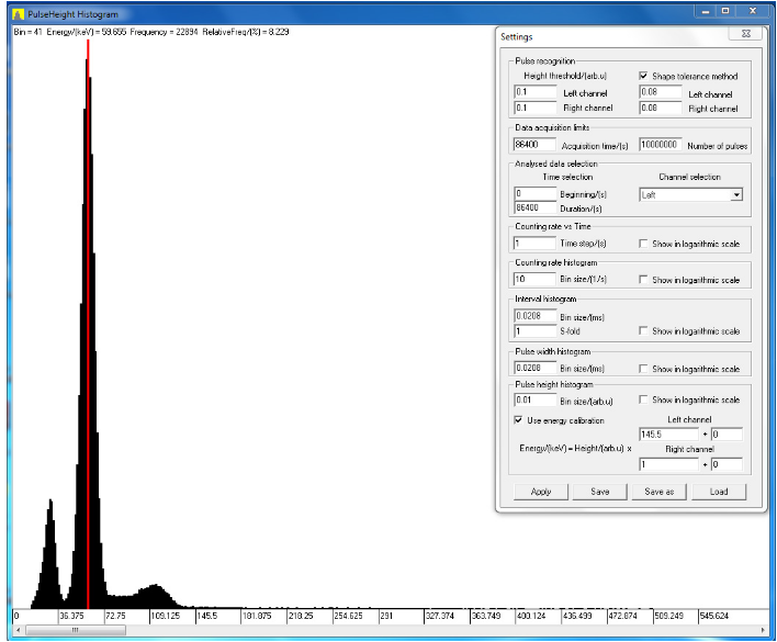

However, as much as I know all, no exception, of those alpha emitters can emit gamma through some decay paths, at least through decay of daughter nuclei. Shown next is a gamma spectrum of Am241, and you see some very prominent lines below 150keV, but also some crumbs up to 500 keV.
The very low gammas might not be detectable in your counter, because they may not even pass the plastic of the counter housing. You might see some counts when you take off the back-plate and try again. But, I agree, something higher than background should be visible!
