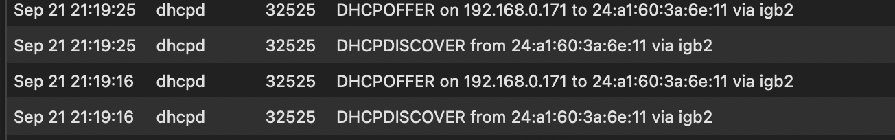

Couldn't set up wireshshark until now and have no Fritzbox,
But on my DHCP server I saw many dhcpdiscover and also
sent dhcpoffer messages from a device which seems to be
the unit (client id esp_somehexcode and timely very narrow
to when I tried to activate WiFi again).
But there is no dhcpack message and again the unit
Itself reports module error and resetting the module also just reports
Module error.
So there seems to be some WiFi communication even already beyond wpa
WiFi authentication when it seems to try get an IP. Don't know why it
Doesn't accept the ip offer. Never had any problems in this regards with any
Device (and I got quite some other esp powered devices in my WiFi).

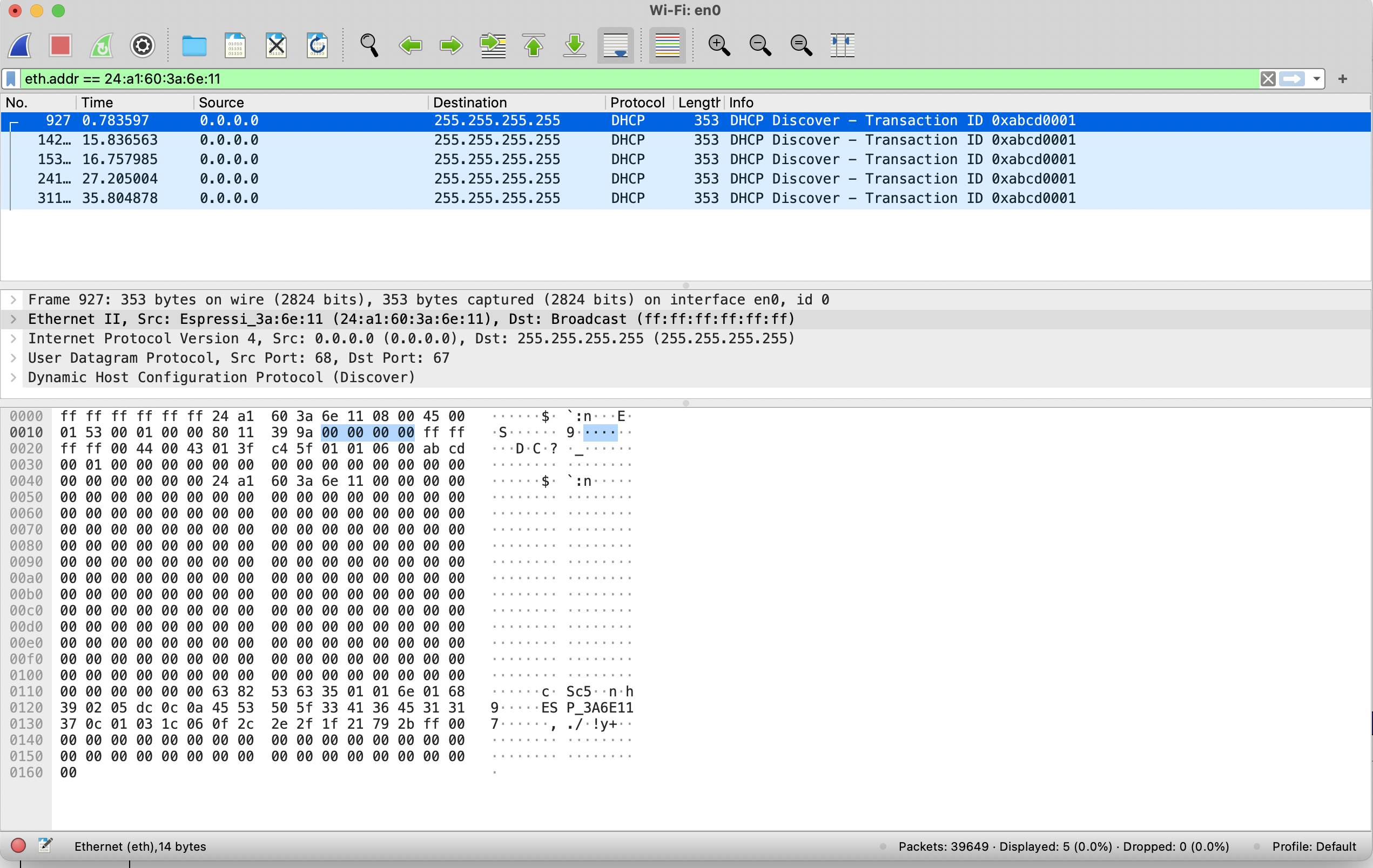

Just a note on ullix . i meanwhile setup Wireshark, but i all i could see - if i could again make the unit to really at least try to get ip ... it not always does - i can see the DHCP transaction i also see on my DHCP server in the logs. Nothing more..
