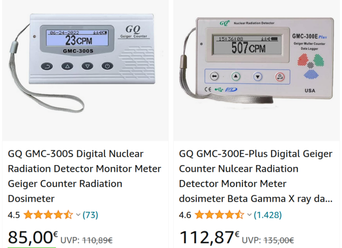

It looks like GQ is replacing their old Geiger counters with model names GMC-300E+, GMC-320+, and GMC-320+V5 with the "S"-series.
At present it looks like the new counters use the same motherboards as the old ones. They should already be recognized by GeigerLog.
However, I do not know what - if any - changes were applied to the firmware, which might make GeigerLog stumble in working with them.
If you own one of these new counters, please post here and we can figure out any changes!

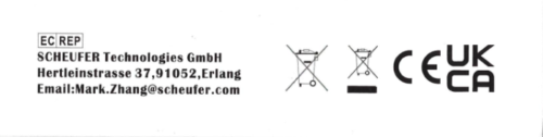

On my counter - neither the counter itself nor anywhere on the box, nor on any paper stuff inside - is a "Made in ..." label.
The box carries this imprint at the side, which looks like an address to a German distributor (note the Chinese sounding email name Mark Zhang):

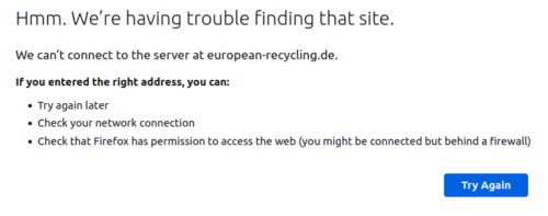

The interesting part is, when you try to open "scheufer.com" in a browser. First it's redirecting you to https://european-recycling.de/, and gives this output:
One can ping this site, and gets:
ping european-recycling.de
ping: european-recycling.de: Name or service not known
So, this site does not even exist!
One can ping and "whois" the scheufer.com site. This site does exist, and it is registered in Germany, but that's all one can find.
Yeah, this is the way to build confidence in the consumer!
Posted - 02/26/2023 :  07:54:04  Show Profile  Reply with Quote
Googling "SCHEUFER Technologies Gmbh" it found it at the right address and it says it's an electric bike store. pity there is no street view.
I expected a screwdriver factory :=)

Another company is now offering the 300S for 112€ + 54€(!) shipping. Yeehaw, what a deal. Looks like a really bad start for GQ.

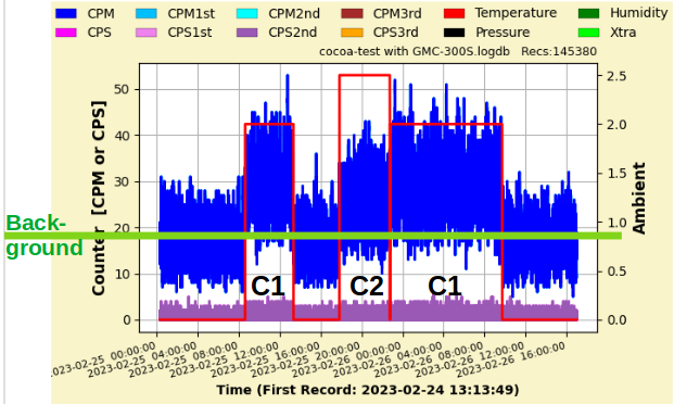

In continuing my checks of the 300S counter, I tested another famous source of radioactivity: Cocoa Powder, the very stuff which is used to prepare chocolate drinks, much liked by kids (of all ages).
Cocoa is rich in potassium, much richer than the famous bananas. See my successful but cumbersome work with bananas "Going Banana" : https://sourceforge.net/projects/geigerlog/files/Articles/GeigerLog-Going%20Banana-v1.0.pdf/download
I tested cocoa power like this one: https://www.amazon.de/Bensdorp-Kakao-Kakaopulver-Trinkschokolade-Getr%C3%A4nkepulver/dp/B003SGDC8U
If you want to repeat the experiment, get cocoa similar to the above. But avoid everything which claims to be "enriched" by whatsoever - you want it as pure and clean as possible!
Cocoa is a breeze to test with any Geiger counter, and the GMC-300S fared very well. Here is the result. C1 and C2 are two variants of cocoa powder, both from the supermarket. The higher counts (C1) come from the above linked-to Bensdorp variety.
Of course I checked Poisson on all sections, and all are fine. FET had been switched off (i.e. set to 60[sec]).
But this showed a new problem with this counter. As so far the FET setting had been located in the upper half of the 512 bytes configuration memory, and now the "S" variants have only 256 bytes (like the old 300E series), the FET setting is at a new location (which is 69dec). And since it is now sitting on a place which previously was used by the WiFi setting, several settings will have to move to accommodate the "S" series.
