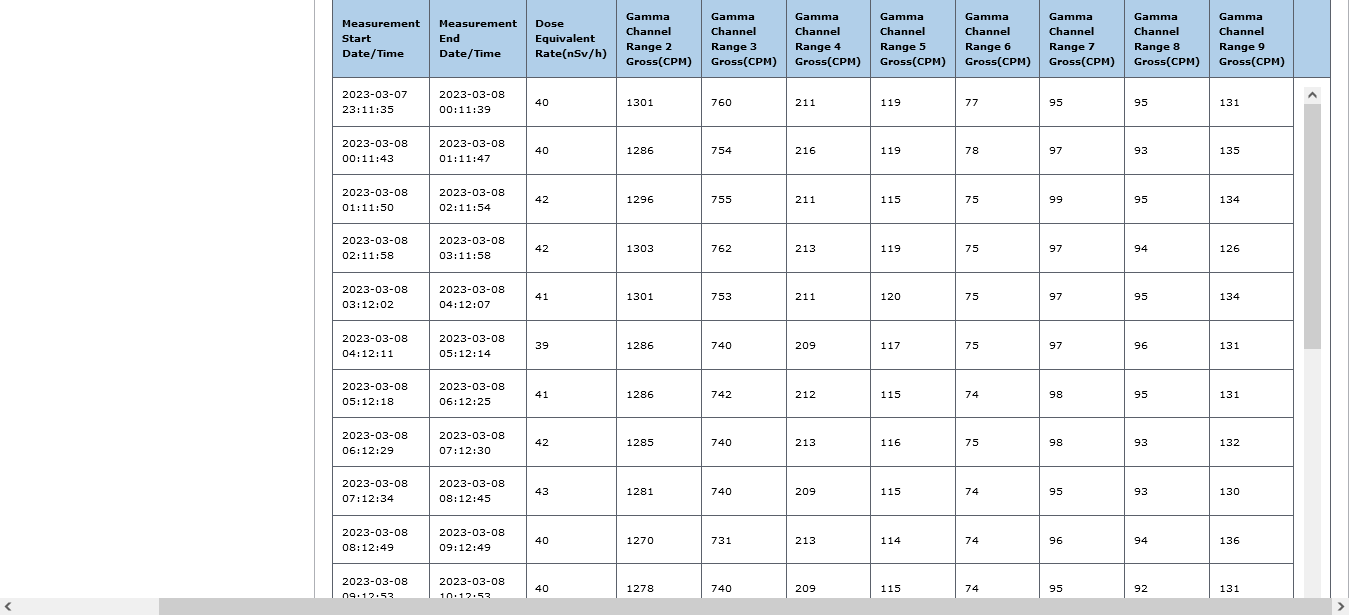

Here's an example of a few hours output from a day or so ago from the RadNet site for the Austin metro area.
I understand (I think) what you are saying. Different energy levels for different particles and that might be what these Gamma channels are.
Do those CPM measurements look reasonable? Cuz I'm not getting anything greater than about 40 CPM with the 320S. Seems like it would be much higher especially if the 320S doesn't discriminate between energy levels. It would count ALL events equally within its range of energy detection. Right?
Does the Dose Equivalent Rate look right? Cuz once again, it doesn't really match up with what the 320S is saying. It's been running continuously for nearly 24 hours now and it's showing a Dose Equivalent Rate of 0.12 uSv/Hr. I always mess up the darn decimal point, but if I have it right, the 40 nSv/Hr we see in the RadNet report is the same as 0.04 uSv/Hr or about a third of what the 320S is reporting.
If that's correct, that means the 320S has a 3X difference and that's gotta be significant. Is this just the nature of these economy priced GCs? They only offer a relative value, not an accurate one?
So should I ignore the actual value it presents and look instead for substantial variations from the norm (norm according to the 320S)?
Clearly this is pretty new for me and I'm struggling to figure out if I'm getting accurate data or just relative data. If I ever had to use this during some post apocalyptic event, I'd really want to know the actual radiation levels. In this case what the 320S reports could be three times higher than it actually is. I'd rather have it report too high than too low, though. Tell me it's safe and it's not is kind of an issue!
Posted - 03/09/2023 :  09:59:40  Show Profile  Reply with Quote
in your counter there is a Geiger-Muller tube, the counter therefore counts the number of particles that pass through the tube.
if for example you consider another counter with a tube twice as big, it will detect twice as many particles for the same level of radiation and therefore its CPM will be twice as high for the same level of radiation as with your first one counter.
CPM levels are therefore highly dependent on the type of sensor (tube) used.
Certainly in the metro there are several sensors and larger sensors which would explain why they obtain very much higher CPM levels, but this sensor configuration don't change the uSv/h value.
In the metro, it is buried, the levels of radiation are certainly very much lower than the level of radiation on the surface which explains that they have only a few dozen of nSv/h and that at home you have a few hundred of nSv/h.
I think your datas are consistent.
