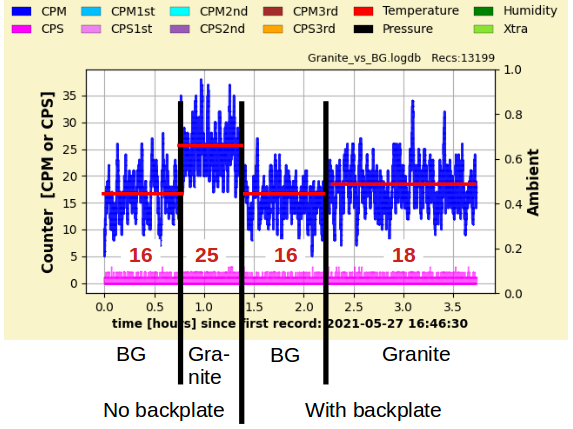

@ellie: I ran a few quick tests on Granite. "Quick" means at least 1 hour of measurements per condition!
I used an GMC300E+, which has the same or at least similar tube as the GMC500+ has as its main tube. The logging was done with my software GeigerLog ( https://sourceforge.net/projects/geigerlog/ )
The tests were run with 2 conditions: one had the counter's backplate removed, the other had it on. For both I tested the background, as well as the counter on Granite.
You see a background of CPM=16. When on Granite with the backplate on, counts increase to CPM=18. With the backplate off, counts increase to CPM=25.
Granite's radioactivity is detectable. Although barely so.
The count difference between with and without backplate suggests that the Granite is emitting some beta radiation, which is mostly absorbed in the thin plastic of the counter's backplate and thus does not reach the tube when the backplate is on.
For more on this, see my "Potty Training" ( https://sourceforge.net/projects/geigerlog/files/Articles/GeigerLog-Potty%20Training%20for%20Your%20Geiger%20Counter-v1.0.pdf/download ).
The radiation level of Granite, or any other building material, is just very low. You'll find more in garden fertilizer due to its content of Potassium, again, see Potty Training.
