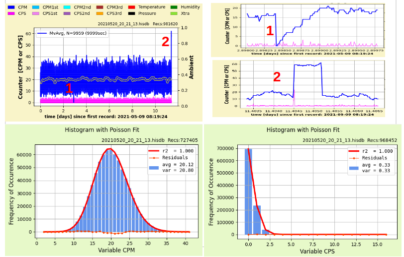

Thanks, Matiahi. If anyone is interested in some genuine, nice counter data, I encourage you to download and take a look.
I used one of the *.bin files which is just short of 1 million records, covering more than 11 days.
The counter had been set to CPS recording. CPM is calculated from CPS, both in GeigerLog as in the creation of CSV files.
The upper left portion shows the complete time course as read from the counter. Magenta is CPS, the original data, Blue is CPM, derived from CPS.
I always recommend to show the Moving Average, the yellow double-thin line wiggling in the middle of the blue. Clearly, no long term trend is visible; the data are constant over time.
There are two exceptions in this graph: one is near 3 days marked with a red 1, the other is near 11 days, marked with a red 2. The two smaller pics show what it is: @1 looks like the counter had been reset, which resets CPM to zero, and so it takes 60 sec before it reaches proper CPM again. @2 is a spike in CPS of some 20+ counts. This looks like some artifact, perhaps electronic noise impacting the counter.
So I limited the analysis from t=2.9d ... 11.4d to exclude those artifact regions from the CPM analysis, and from t=0 ... 11.4d for CPS.
For analysis simply press the Poiss button. GeigerLog calculates for a few minutes (!, these are big files) and shows the bottom left picture for CPM.
On first glance you see the data from a near perfect Poisson distribution. R2 (=r-squared) is exactly 1 in the best case, and is 1.000 here. CPM average is 20.12, and CPM var is 20.80. In the perfect case, these two numbers are identical. Further, the residuals are as close to the bottom line as you may ever see.
In the CPS case all numbers are perfect, but this is less meaningful because you have only 6 different bins to fit: 0, 1, 2, 3, 4, 5. CPS avg in 0.33. As a rule-of-thumb: look at CPS only when its average is >= 10.
Overall: this is as good as it gets; data are in a quality ready to be put into a text book. And not the slightest hint of anything unusual with respect to radioactivity (and perhaps you have an idea where this supposed electronic spike might have resulted from; but those spikes do happen with counters).
Counts are random, though strictly governed by Poisson. Strange sequences of numbers may result. Just convince yourself by loosing some money at the Roulette table ;-)
An intro on Poisson in my "Potty Training" https://sourceforge.net/projects/geigerlog/files/Articles/GeigerLog-Potty%20Training%20for%20Your%20Geiger%20Counter-v1.0.pdf/download
Beyond that ask Google.

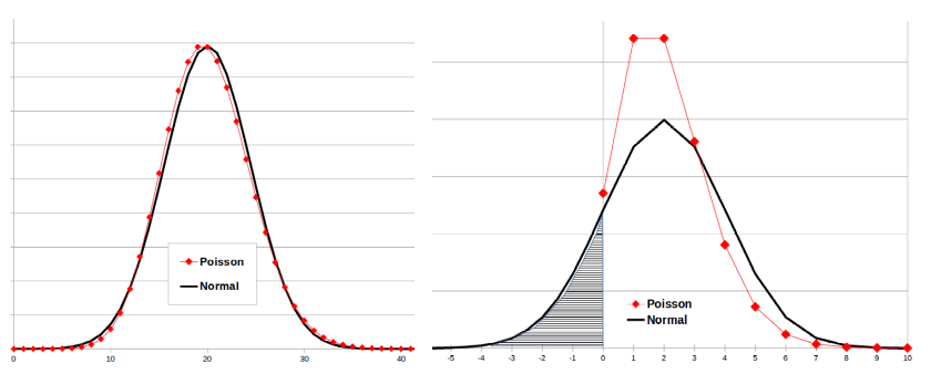

Gaussian distribution, Bell-curve, Normal distribution are different names for the exact same thing. I prefer the name Normal dist.
A Normal distribution is fundamentally different from a Poisson distribution!
A Normal dist is valid from minus infinity to plus infinity, and for every number in between. Poisson is valid from 0 (zero) to plus infinity, but ONLY for integer values, so like: 0, 1, 2, 3, ...
Normal is often useful to describe the error in measurements of smoothly changing parameters, e.g. temperature, voltage, speed. Poisson only applies when you can count it: car crashes on an intersection, whale sightings in a bay, counts from a Geiger counter.
A Normal dist is described by 3 parameters: average, width (=std.dev., 'standard deviation'), and height. A Poisson needs only 2 parameters: average, height. The width is already known as std.dev. = square_root(average). As 'variance' is the square of the std.dev., it follows that for a true Poisson dist average = variance! If this is not fulfilled, it is not Poisson, and a Geiger counter measurement is not valid!
When we graphically depict these distributions, they may look like this:
On the left side the dist are drawn with average=20. This implies that std.dev for Poisson is sqrt(20)=4.472 and so Normal is drawn with this std.dev! One is hard-pressed to see a difference between these two curves. However, keep in mind that the Normal is valid on all points on the black line, while Poisson is valid ONLY at the dots. It does not exist between them. The thin read line is drawn only to guide your eyes from one valid point to the next.
On the right side, drawn with average=2, you see where Normal even fails graphically: not only is the difference between the two curves more pronounced, but the hatched area for Normal shows negative counts, which obviously cannot exist.

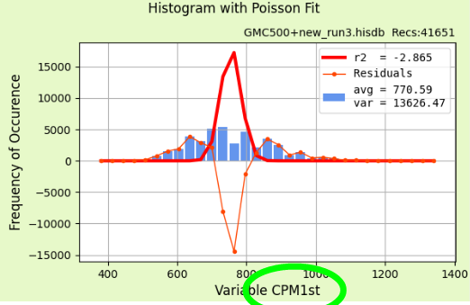

R-squared (here as r2) is a statistical property routinely used to describe how well your model for the data fits the data. It has nothing to do directly with Poisson's or any other distribution's property. By the way r2 is calculated, it is 0(zero) when there is no agreement at all, and 1 if there is perfect agreement. (it can be negative when the data are really crappy!)
Here you have the data from your counter, and your model is the Poisson curve. In my above Reply#5 you have in bottom-left of the picture your data, the blue columns, and the thick red line the Poisson model. Already visually they do agree, and R2=1.000 is just a confirmation. With avg=20.12 and var=20.80 it is close but not perfect. As a 4th thing to do, look at the residuals. They should wiggle around the bottom line with no discernible pattern. Considering all 4 things, this is a measurement of text book quality. It will not get any better.
Here an example of a very recent GMC counter firmware "improvement", which got terribly wrong, ruining otherwise good data:
Apply your 4 criteria from above the see why it is awful.
A Poisson test of your data is possible only with my GeigerLog software https://sourceforge.net/projects/geigerlog/ and in GeigerLog easily achieved by just pressing a button.
