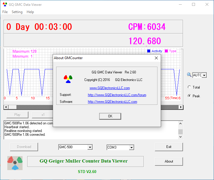

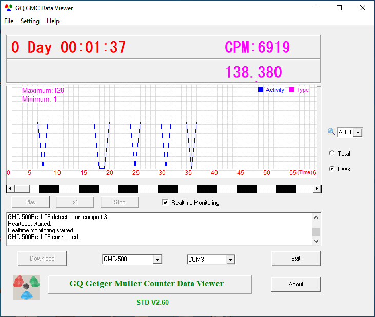

Updated to latest data viewer software recently.
Now appears to be producing these readings,.... Image 1
And here's it about box,.... Image 2
Would a firmware update help resolve this condition?
Any ideas would be appreciated.

Posted - 02/07/2020 : 10:18:52
I think you need to turn off the Third Party Output in the settings. Main Menu->Others->Third Party Output.
