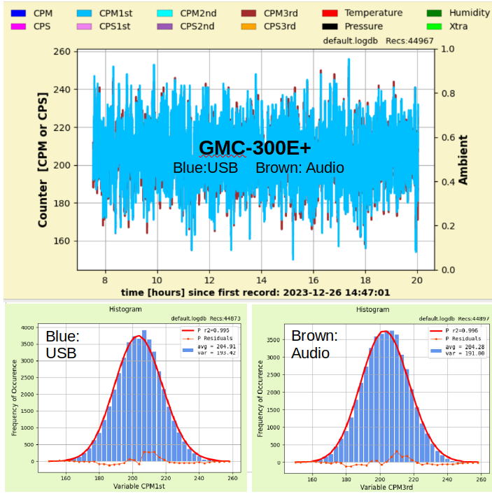

By GeigerLog's internal benchmark the new Raspi5 comes out as 4 times faster than the older Raspi4, so I tested AudioDevice performance again. Result: the Raspi5 handles this easily, as the pic shows:
I used a GMC-300E+ counter, and connected it to the Raspi5 by USB, and also by the counter's sound output, using the same 8€ soundcard as before (see GL manual).
In blue is the count rate measured via USB, in brown measured via Audio. The brown is barely visible because it is nearly completely identical to the blue. This is also seen in the average values:
Variable  [Unit]       Avg ±StdDev    ±SDev%  Variance     Min ... Max    Recs
CPM1st  : [CPM]    204.711 ±13.872    ±6.8%     192.43     150     256   46885
CPM3rd  : [CPM]    204.099 ±13.792    ±6.8%     190.21     152     253   46885
It cannot be fully identical because of the different time base.
The Poisson test for each of the tracks is also good and the two are also nearly identical.
