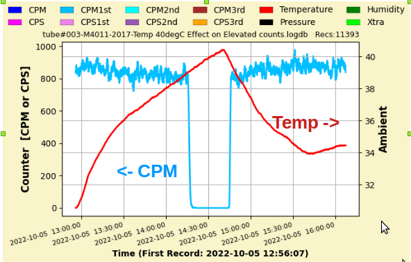

Case in point: I ran a temperature experiment, got called away, and when I returned saw that the counter had crashed. I shut down the heat source (a lamp), and this resulted:
The GMC-500+ counters CPM data are in blue (left scale), the temperature in °C is in red (right scale).
The counter seems to "reliably" crash when its temperature reaches 39°C. This is 102 F! Even stranger, it also recovers at the very same temperature.
Even more urgent than before : don't touch the counter when you have a fever. That temperature is enough to crash it ;-))
How did I run this result: I took advantage of the abilities of my newly released GeigerLog 1.4.0. A counter GMC-500+ was connected to a Raspberry Pi (Raspi 4), and the Raspi also got an I2C sensor for temperature and for light intensity. The Raspi ran GLWiFiServer.py and acted as a WiFiServer (in GeigerLog lingo), sending data by WiFi to the main computer running GeigerLog. Some earlier work on a similar setup is here: https://sourceforge.net/projects/geigerlog/files/Raspi/Using%20Raspi%20as%20a%20GeigerLog%20WiFiServer%20Device-v2.0.zip/download
All was put into a dark-box to avoid light impact. The light sensor reported exact zero (< 4 Lux) thoughout the run.

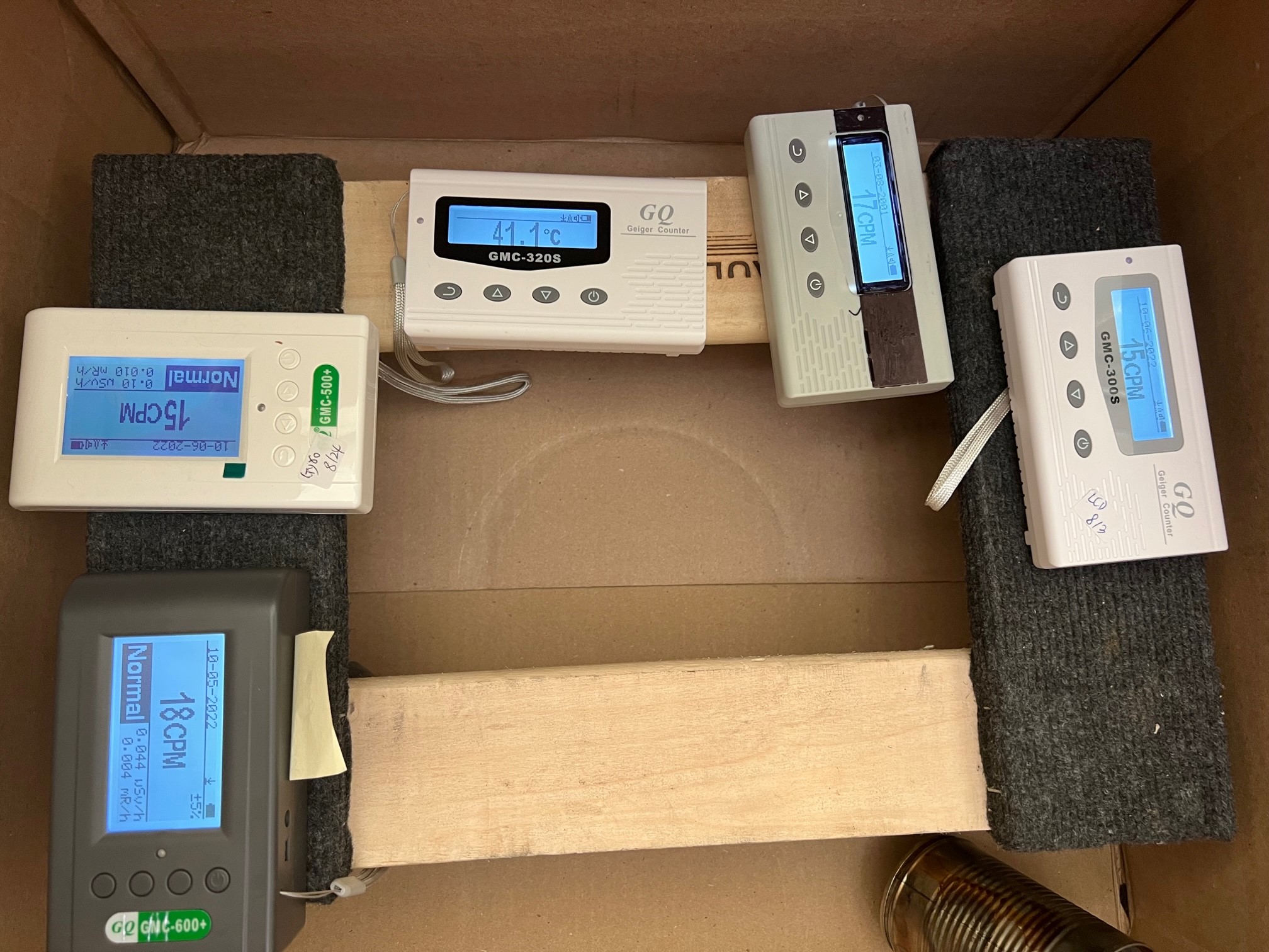

Just did a simple test and all the current version counters still work above 40°C. Unless you get extremely high fever, it's ok to touch the counter.
