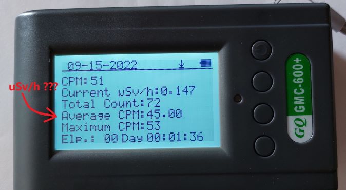

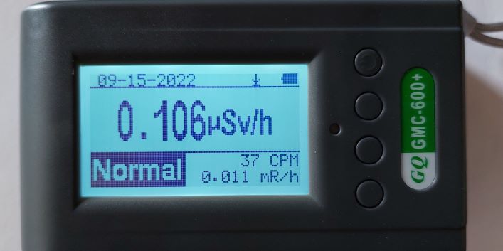

I notice that in the main screen of the geiger display, the data of CMP, mR / h, uSv / h can be read in real time. But not the mean of the chosen unit of measurement (in my case uSv / h).
To see the average I have to change the display screen but I find it only for CMPs and not for uSv / h.
Is there a remedy for this? Or does the gmc 600+ not include this possibility?

Note: it is CPM = Counts Per Minute!
What you are looking for may not be available, but I don't know. However, there is a single factor relationship between CPM and uSv/h:
Your first pic shows "37 CPM" and "0.106 uSv/h". Divide the two 37/0.106 => 349 CPM/(uSv/h). This is the sensitivity of the tube.
Read more in the GeigerLog manual in chapter "Appendix G – Calibration".
LND, the manufacturer of the tube LND 7317, specifies 348 CPM/(uSv/h) for a Co-60 source. Interestingly, GQ so far had used 379, which has no basis in anything, and obviously has changed its firmware. Could you please post what your firmware version is?
From your "Average CPM:45.00" you get avergae uSv/h by: 45 / 348 => 0.129 uSv/h. For a quick view I suggest to multiply by 3 and divide by 1000: 45 * 3 / 1000 = 0.135. Only 5% difference (and you don't know anyway what the sensitivity for your situation).

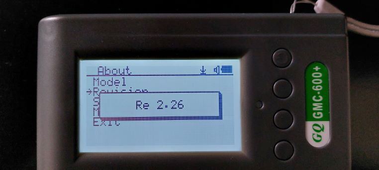

Hi Ullix, having registered on GMC.MAP looking at my personal account, I have traced back to the Firmware version which is 2.26

Thx. I've put a note into GeigerLog.

Hi 1967, currently the firmware does not support the average uSv/h on the text mode screen. For now you can easily calculate it by average cpm / 348.

Hi, I have just received the replacement gmc600 + and I confirm that the ver. is 2.26
