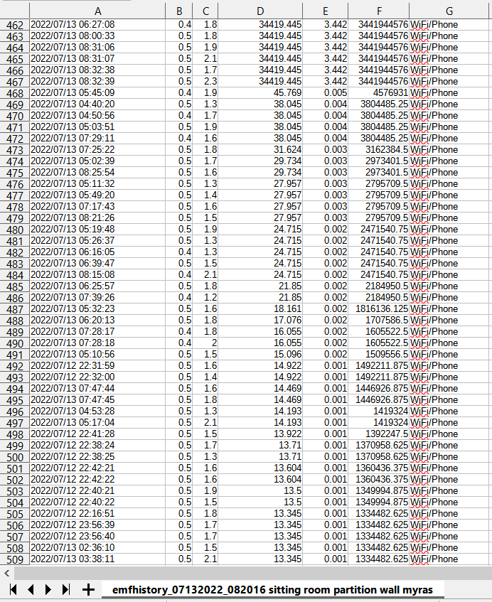

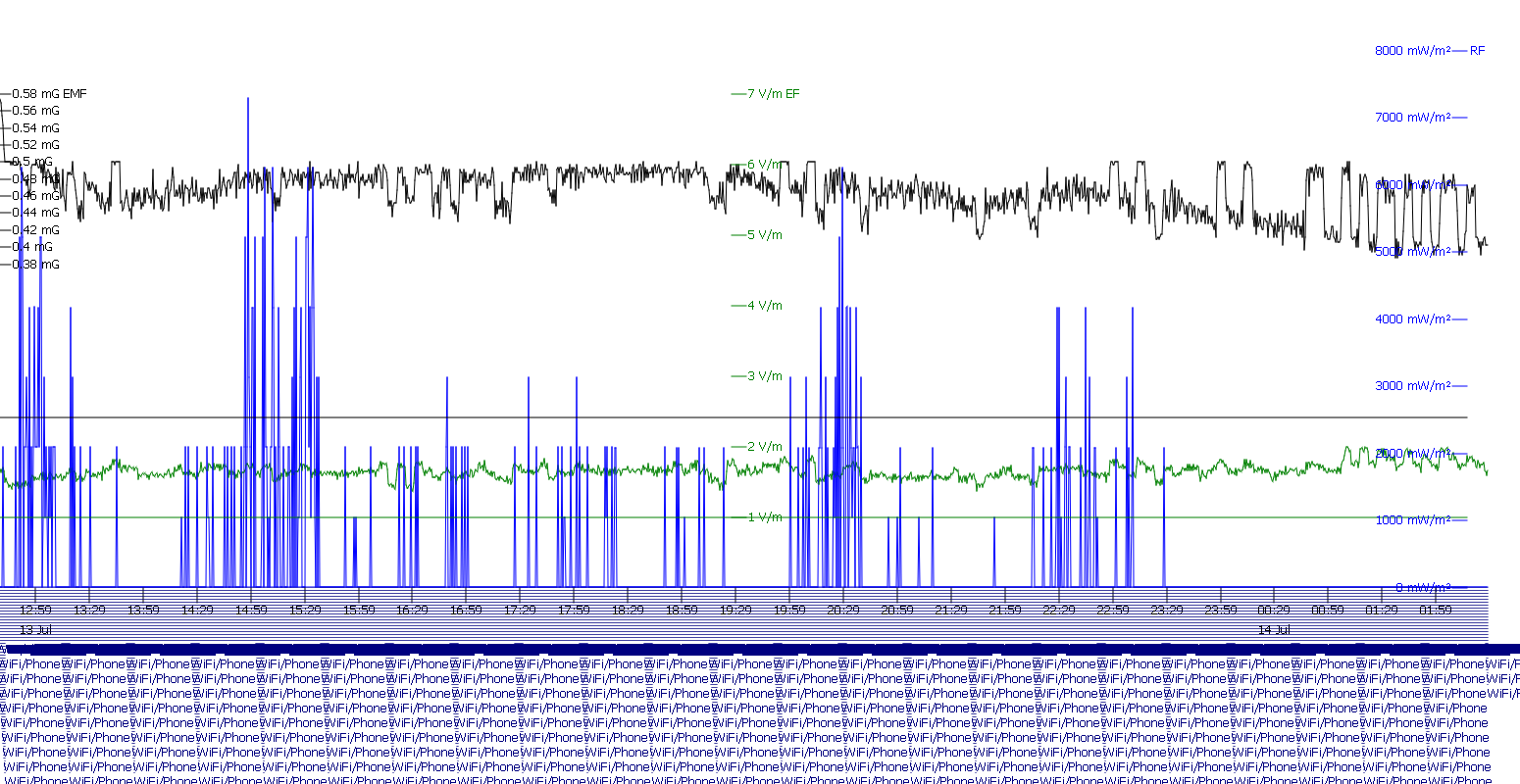

Heres the image file of these, the peaks dont show but i presume this is becaus ethe graph software most likely uses averages over a certain time period and hence doesnt show the 34000 mark , each spkile represents a 34000 reading though .
Here is a snapshot from the excel export showing the end of over 467 readings of 34000 and then to more normal-ish figures. I sorted the readings from high to low in this pic.
Thanks for the help,
K

looks like the reading is maxed out. Do you know if there is a smart meter around?

Yes it is strange as it just jumps to the max reading without ever showing any readings over 1000 mW/m2.
Im not sure what to consider this reading as. Should I think it's hitting 9999mW/m2 (and just giving a reading at max) or should I take the 34000mW/m2 as accurate?
Since it jumps from 45mW/m2 straight to the 34000 mark Im unsure how to consider this.
