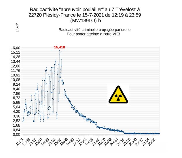

July 15 2021
Maximum measured value 15,418 uSv/h.
This maximum value corresponds to 133,58 mSv/year/inhabitant.
The mean value of the 698 measurements recorded from 12:19 to 23:59 was 3,308 uSv/h which corresponds to
28,86 mSv/year/inhabitant.

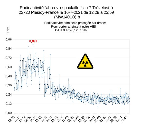

July 16 2021
Maximum measured value 0.897 uSv/h.
This maximum value corresponds to 7,77 mSv/year/inhabitant.
The mean value of the 691 measurements recorded from 12:28 to 23:59 was 0.308 uSv/h which corresponds to
2,67 mSv/year/inhabitant.

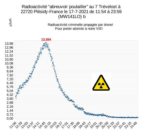

July 17 2021
Maximum measured value 13.884 uSv/h.
This maximum value corresponds to 120,29 mSv/year/inhabitant.
The mean value of the 727 measurements recorded from 11:54 to 23:59 was 4.063 uSv/h which corresponds to
35,20 mSv/year/inhabitant.

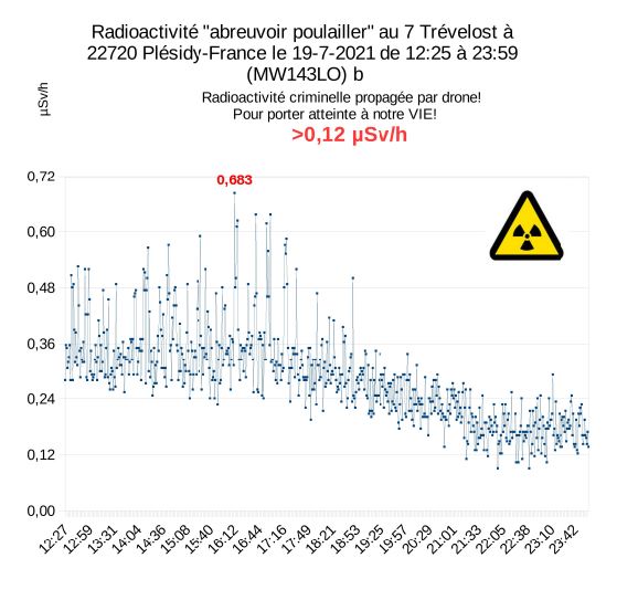

July 19 2021
Maximum measured value 0.683 uSv/h.
This maximum value corresponds to 5,92 mSv/year/inhabitant.
The mean value of the 692 measurements recorded from 12:25 to 23:59 was 0.285 uSv/h which corresponds to
2.47 mSv/year/inhabitant.

your counter tube is sensitive to sunlight, it's a recurring problem with GMC-320 & 500+.
there is no radio activity
you can try removing the back cover of the counter and expose the tube to direct sunlight on a sunny day like today at 14h15 (zenith hour of the sun at your location).
you will explode your record
if you don't feel healthy it's just psychosomatic (due to the fear of not being), nothing serious you just have to forget about it and it will be better.

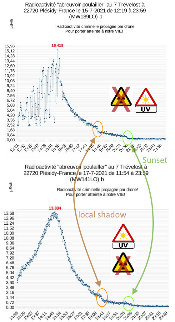

Posted - 07/21/2021 :  23:54:59  Show Profile  Reply with Quote
if you look closely at your graphs, you can clearly see the effect of the sunset or rather shadow of your fencing because the sunset is at 22h05 at your date and location.
we also see on two different graphs another incident which must be a shadow cast by a fairly large object, maybe a house or a building.
even if the meter is not directly exposed to sunlight it can be disruptive. normally it should not be influenced by light at all, but some tubes are not well designed/builded and are easily and strongly disturbed by light even with indirect sun light.
but your graph does not leave any doubt, it is indeed the sunlight you are detecting and no radio activity.
Edited by - Damien68 on 07/22/2021 00:19:53

The GMC 320 is located inside the chicken coop, which is closed due to lack of chickens. The chicken coop has no windows so no sunlight can get in there and the roof is not translucent. So your theory is wrong but you are always playing the devil's advocate. And GQ electronics will certainly be pleased with your negative publicity.
