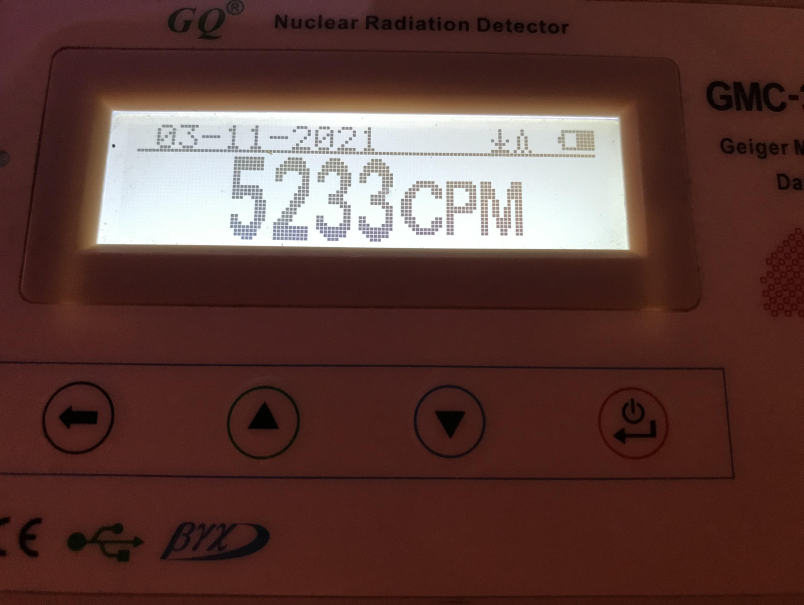

Posted - 01/17/2021 :  13:47:19  Show Profile  Reply with Quote
There is an elaborate post on the topic of light-sensitivity of the M4011 tubes done almost 3 years ago: http://www.gqelectronicsllc.com/forum/topic.asp?TOPIC_ID=4540
But the effect is back! And it brings a new surprise.
Back then the M4011 tubes were made of clear glass. As a consequence, GQ modified the tubes by covering them with a black, plastic-like cover. Presumably assuming that the black cover would absorb all light .....
I had been noticing that my 320 Plus with a clear glass M4011 tube over the last 5 months or so was getting higher background radiation readings. I played around with it, aimed the back of the unit towards the sun and saw readings jump to over 2000. After reading through this post [Thanks ullix !!] I tried to first paint the tube with black acrylic paint, but that stopped all readings, so I removed the paint, put on black electrical tape over the tube and now my readings are back to once they used to be. Odd. Do the other tubes that GQ sells fit into the 320?

Posted - 01/18/2021 :  02:21:01  Show Profile  Reply with Quote
@GreenPhlash: Thanks for posting your observation. Perhaps there are more people realizing that their devices have a light sensitivity problem.
The puzzling thing is that not all tubes, not even clear glass tubes, are light sensitive. I have some, which, to the best of my abilities, I have shown that they are not. And then there are tubes which are, despite having a black coating, as discussed in this present topic.
The problem is not to explain the physical base for light sensitivity. The problem is to explain why this does NOT apply to some tubes. And this is the question which makes it attractive to a physicist ;-)
Re alternative tubes: GQ seems to have moved away from using the M4011 - be it clear glass or blackened - towards tubes from the Jxyz type. Some of those tubes are mechanical and electrical drop-ins. When you have very low cost devices, you are likely to find those tubes, see e.g. my article https://sourceforge.net/projects/geigerlog/files/Articles/GeigerLog-Radiation-v1.1%28CAJOE%29-Support-v1.0.pdf/download
No announcement by GQ, so we can speculate that the move is done just because they are cheaper, not because of technical superiority. As long as the cause for the light sensitivity is not understood there is little hope that just another manufacturer makes a difference.
The Russian SBM20 tubes (and similar ones) have a steel housing, so light should not be an issue. They can be fitted into the GMC housings, but it takes some mechanical and soldering work. Electrically they can be considered drop-in products. But to my knowledge, there is no production of new tubes; you only get old supply from cold-war times. Those are still OK but understandably not a good base for a manufacturer of new devices.
I have used the SBM20 but only with external wiring, like shown here: http://www.gqelectronicsllc.com/forum/topic.asp?TOPIC_ID=4571

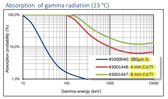

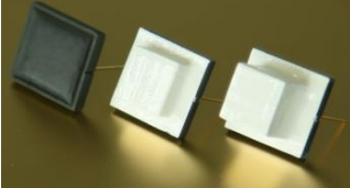

Posted - 01/31/2021 :  02:04:16  Show Profile  Reply with Quote
I can contact Soeks directly and ask.
That would be great!
Flash lamps generate an increase in indications in the Smart Geiger and Smart Geiger Pro semiconductor meters (I used to take photos of smart Geiger and I noticed that).
I am not surprised, I reviewed the Smart Geiger Pro here https://sourceforge.net/projects/geigerlog/files/Articles/GeigerLog-Review%20Smart%20Geiger%20Pro%20%28SGP-001%29-v.1.0.pdf/download
This device is basically a solar cell, meant to convert photons into electrical signals. In my device the insulation against light was a copper foil. If that isn't perfectly tight, you'd see light effects. However, my device did not show any response to light (perhaps a matter of intensity; your photo lights may be stronger?).
The enticing aspect of these devices is that the electric impulse is in principle proportional to the energy of gamma quanta and thus could serve as a spectrometer. Unfortunately, my trials failed completely.

Posted - 02/02/2021 :  00:53:45  Show Profile  Reply with Quote
I delete my previous post by error, sorry for that.
just to call back references:
Sensor is from "First Sensor compagny" is 100 mm2 PIN Photodiode + CsI:Tl scintillator
https://www.first-sensor.com/cms/upload/datasheets/X100-7_THD_3001447_3001448.pdf
distributed by Mouser.
Interesting experimentations of Photodiodes and Scintillator with electronic detection stage basic explainations:
h**p://physicsopenlab.org/2018/07/08/si-pin-photodiode-plus-with-csa-sa/
h**p://physicsopenlab.org/2018/09/23/photodiode-and-csitl-scintillator-with-micod-csa-sa/

Posted - 03/11/2021 :  22:34:05  Show Profile  Reply with Quote
I've been having some anomalous readings with my GMC-300E+ so I did some digging and found this thread.
Out of curiosity shined a very bright headlamp I own into the holes on the back right onto the tube and got this after just a minute or two:
Light sensitivity (SER via LED) is for sure a thing with at least some of these.
Should I try and return the unit or get a new Mueller tube?
I'd like a Radiation detector that doesn't constantly false-alarm.

Posted - 03/12/2021 :  00:46:47  Show Profile  Reply with Quote
Welcome to "Groundhog Day in Light-Sensitivity County"! You may have missed this more recent topic on the matter: http://www.gqelectronicsllc.com/forum/topic.asp?TOPIC_ID=9544?
In this topic EmfDev opinions that the tube is defect and suggests to email support and you will get a "good" tube.
So you did not open the case, but had kept the back cover on, just as EmfDev said is needed for proper operation. Hmm, does not seem to help.
To replace the tube you will have to remove the back cover anyway, so you can do it now. What type of tube do you have: M4011, J305, other, clear glass, blackened glass?
I now have a total of 6 tubes coming from GQ. Of those 3 are light sensitive. That is 50%!
What are the chances of me getting 50% "defective" tubes if that is an exception among thousands (?) of tubes? My guess, if more people check for light sensitivity, we'll get a lot more news on "defective" tubes.

I think the ? at the end broke your link but I found the thread anyway (REST developer FTW). I fixed it in my reply.
I did actually open the case at one point and tried to wipe down the tube - suspecting radioactive particles adhering to it - with a microfiber (lens cleaning) cloth to no avail. I don't have the back cover off at the moment, so I can't tell you the exact model, but the tube is clear glass. Although, from my reading that doesn't seem to matter as it seems some obscured tubes still react to light when they shouldn't.
Unfortunately(?) I ordered and received my unit through amazon so I don't have a GQ order number or anything, but I'll reach out to EmfDev or customer support soon.
Thank you so much for reply so quickly though! I wasn't expecting a response any time soon.
