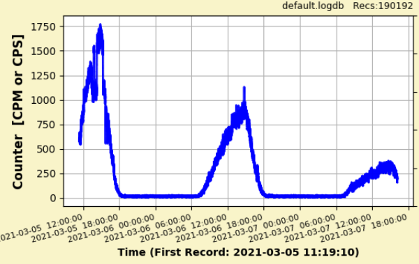

I got a brand new GMC-300E+ and something raised my suspicion. So I took the back off and lay the counter on the edge of my desk, face-down, tube now facing upwards, and let GeigerLog do the recording. This is the result:
Even without any arrows or marks you can easily see the times of sunrise, sunset, and the moments that clouds covered the sun. And the counts easily exceeded the counts I could have created with my whole collection of radioactive samples!
My office has daylight, but certainly no glare. Light is dimmed with curtains to easily allow working at a computer monitor. This is daylight behind windows, so very little UV. I also tried "Black light" of 395nm from LED, and the counts went to CPM well beyond 10000!

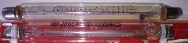

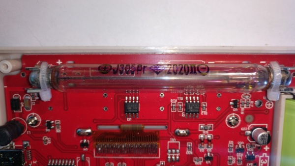

Let's look at the tube:
First surprise: not an M4011, but a J305! Second surprise: not a blackened tube, but again a clear glass one.
Compared to a M4011 the J305 is approx 5 mm shorter. You see in the pics that the tube is forced into the holding clamps with cable ties.

given the thickness of the blue line I would say that the weather must be cloudy in your area in Germany. this gives variations.
given the steep decay after 3pm, I would say you must lose direct sunlight at this time, so your office must be facing southeast

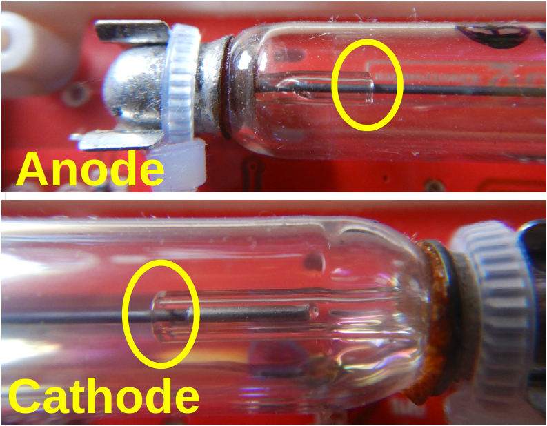

I've got a blue-laser pointer, 405nm, 5mW, which makes an oblong "spot" of some 3x5mm. Not perfect but much more suited than an LED flash light to sample the Geiger tube for light sensitive areas.
So I set the counter speaker to ON, and illuminated the tube spot-by-spot. As a result: no areas are light sensitive, EXCEPT two spots circled in the picture, one on the Anode side, one on the Cathode side. The circles are about the size of the laser spot.

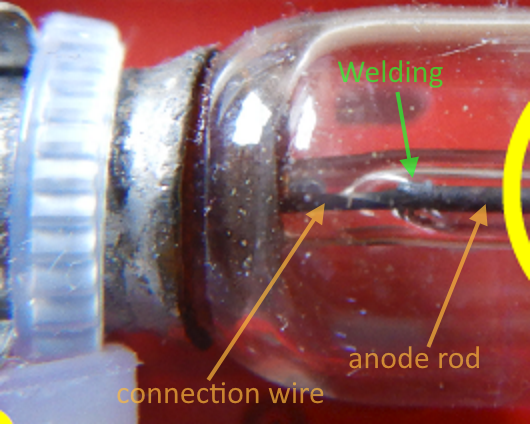

Sensitive is only the immediate area where the anode rod enters into what seems to be a little glass tube, presumably simply the mechanical holder for the anode rod.
The two sides are differently sensitive: the cathode end generates some 100 CPS, but the anode end easily generates CPS=1500, i.e. CPM=90000!
But even with a 20x magnifying lens can I see any difference between the two ends, nor anything else noteworthy. No metallic smear, no rainbow colors, nothing. Does anyone see more?

90k CPM is very high,
maybe the glass insulators are not made with the same glass quality as the tube?
or can be sensitif components for welding but it seam to be autogenous one, but not sure it's a little gray
