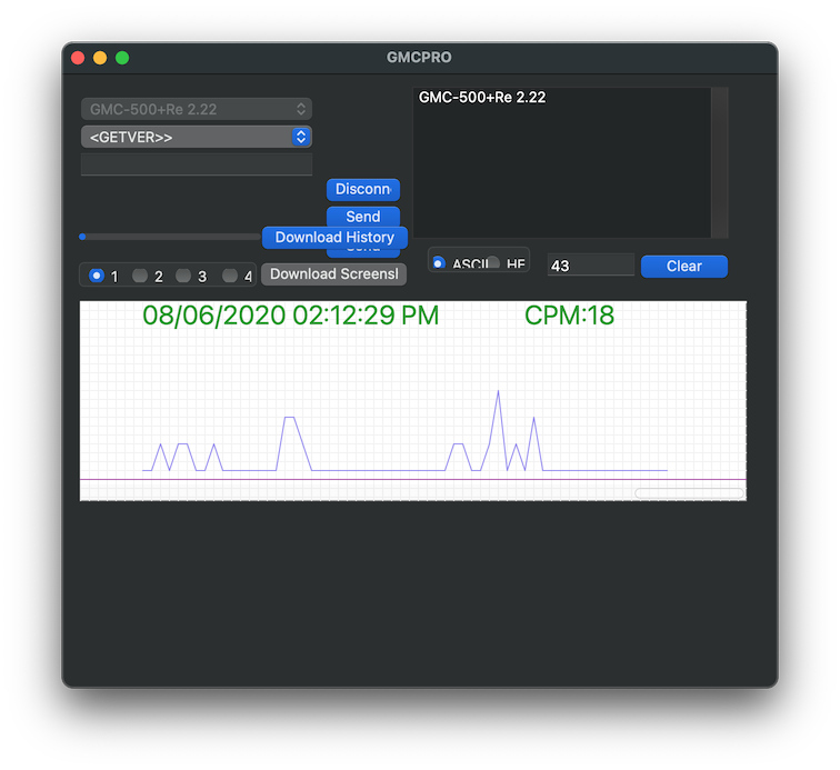

Got it working on macOS 11.0 beta 4, but the app is of early alpha quality and the developer obviously has no Mac available to test this on.

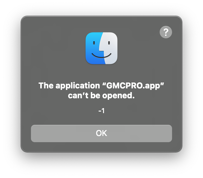

First of all, if you start the app and get an error code -1 that's because the zip archive is missing the correct UNIX permissions, in this case the execute bit. So first thing you should do is a
chmod a+x GMCPRO.app/Contents/MacOS/GMCPRO
The CH34x installer will quit with an error but apparently the driver will be installed anyway, this might be an issue with the Big Sur beta, if I have the time I may test it on 10.15.
After a reboot you will be greeted with something similar to this:
For some unknown reason the CPM counter needs a minute or so to be in sync with the actual value but will be correct after that.

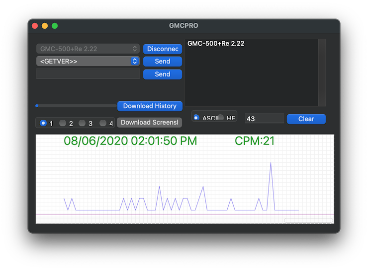

Quite a few UI elements are lacking constraints, so after resizing the UI may look like this
My first impression: Typical result of a cross-platform framework (in this case Xojo) that promises to pull a working app out of the hat but in reality fails. There is still work to be done, despite what any cross-platform framework may promise.

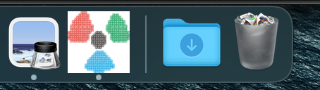

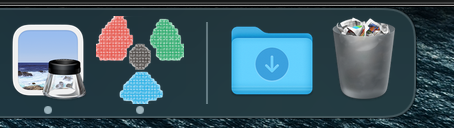

App icon is missing alpha channel.
Without alpha:
Looks much better with alpha:

Doesn’t work...GMCPRO can’t be opened...
mojo66
32 Posts
Posted - 08/12/2020 :  11:18:27  Show Profile  Reply with Quote
I explained how to fix this in reply #17
