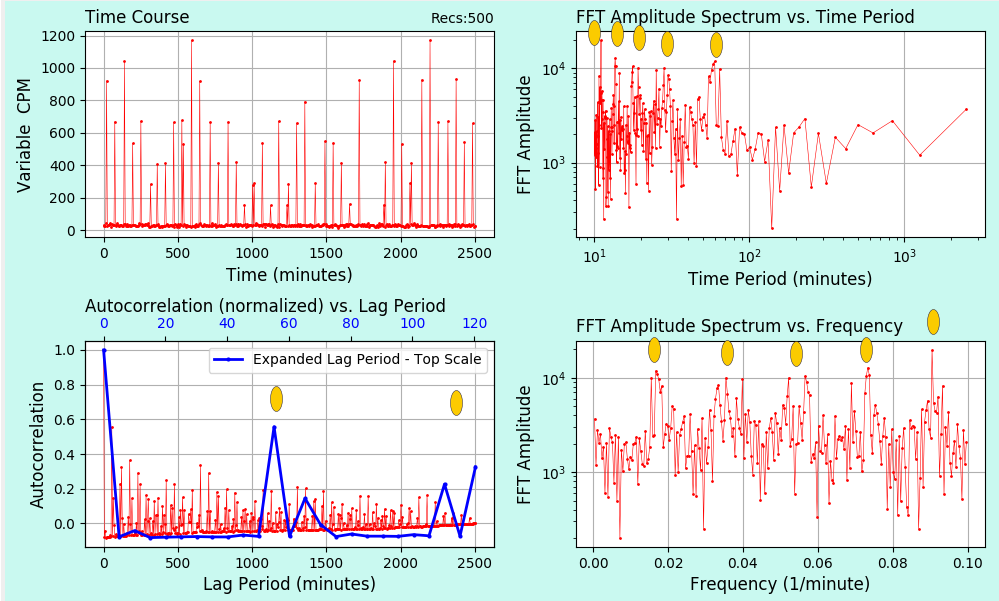

Indeed, the first look confirms that something is awfully wrong with the data!
I was curious whether the underlying background (was it background or some source?) data were proper, just overlaid with the spikes, or whether the background data themselves indicate a deeper problem.
Fortunately, the map website allows downloading the data in CSV format, so I downloaded "this page" - about 42h worth of data - fed it to GeigerLog, and pressed the FFT button. Result is in next picture.
152983 bytes
The top left figure shows the usual Time Course of CPM over time. The spikes are obvious, as is their regularity. Thus doing an FFT and Autocorrelation is appropriate.
The bottom left figure shows the autocorrelation (BLUE scale!), and the peaks at 1 and 2h are designated with golden "Easter eggs" markers. Similarly, the right side shows the FFT amplitudes over time (top), and over frequency (bottom). The markers show the 1h basic period, plus the harmonics.
The spikes occur regularly at close to 1h intervals.

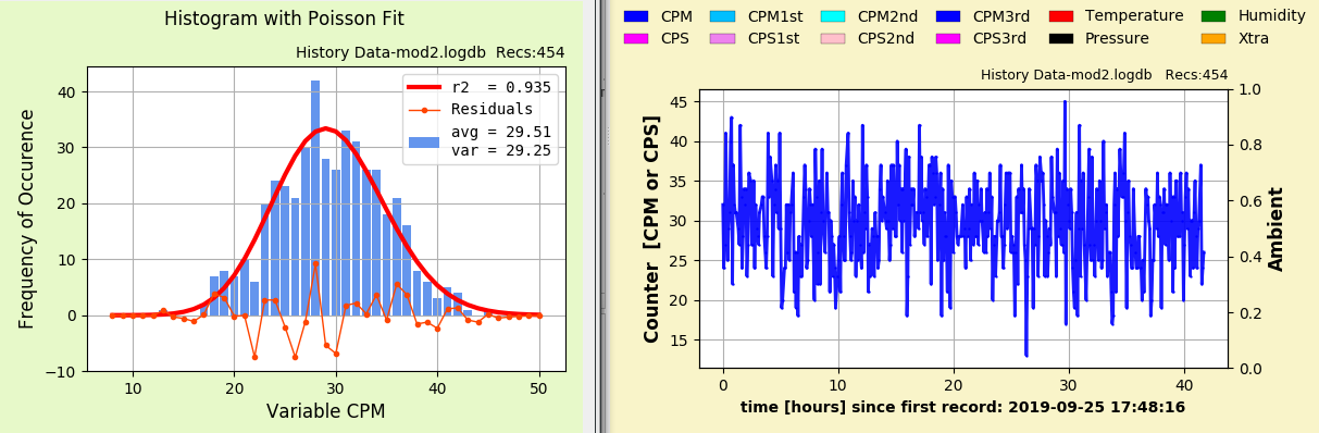

Next step was to remove the spikes, and reanalyze the presumed background data. The open source SQL database browser "DB Browser for SQLite" (my recommendation, see GeigerLog manual for details) does a wonderful job in analyzing a file like GL's *logdb files.
The background data reach a max of 45, then comes a jump to spikes from 152 to 1170 CPM. I deleted all spikes and reloaded the cleaned db file into GeigerLog. Result in next picture, together with a Poisson-Test image.
104601 bytes
The average of 29.5 CPM may be a bit on the high side when I compare this to my data, though it may be expected in your area. Is that so or is it high for you too?
Otherwise, there is nothing to complain about the data. The Poisson curve (thick red line) give a good fit, r² is reasonable at 0.935, and an average of 29.51 is in almost perfect identity to the variance of 29.25. And lastly, the residuals (thin red curve at the bottom, data minus Fit) jitter across the zero line with no discernible patter.
So, the background data look good. very good actually, except that they may be high.
My first expectation was a hardware defect of the counter, but now I am wondering, whether external effects played a role: air-conditioner? machinery? mobile-phone access?
