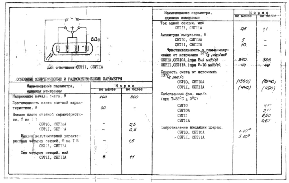

Don't worry too much about the differences SBT11 to SBT11A. Here is a datasheet:
233863 bytes
The only difference is in the 2nd before last paragraph, and perhaps someone can decipher it?
Even if the 2.50 vs 0.67 (that is what I read) were the thickness of the Mica window, and hence would suggest a different sensitivity to alphas and low energy betas, it has almost no relevance for the things you might do with a Geiger counter for the following reasons:
There is no pure alpha emitter. All of them represent one isotope within a decay chain, and this decay chain then has beta and gamma emitters. You will always be able to detect such a substance based on latter emitters even with M4011 tubes. Discriminating between them is an not-so-easy job. You need to make sufficiently long term successive measurements with blocking for alpha and perhaps even beta, without touching the geometry in the slightest. I believe only GeigerLog could handle such experiments; testing for Poisson will be an important part of it!
Should you ever succeed in one, please present it!
P.S. By the way, you see in the diagram that the SBT11(A) consists of 4 tubes connected in parallel. This brings back the idea that a Geiger counter could be constructed to cover a range of sensitivity by using only 1, 2, 3, 4 or even more tubes. This can already be done with with any SBT11(A) or with a set of SBT10 or SBT21 tubes. Any of the many high voltage NPN or MOSFET transistors could act as a switch within the HV lines. And all could work from a single HV source.

@ullix, The second to last paragraph talks about random pulses from device itself. Russian says 'Own source pulse' The sensitivity to Cs-137 source is in para above that. It is in CPS and shows 440CPS for 11 and 490CPS for 11A. Above that it specifically talks about sensitivity to gamma radiation and is in CPM, with 11 at 44CPM and 11A at 49CPM. Relative sensitivity to either total field of some amount of CS-137 or for just gamma radiation is that the 11A is 11% more sensitive (or ~10% as EmfDef notes above).

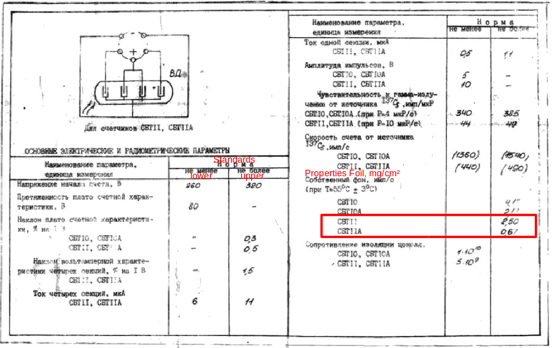

As apparently none of the forum readers is speaking Russian, I fumbled my way through some of the SBT11(A) specs using this side for conversion help: https://en.bab.la/dictionary/russian-english/%D0%BD%D0%BE%D1%80%D0%BC%D0%B0 and annotated the spec-sheet with my discoveries:
362809 bytes
As is to be expected for spec sheets, the narrow columns contain the lower and upper limits for the properties described in the left column.
Whenever you see "SBT11, SBT11A" separated by a comma and on the same line, the specs given in the two standards column are the lower and upper limits applicable to both tubes. You see that the two tubes are identical in all aspects but one.
This one difference is in the topic literally translated as "Properties Foil". I'd say this is the thickness of the window material (perhaps "Mica" window) given as areal density mg/cm². For other tubes this is typically around 2 mg/cm², so a number of 2.5 for a SBT11 makes sense. The number of 0.67mg/cm² for the SBT11A tube means it is VERY thin! For some perspective: when tubes are additionally offered as "military-grade" their thickness is 3...5mg/cm² instead of 2!
So, when you got an SBT11 (non-A) tube, consider yourself lucky, as you didn't get such a fragile tube as the SBT11A!
The GQ decision to put SBT11 tubes, and not the A-version, into their consumer products is a very reasonable one! I question whether there is even a need to offer a windowed tube. It does allow for marketing claims (perhaps a good enough reason for a company trying to sell products) but I still have not seen anyone demonstrating a measurement of an alpha signal, or a very-low-energy beta signal. Anyone able to show it?

@ullix, I responded with correct translations of a number of sections in #7 above. Your 2nd to last paragraph is tube generated noise pulses in cps, and not mica window thickness.

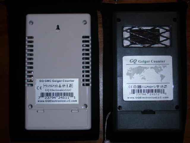

@ullix, the 600 is a mica windowed alpha tube like the 7317. There is a grated cutout on the bottom of the case for both the 7317 and the SNT-11/11A. Judicious use of a different GQ label to cover the opening not needed leaves the other open for tube to receive alphas. I still like the idea of a clip on steel beta shield that covers the bottom of the meter and both opening positions.
Stargazer 40
Stargazer 40
431 Posts
Posted - 12/02/2018 :  04:01:30  Show Profile  Reply with Quote
@ullix, the 600 is a mica windowed alpha tube like the 7317. There is a grated cutout on the bottom of the case for both the 7317 and the SBT-11/11A. Judicious use of a different GQ label to cover the opening not needed leaves the other open for tube to receive alphas. I still like the idea of a clip on steel beta shield that covers the bottom of the meter and both opening positions.

Reply #28
PKIDelirium
14 Posts
Posted - 09/14/2019 :  07:07:53  Show Profile  Reply with Quote
Like the back “door” on the RadiaScan? 8:33 in the video: https://youtu.be/T1HZ8NAXu64
