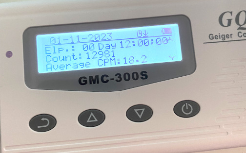

My counter is computing 12981 counts in 12 hours as "18.2" CPM when it's supposed to read 18.03 CPM, rounding to the hundredths place.
12981 / (12 * 60) = 18.02917 ...
I think it somehow dropped the tenths place because it's a zero, and didn't factor in the thousandths place (although to be fair the difference is negligible).
Is this a known bug? It usually gives correct CPM estimates from the duration and number of counts (aside from not considering the thousandths place when rounding).

Posted - 01/12/2023 :  00:10:01  Show Profile  Reply with Quote
Strange, indeed.
I tried it the other way: producing 12981 counts with CPM=18.2 would take 405.5 sec or 6.76 min LESS than 12h. That is a lot.
In this case it does not matter much, but it makes you wonder where else the calculation is done incorrectly ...
Posted - 01/12/2023 :  04:56:19  Show Profile  Reply with Quote
I already saw a bug like that somewhere I don't remember where, it was a bug when displaying:
maybe it should display:
- the integer part: 18 is OK
- followed by a dot '.' is OK
- followed by the fractional part 02 displayed as an integer i.e. like a 2 . is NOK.
I think it looks like :)
Edited by - Damien68 on 01/12/2023 05:04:49
Posted - 01/12/2023 :  15:02:53  Show Profile  Reply with Quote
Hi SnailsAttack, yes it may be a bug, I will send it to our devs so they can check it.

Posted - 01/12/2023 :  17:09:42  Show Profile  Reply with Quote
Yes. It's not a big error in this case, but it has the potential to be, particularly for low CPM measurements that happen to have a large number in the hundredths place (e.g. 10.09 CPM misread as 10.90).
Okay. Thank you.

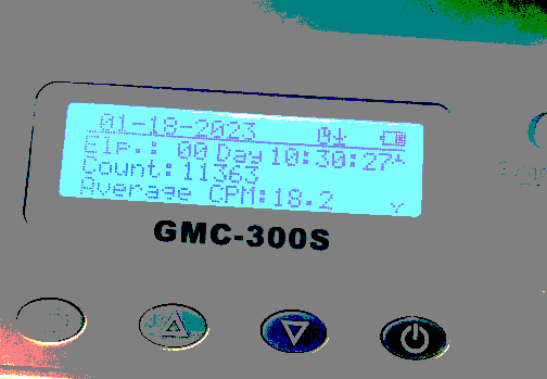

Posted - 01/19/2023 :  06:33:44  Show Profile  Reply with Quote
Here's another instance of the bug occurring.

Posted - 01/26/2023 :  17:48:34  Show Profile  Reply with Quote
Damien68 is right and has appeared before in the forum. Not sure if it was from 500/600+ but I thought this bug was fixed on all devices but actually not for 300/320 series. Now it has been fixed and will be released in the next firmware update together with alarm volume addition.
