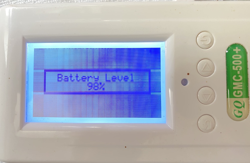

I have accidentally put the battery in reverse on my GMC 500+ and now the device is stuck at "Battery Level":
I have beeped all diodes and they are fine. What can I do to fix this problem?

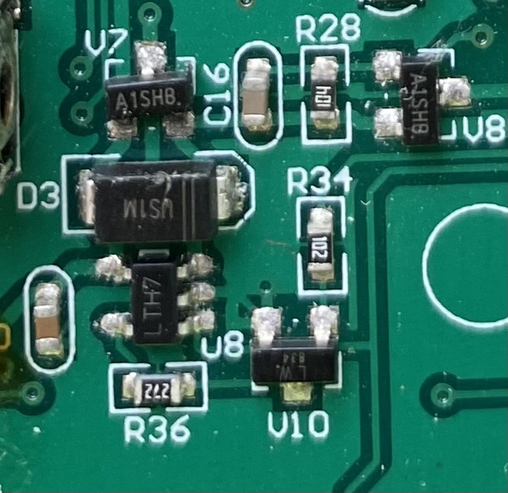

V7 is a P-MOSFET. In-circuit it measured a short in both directions between source and drain so I de-soldered it. Out of circuit it measured 0.55/1.9V.
It didn't change anything though In the end the MOSFETs are just latches, correct? Shouldn't I be able to bridge a connection so I can at least use the device with either the battery or the USB?

I have replaced V7, and all MOSFET and diodes check out now. The only IC in the power management section that I can't check is the LTH7 Li-Ion charging controller (U8). Once the new part arrives I will update this post.
I have also verified that LTH7 is indeed configured in reverse polarity protection and thus have removed my snarky comment. Apologies.

I have replaced U8 without any change. The only part I haven't replaced is V10 because I can't find "LW 834". It doesn't have a short, so I assume it is ok.
I'm out of ideas now and have sent you an email. Thanks.

I assume the problem is that the unit can not be off without USB cable and stay on battery level screen.

Well you say the voltages I measured at U6 are correct but the device still is in the state depicted at posting #1, which means something else must not be working correctly. Could it be the CPU?

Try to remove the USB, keep the battery in #1 state. Then please check the V7 V8 and others in reply #18

Good news, I fixed it by long-pressing the power button!
In battery-only mode the device is now working normally again.

The probable reason is that during all the micro-soldering, I accidentally ripped R36 off the PCB including one of its soldering pads (the one in the opposite direction of V10), so right now R36 is missing.

R36 is used by U8 to set the battery recharge current. if R36 is missing it is normal that the battery does not recharge. if you still have the resistor, you can reassemble it and replace the missing pad with a very thin copper wire without insulation connected between the missing pad and the pad 5 of U8. if you no longer have the resistor, you can replace it with a 2k7/0603 resistor (0603 is the package type), or replace it with a traditional 2k7 resistor with pins (smallest possible resistor 1/16W or smaller) and connect one pin to pad 5 of U8 and the other pin to pad 3 of V10 (follow the traces on the PCB)
you can also leave everything as it is, it won't recharge the battery but it's safe.

Thank you Damien68, the original R36 is gone for good. I tried to replace it with a 3k3 which is the closest I could find in my fundus and a bodge wire to U8 but this resulted in a weird crackling noise from the speaker and display flicker. That's why I left it unpopulated for now.

R36 is 1.5kOhms and without it, the battery will not charge. The backlight and speaker directly get power from battery. If battery is low, theyre going to be affected. You can try to use the 3k3 and wait for few minutes/hours to charge the battery. It may stop the flickering. It will take longer to charge the battery.

You can try to put 2 in parallel stacked together to lower resistance.

R36 is 1.5kOhms
I shot this image before I started working on the PCB. R36 is clearly marked "272"!
Also I don't think the difference between 152, 272 and 332 should matter much in this case, definitely not result in noise and flicker. I think something else is still wrong. Wouldn't be surprised if the replacement parts I got from eBay are to blame.
