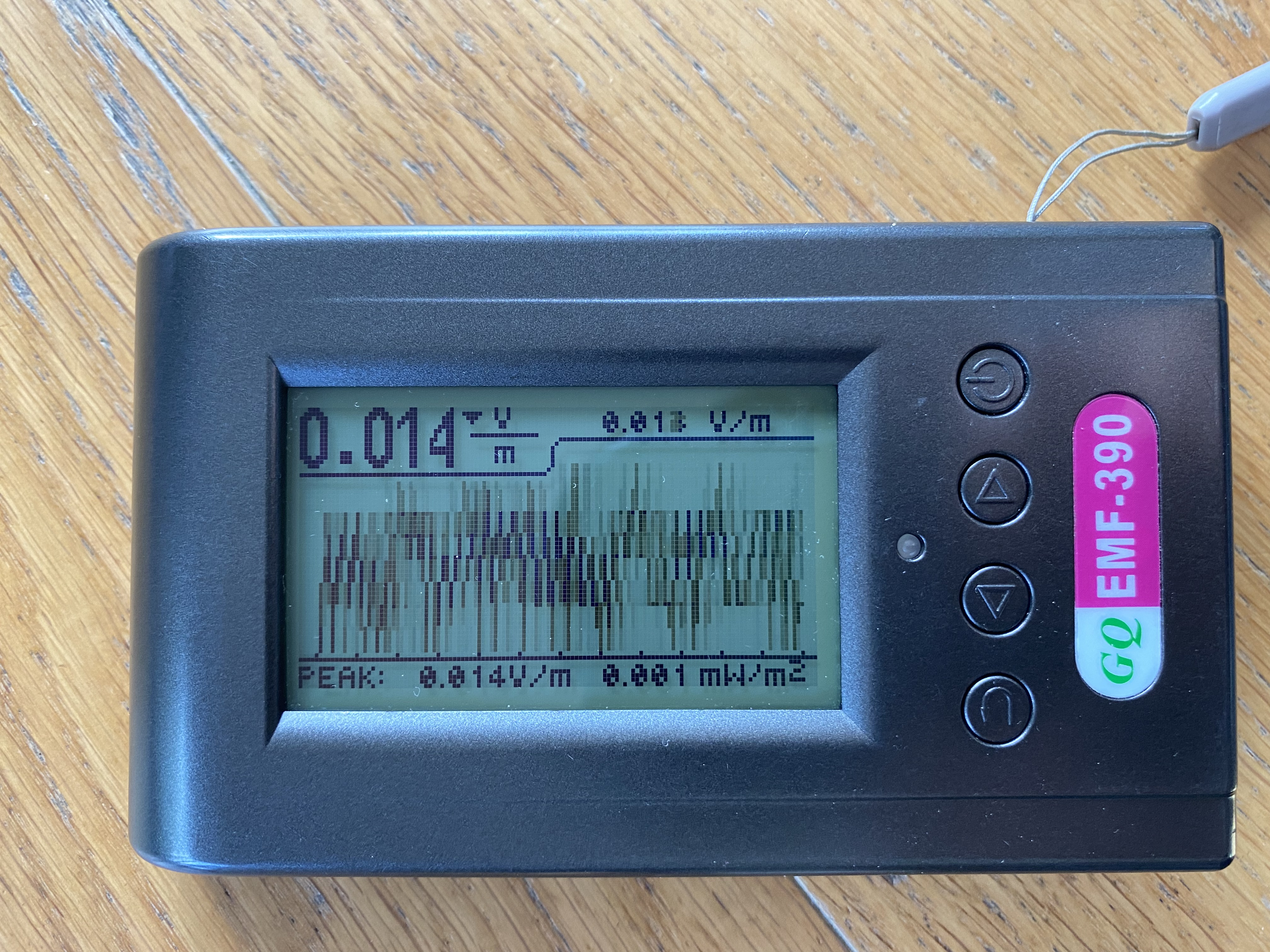

Hello,

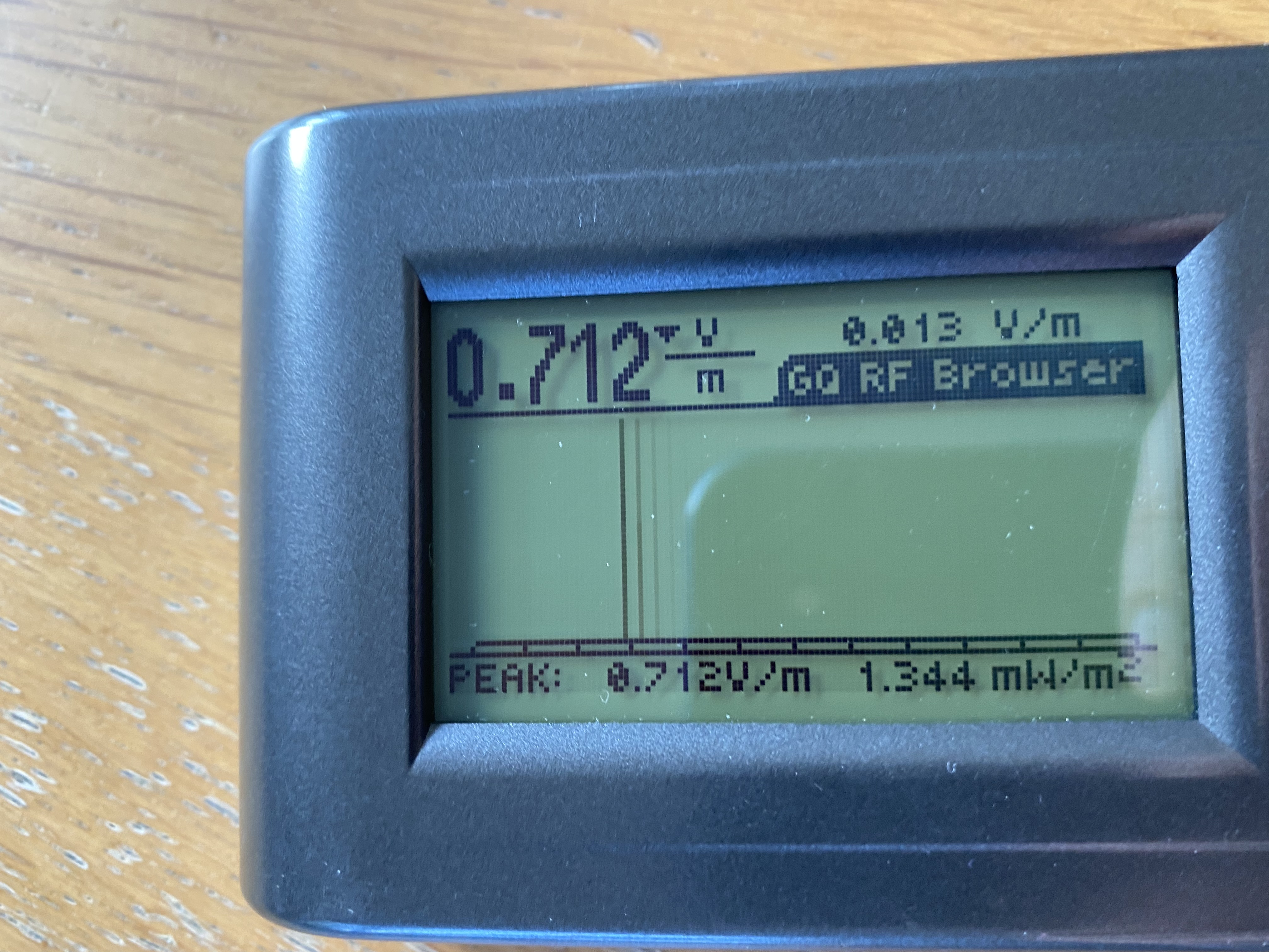

I’ve used my meter for a year or so and something is happening now in RF browser mode that was not there before. Normally when the meter does not detect anything, it stays at 0.014V/m and the lines are flat on the screen. For a couple of days now, it’s been behaving entirely differently with constant lines appearing on the screen at 0.014V/m (see first picture). I did two factory resets already but the issue remains. Normally these lines appear when there is much higher RF in but here it’s constant. And when there is a peak the constant lines disappear only to show the peak lines (second pic). I checked my settings but for me they are the ones I have always used.

Hi Jo, it may have been due to the settings RF Browser Scale was set to Auto. Check it and set it to Normal.
