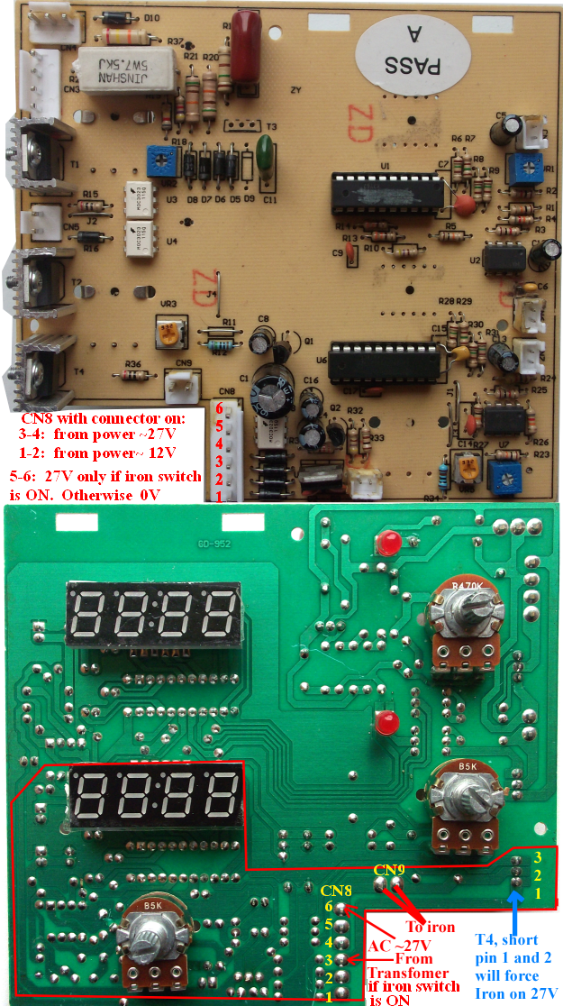

Hello ZLM,
The user dvcvall refers to GA 5200 Rework Station, he probably meant GQ 5200. But in any event, the pots you refer to cannot be found on my GQ 5200. Could you please post a picture of both VR that need to be used to adjust temperature?
My unit needs calibration (temperature is off by at least 25 degrees) and I would like to perform the adjustment, but I tried VR's as close as I could find to your description and they have no effect on the readout, especially the iron temp.
Tks
Raymond
Posted - 05/18/2016 :  07:15:40  Show Profile  Reply with Quote
I do not have a complete schematic, so I am not able to tell you the exact part. After I checked the board. I think there are two variable resistors should control the gain. Those variables are located on the right-bottom of the PCB and close to U7.
See:
1699230 bytes
