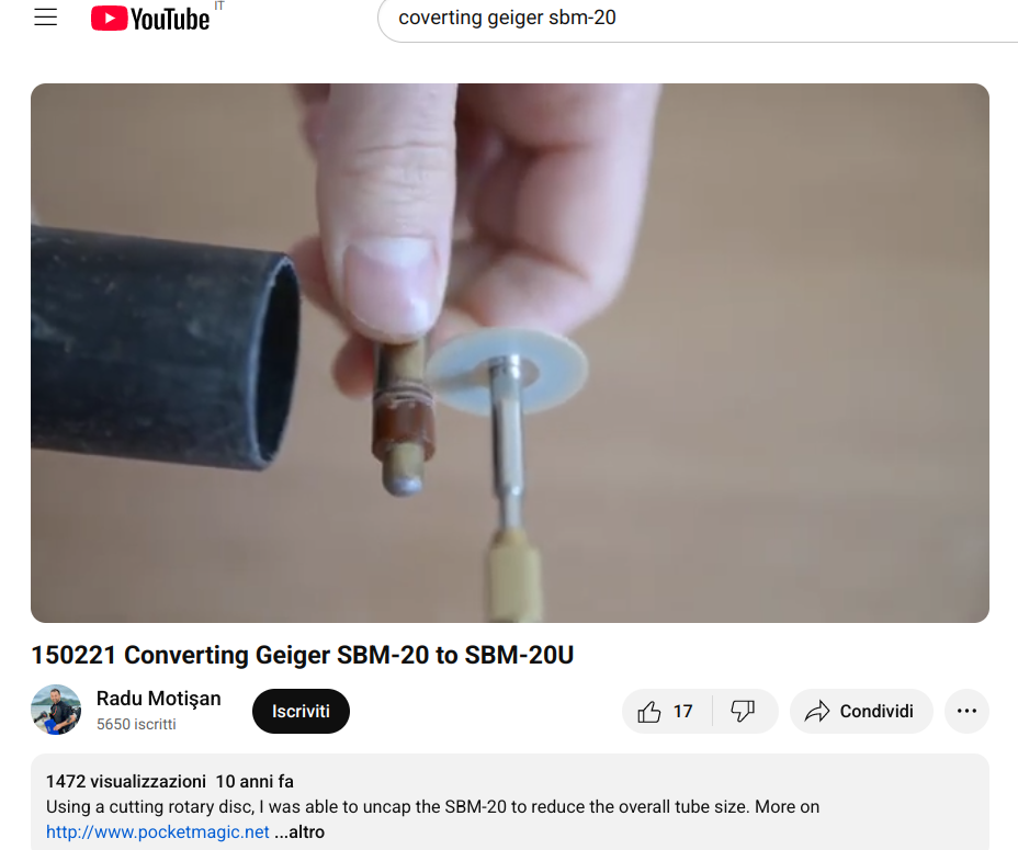

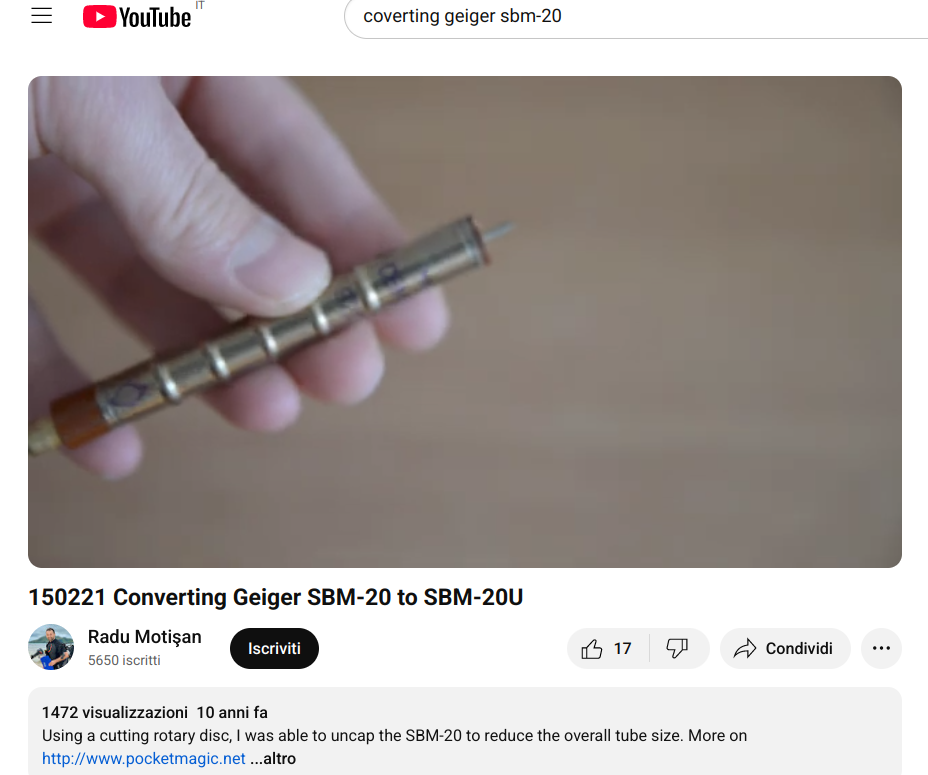

thanks I take note of itI will try to install a SBM-20 on GMC 800...I saw this video on youtube to shorten the tube and insert it into the 800

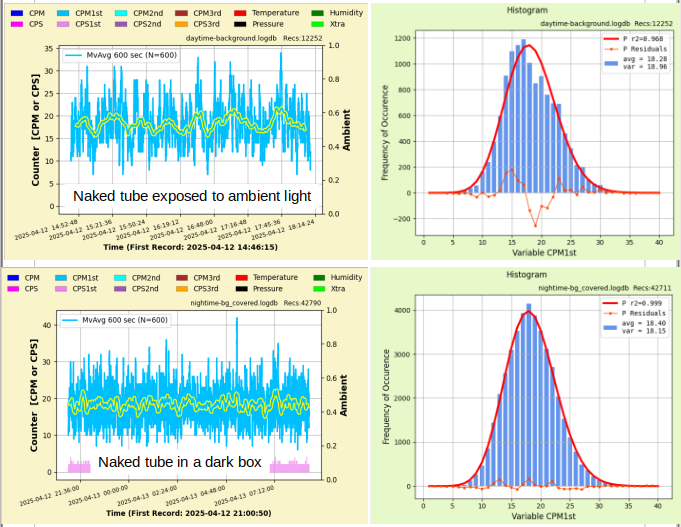

You can easily test whether your setup is suited to the task: Run the GMC counter at GeigerLog to collect a good chunk of data (like overnight). Then click the Poisson button of GeigerLog, and you will immediately see whether anything is distorted or proper.

GeigerLog includes some tools for Quality Checking of your recordings. The most important one is the "Poisson Test". To my knowledge, this is not available anywhere else.
The count events of any random counts over time, being cars on an intersection, customers in an icecreak parlor, whales in a bay, or Counts of a Geiger counter follow a Poisson distribution. And if they don't, something is wrong. More on Poisson in both the manual and the Potty Training.
As an example a recording of mine from yesterday.
The upper left picture shows the time course of CPM from a GMC-300 counter. The backside was removed, and the "naked" tube was exposed to ambient light. The yellowish line is a Moving Average. You can probably already tell when the sun was shining brightly, and when the sky was cloud covered. (Yes, all glass tubes are light sensitive!).
The upper right picture shows the resulting Poisson curve. Clearly distorted!
The bottom two pictures show the very same setup, but now the counter is sitting in a dark box; no light is reaching it. And the Poisson curve is near perfect!
Similar distortions can be observed when the electric pulses resulting from a count are quenched due to improper wiring of anode wires and anode resistor. The time course will NOT show it; but Poisson will!

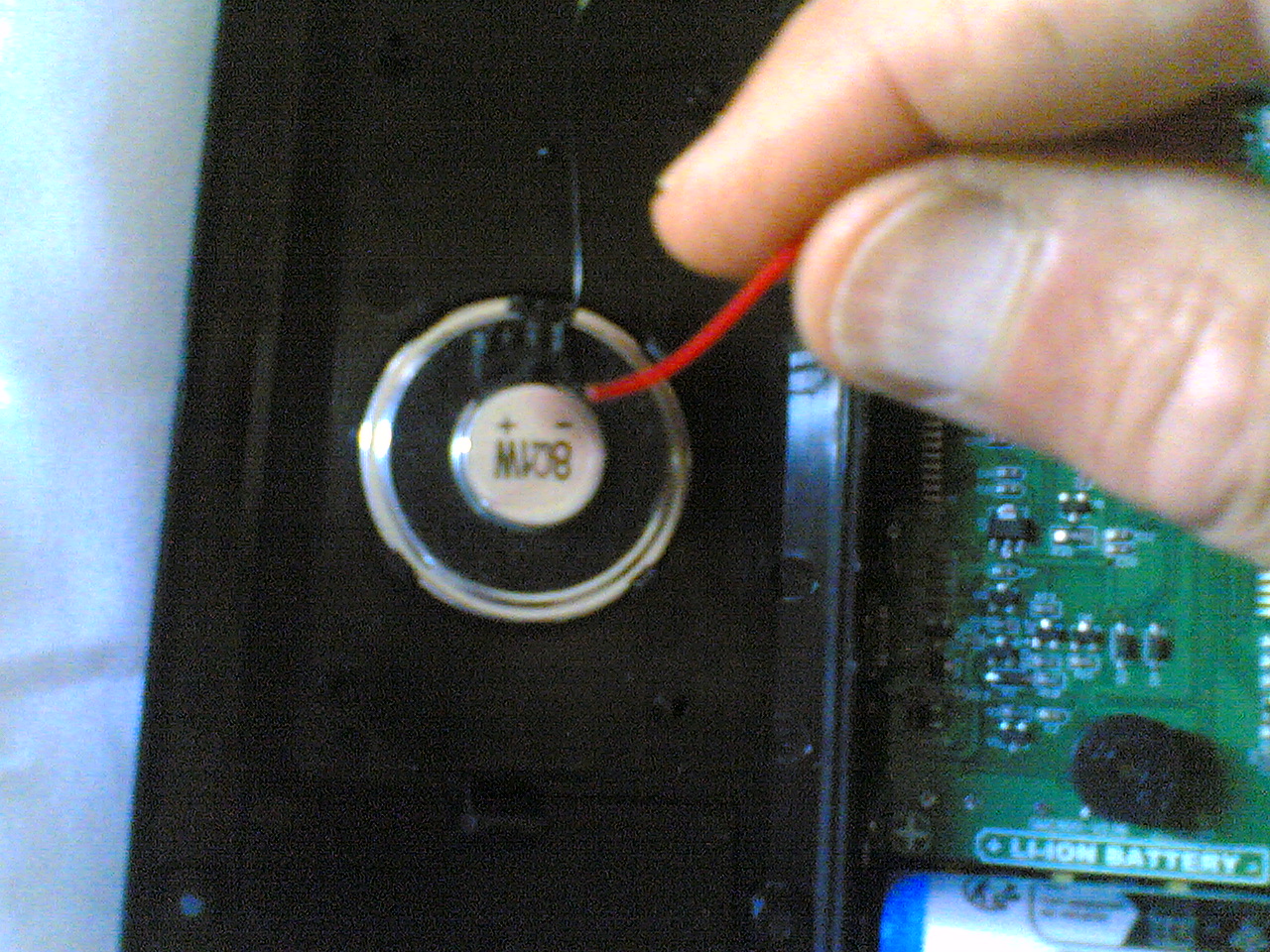

oops Hi, the positive wire of the GMC-800 speaker came off. I actually noticed that the small wires seem hardened, not soft, and this wire came off, so is there a way to solder it, I mean with tin or what?
