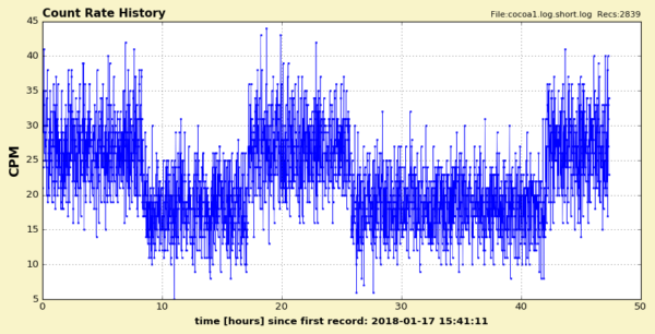

If you are not prepared for those long counter-sitting periods, maybe you can put the bar a bit lower: cocoa powder, as you can buy it from the supermarket, has even 4 times higher potassium than bananas (15.2 g/kg). My counter gave this result for switching between background and intimate contact between counter and cocoa powder:
But note the time scale: be patient when the count rate is low! And always verify proper Poisson statistics for your work to be valid, see article.
