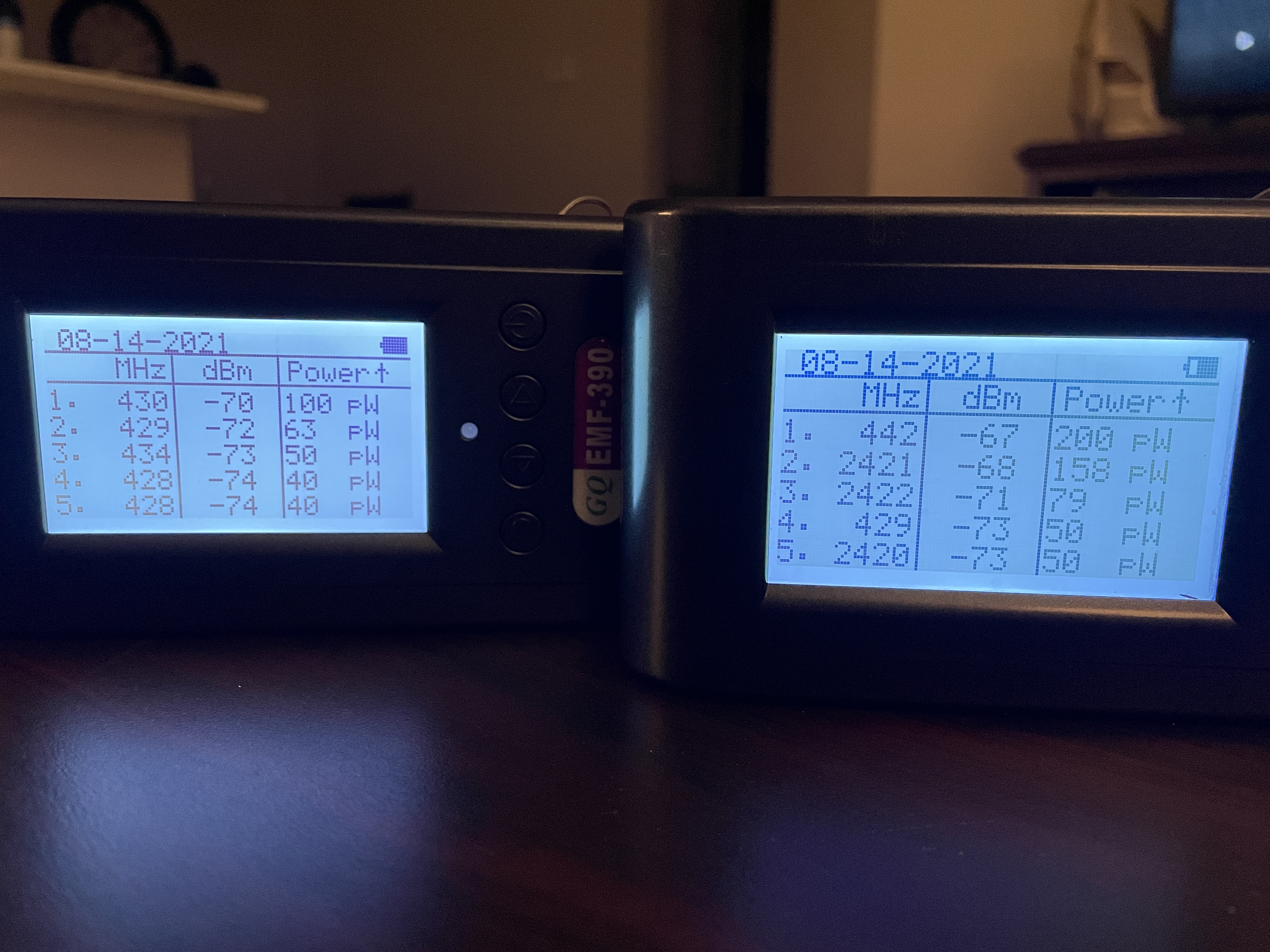

The differential is seen across the board. EF is about 20-40 v/m, the EMF is only around 1 mG, but the RF is anywhere between 10-100 mw/m2. If the hardware was changed in the newer model, that would probably be the reason why for the different RF readings.
The other thing affected is the Table mode in RF. The frequencies are significantly different, and it looks as if the sensitivity has also been tweaked. Added a side-by-side comparison image so you can see the discrepancies.

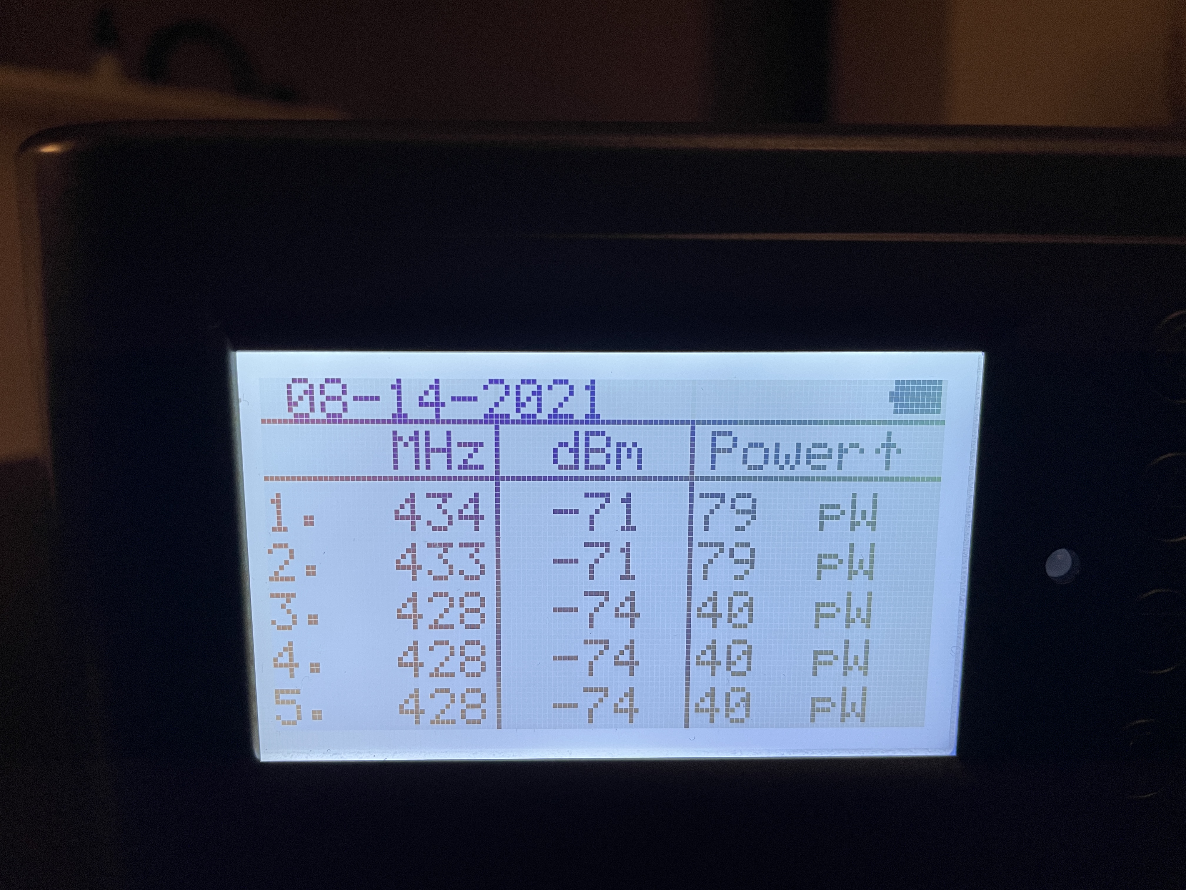

There are also multiple instances of the same frequency showing up in the ver. 3.69 table. Up to as many as 3.
Further, in the Spectrum Analyzer 387-434 MHz section, there is no drill down / zoom capability, although is is possible in the other frequency ranges. Is that a bug or by design?
2355 Posts
Posted - 08/16/2021 :  11:47:42  Show Profile  Reply with Quote
The duplicate is probably a bug and will try to fix it in the next firmware update.
For the 387-434 not having a zoom in function, looks like it was also supposed to not have a zoom function. But we will see if we can also implement it to that band.
