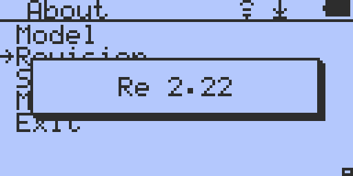

Posted - 03/16/2021 :  10:07:19  Show Profile  Reply with Quote
Hi Oldtron, which revision of 600+ do you have? It takes at least 1 minute to get a good reading unless you have the Fast Estimate feature it will estimate the CPM faster than 1 minute.
Oldtron
22 Posts
Posted - 03/16/2021 :  18:49:14  Show Profile  Reply with Quote
Sir EmfDev,
Revision 2.22
Repeated the experiment today: Same results…
Today’s Source: h**p://www.aladdin-us.com/product/R150# (Because I have an Aladdin Oil Lamp), I have 3 old broken mantles, so with only 1 mantle still in it’s cardboard box (0.38mm - 1/64” thick), right at 25.5cm - 10” in front of the GM tube opening.
As the count rolls up over 0.999µSv/h, the screen freezes, approximately 2 sec. then WDT (watchdog timer) resets microcontroller.
Fast Estimate was set to Dynamic.
Dead time set at 270µS, Enabled or Disabled still crashes.
