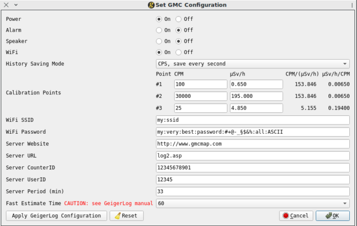

1247 Posts
Posted - 01/11/2021 :  01:41:49  Show Profile  Reply with Quote
@_Aidrini: How desperate are your re your WiFi connection? The next release of GeigerLog will allow some comfortable editing of the GMC configuration, see pic.
I am looking for someone to give it a test run. If you are interested, I could do a pre-release - so far works for the 500+, may need some more tuning for other devices.
I am developing and running GeigerLog on Ubuntu, but as it is based on Python it will run on Windows, Mac, ...
