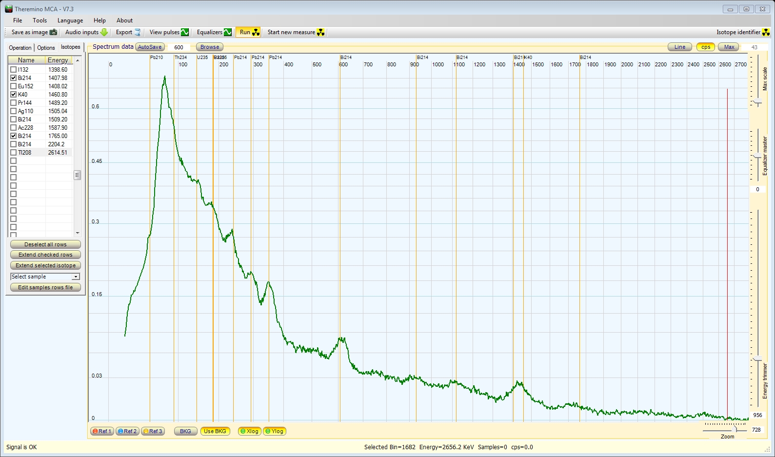

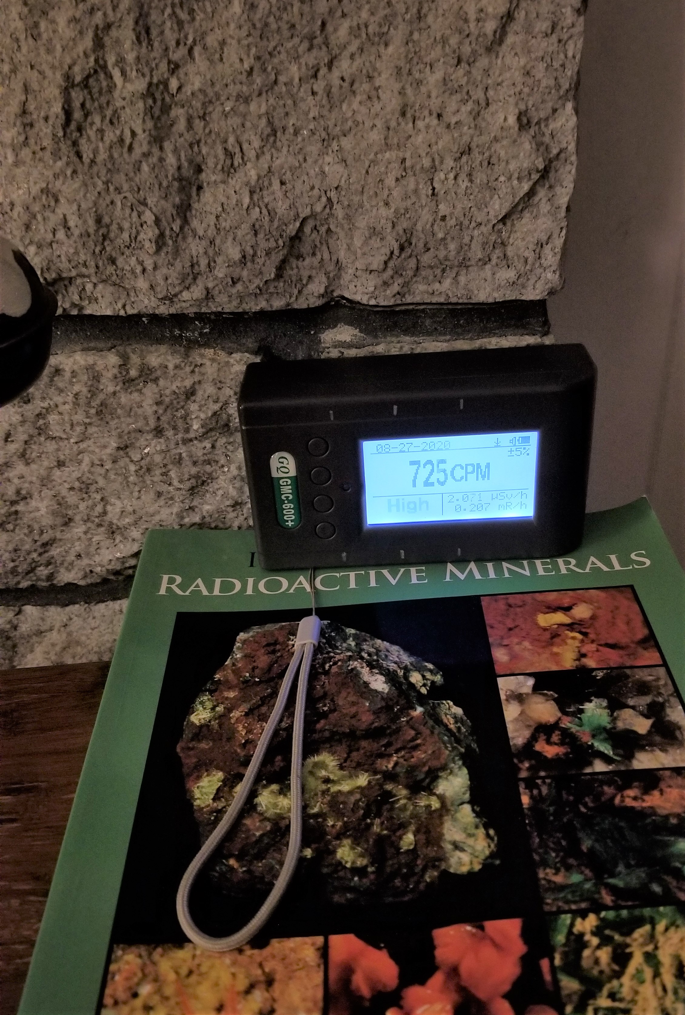

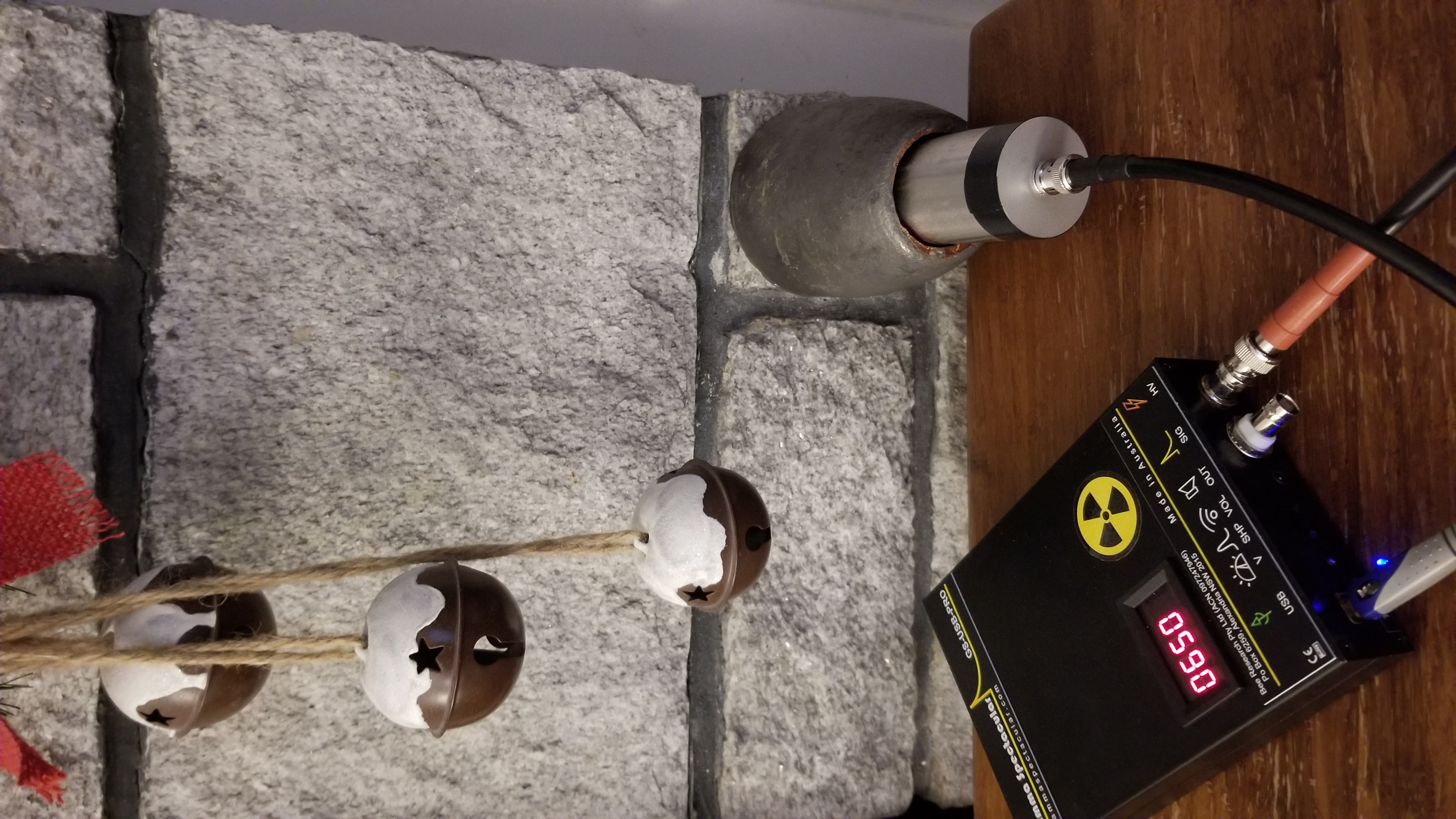

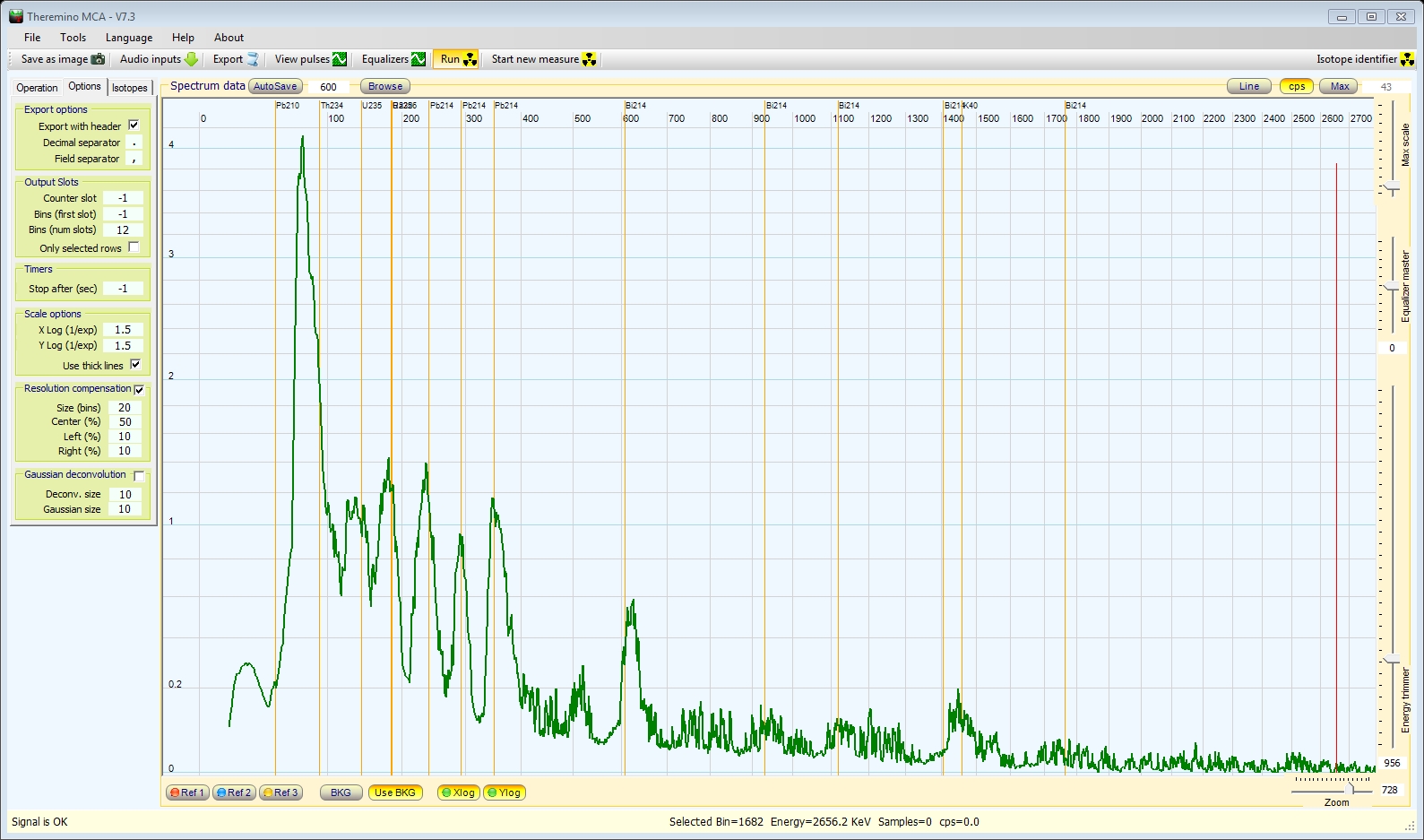

For what is worth - a few self explanatory images:
Granite blocks in my fireplace.
Gamma spectroscopy of the Fireplace using NaI(Tl) detector.
Typical natural uranium spectrum.
Resolution compensation for NaI(Tl) detector makes the spectrum more "expressive".
