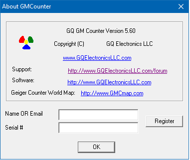

now I have questions: I entered the number in the header for it, as well as my name in the proper heading and pushed register... now what to expect? nothing apparent happened, the "unregistered" wording is still there. does one try again? does one wait? does capitalization of the alpha component in the alpha-numeric string matter?
the 5th try worked. used my email, not my user name, and capitalization was used I *think. the register screen said email or name, but the received email said "use this email to log in", prudent advivce. it said "software updated" so there was notification. for what its worth, this has been my experience. Going to try to restart the computer and see if the red lettering goes away.

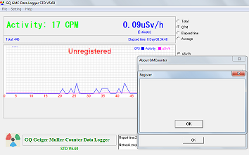

I am still having the red lettering "unregistered"
the program was uninstalled, reinstalled, and same thing. the guide for software said it must be entered on first opening, hence the uninstall etc.
About the password, upper case, lower case, name or email, it didn't matter. nothing was happening. I included the colon in front of the PW and it gave me a rather small and totally blank pop-up notification window on top of the registration pop-up window. restarted it, still nothing has changed. I got it in after all that and excluded the colon, and it gave me "software updated" "thank you" ... no restart yet, but still red lettering.
the software reads my 320+ like before and posts my data to world map just fine, but the red lettering will not go away. also curious, the zipped download was for 5.6 data logger pro ... however if you hover the mouse over the running tile in start bar, it says "GQ GMC Data Logger STD V5.60"

on my other laptop it allows me to enter everything, but does nothing when I push register. if I include the colon in front of the serialnumber, it gives me the blank small pop-up window and the data logger software shows network error in the text box lower right

That's kinda the point. I'm not sure what's included as the number. Obviously I've disguised the valuable part to an alpha character and numerical to A and zero's not actual PW length, don't need to be handing stuff out. But this is what I'm talking about.
"Your order tracking#:A000000 (By email) you may track it from: -."
If I enter "A000000 " it does nothing if I enter ":A000000" it gives blank pop up. I've also tried "a000000" " :a000000"

so I've tried that now, same result. windows 7 home premium, safe mode w/ networking, entered password = "software updated .... thank you". and if you do it again it adds another so "software updated. software updated. ... thank you". there is still red wording, though this time I did not see a network error warning in the text window,so that's nice.
but the red does not go away. I ran it as administrator, and have no clue what next. but Ill keep at it and see what I can come up with. wont be giving up easy. I have a friend that helps when I cant figure things out. if it comes to that
trying after safe mode, now normal mode, nothing on just type in pass, but copy paste entry from email does say "software updated thankyou". the below was from text window in data logger program. maybe this helps narrow it down.
