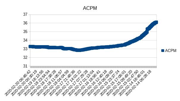

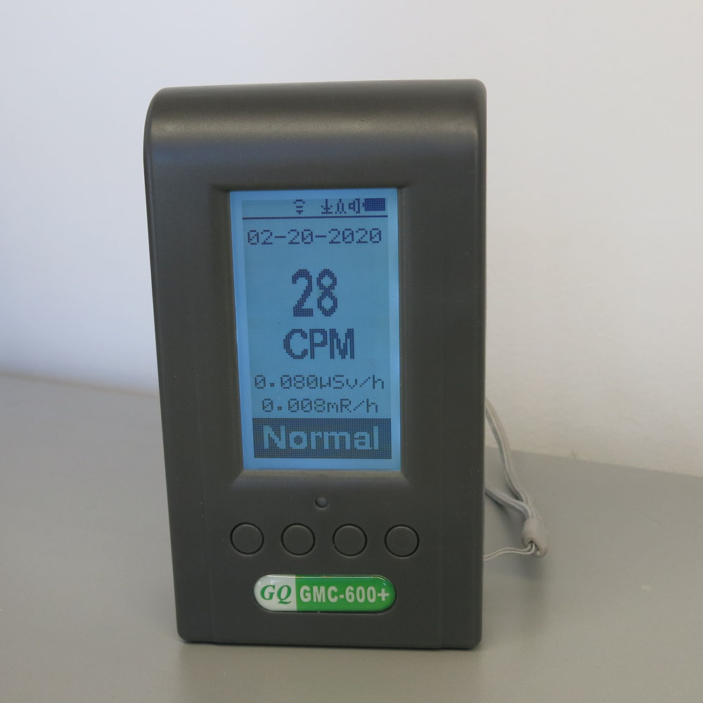

I received my new GMC-600+ about two weeks ago and I am delighted with it. A very nice product! My purchase decision was partially based on this excellent forum.
Mostly my 600+ has been sitting in one place on a desk measuring the background here every 15 minutes. My ACPM has converged over 500 measurements to 33.25.
I tried exploring the house and early on some mildly radioactive samples I have but mostly for the past two weeks it has been sitting in the same place in the house, on my desk.
I added myself to gmcmap. There aren't many near me and not many GMC-600+'s.
I seem to be higher than the others I see, although well below any danger level.
I thought I would post these early results for your info and comments.
George
23410 bytes
31194 bytes
Older data is to the right on both the above charts.

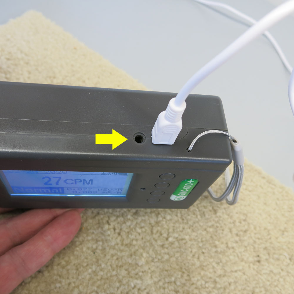

What is the purpose of the little hole next to the USB on the GMC-600+? I don't see it explained in the manual. Maybe I missed that.

Hi bigfatdaddy, looks like you haven't found anything hot yet XD. Your CPM is slightly higher than GMC 300/320/500+ and even 600 because you counter is more sensitive and can detect alpha radiation. You should compare the dose rate uSv/h or mR/h instead.

The extra hole in the device is for analog/audio output. This is only and extra feature that is why it is not included in the manual.

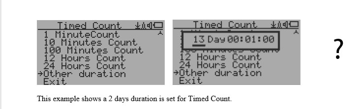

EmfDev suggested Timed Count. I am trying that without success.
Are there a couple of typos on pg 26-7 of the GMC-600+ manual in the description of setting the Timed count schedule? To me the words don't match the pictures.
35468 bytes
45360 bytes
But it says that I don't have to set a schedule. SO I leave the Schedule blank (all zero) and try a one minute timed count. I see the flashing clock icon (which stops after a minute) and I see the message for timed count started. Then it switches to Cancel or Exit and I cannot see the screen pictured in the manual that gives the timed count result. If I select cancel, it announces that timed count has ended and I am back at the main menu.
Need help please. Timed count sounds worthwhile. Thnx.

The Set Schedule is the duration before the actual process starts. If you set it to 0, and then click 1 MinuteCount, it will start immediately. Once started that menu changes to Cancel and Exit. You can see the process in the Home Screen. It will add another mode as Timed Count Mode (e.g Large Font -> Text -> Graphic -> Food -> Timed Count).

EmfDev:
Got it!
I didn't understand about getting back to the home screen. One has to Exit Timed Count at the Cancel or Exit screen and then navigate back out of the menus to the home screen. There, as you said, a *new* display mode of Timed Count has appeared and I can observe the count progress, once that is selected!
I think the GMC-600+ manual description of Timed Count could use some improvement. The device itself is first class!
Thank you for this forum and for your support!

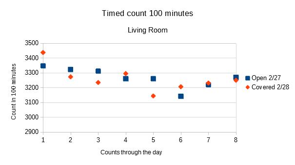

My first attempt at trying to discriminate alpha using 100 minute Timed Count over two days. The first day I left the pancake window open, the second day I covered it with two sheets of bond paper. The GMC-600+ was picked up to reset the count numerous times but it was always placed in the same spot aiming in the same direction, straight across the room.
As I am new with the counter, the exercise was worthwhile to see the background here in another way, other than with gmcmap. Throughout the experiment, my gmc-600+ continued to update my gmcmap data while doing timed counts when requested.
Thank you to Stargazer for the suggestion.
15742 bytes
My conclusion is that, at least in my living room, there is next to no alpha radiation. Or is buried in the normal background variation over the day, since the paper shield makes no apparent difference?
I notice now that the Legend in my chart is wrong, the days were 2/26 Open and 2/27 Covered.

Looks like there is not much of a difference, then you might need a radon meter after all to check for radon. Maybe try for more minutes, like 1 day or so.

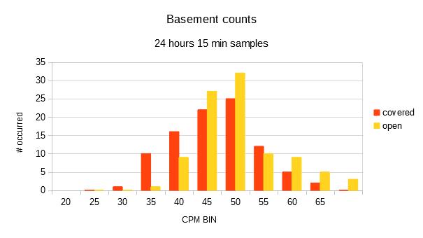

Result of two 24 hour timed counts in my basement as suggested. Same location as used for the mail in radon tests done two years ago.
Uncovered window
63653 counts
44.2 ACPM
0.126 uSv/h
0.013 mR/h
Covered window (2 sheets bond paper)
56111 counts
38.96 ACPM
0.109 uSv/h
0.011 mR/h
A histogram from my gmcmap data downloaded from the same periods with 15 minute updates:
16939 bytes
I don't know how to properly interpret the results but it seems clear that over a long enough period, I am able to see evidence of some radon in my basement with the GMC-600+ by using paper as an alpha filter.

The paper will certainly stop any alphas. The decay chain of Radon also releases betas too. What did your mail in Radon test kit give for pCi/L?
