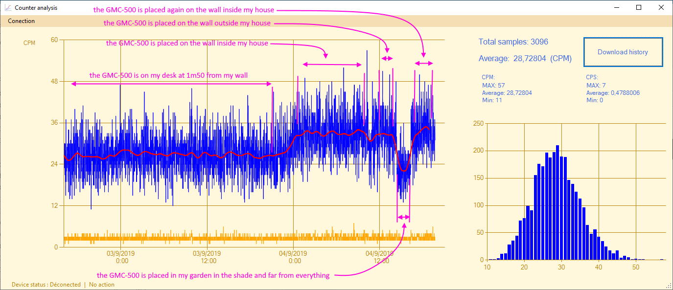

Since I started my meter, I have a very stable operation.
He was sensitive to his position, I think I found why.
In any case, when my detector is out far from everything, I have 22 CPM (average)
Inside the house, on my desk it is 27CPM
And close to the wall of my house he goes to 32CPM (on the inside or outside side of the wall.
my wall is build with hollow breeze + plastered brick + plaster
Also as I am in Bretagne in France, I am in high risk radon zone.
But radon emits alpha particles, in principle it is not detected by GMC-500, but could it be partially?
Below is a recording that I made,
Can someone help me understand what it could be, if it can be radon?
The levels are not very violent either, but could be different if I did the same thing with a GMC-600.

Posted - 09/04/2019 :  12:31:43  Show Profile  Reply with Quote
Ullix has tested the tube few days ago and thinks that the tube can be affected by temperature. How is temperature different from outside? Just to make sure it's not a part of why the increase in CPM near the wall.
Posted - 09/04/2019 :  13:09:38  Show Profile  Reply with Quote
The temperature is about the same about 24 ° C
I made measurements against the wall at the same temperature as far from everything.
Likewise the interior against the wall and on my desk is same temperature and the measurement is diferent.
I also see the Ullix post and do some experimentation, but I do not find significatives variations of the measurement depending on the temperature, I just test around 20 and 30 °C.
But I will redo more measurements with my wall.
Posted - 09/05/2019 :  01:04:58  Show Profile  Reply with Quote
Hi EmfDev,
I confirm my levels, they are stable and repeatable.
Over the nights and the days I have small temperature changes that I do not see disturbing my measurements but the changes are straightforward and systematic when I approach my wall and they stay with right stability.

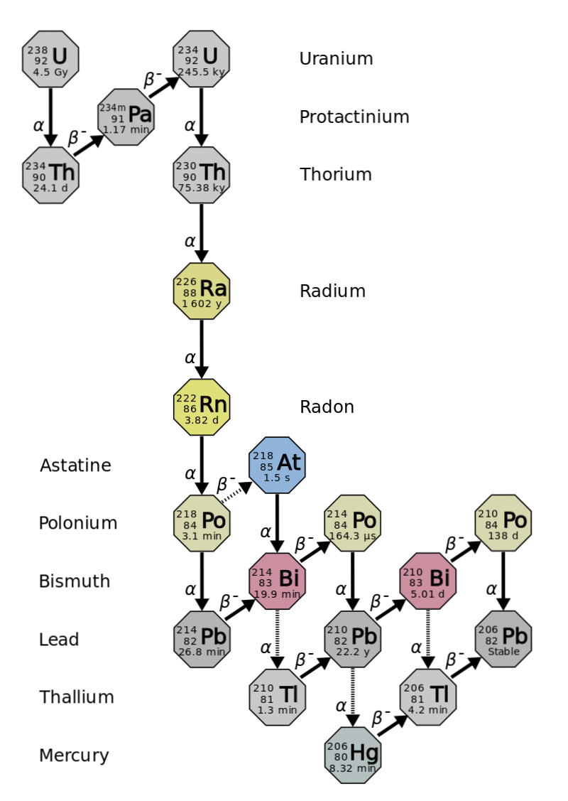

At the same time, I found what I did not understand:
Looking to the chain of disintegration of Uranium 238, of which radon gas (Rn222) is a part:
78238 bytes
Source: https://en.wikipedia.org/wiki/Decay_chain
We see that in the short term, the 'radon 222' Gas (Rn222) in his disintegration sequence emits 3 alpha particles and 2 beta particles to arrive at 'Lead 210'(Pb210).
Then after, with a half-life of 22 years, it emit 2 Beta and 1 alpha to arrive at 'Lead 206'(Pb206) stable and not radioactive.
Because of my wall is build with hollow breeze and the radon gas and its derivatives are confined inside,
My GMC-500 must see Beta particles emited during Pb214->Bi214 and Bi214->Po214 desintegration,
and peraps because my house have more 40 years old, the 2 beta particles emited during Pb210->Bi210 and Bi210->Po210 desintegration.

Posted - 09/05/2019 :  01:25:43  Show Profile  Reply with Quote
I would argue that you never are "far from everything", because on the one side you will have the whole earth, and on the other other half the universe. Both contribute to the count rates measured, which we call the background.
It is also not surprising that wall material, and tiles in particular, contribute to the background. This may be due to an enhanced concentration of Potassium ( see my Potty Training article) or due to contributions of heavy metals, including some of the Uranium & friends intentional (colors) or un-intentional mixtures.
Just be aware of what your background is at any spot. It should be rather constant. If not, make sure the tube is not acting up before you blame anyone for missile explosions ;-)
By the way, GQ is specifying their counters with the M4011 tube as having an
"Instrument Background: < 0,2 pulses/s" (see any of their manuals)
i.e. the counter / tube assembly may contribute up to 12CPM! Nothing one can do about it.

Posted - 09/06/2019 :  01:11:37  Show Profile  Reply with Quote
I don't see any reason to suspect Radon as a source of radiation in your home, let alone a significant one. And even if it were even detectable - the radiation that you have measured is very low!
If you want to further characterize the type of radiation, I suggest this:
The radiation from our environment is predominantly beta (K40, U, Th, etc). The plastic case of a counter is already absorbing a good chunk of the betas. So, take off the backplate to have tube exposed, and then with this naked tube go close to the wall, tiles, stoneware, etc. and register counts over a sufficiently long time. Poisson verification recommended!
Actually, you might want to leave a space of a few mm. This will allow you to insert some shielding material to absorb all betas and only let the gammas pass almost unchanged. The difference between the counts with/without shielding will then provide an estimate for the betas and gammas.
The shielding could be glass (3mm), aluminum (3mm), copper (2mm), steel (1mm). But since those materials may result in the creation of Bremsstrahlung, confounding your results, you might also experiment with sandwiched material (plastic + metal).
More details on all those consideration in my Potty Training (https://sourceforge.net/projects/geigerlog/files/Articles/GeigerLog-Potty%20Training%20for%20Your%20Geiger%20Counter-v1.0.pdf/download )
