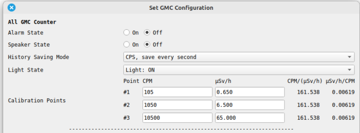

Since you read the chapter, you will have realized that there is no point to change the calibration, since it is "the other way round": The GMC counter uses the average as the two specific SBM20 calibrations as its own universal calibration! Without having done a calibration, as there has never been one presented.
But if you have good reason to set a new calibration, then start GeigerLog and look at the "Set GMC Configuration" dialog:
This one is for a GMC-300S. It shows 3 calibration points, and all three are needed by the firmware, although all 3 result in the exact same sensitivity of 161.538 in units of CPM / (uSv/h).
Assuming you now want a sensitivity of 200. Don't change the CPM values (needed for some odd function in the firmware) and calculate all three CPM / Sensitivity: e.g. for the first: 105 / 200 = 0.525, and put it into the 3 fields for uSv/h:
Now you have a sensitivity of 200 CPM/(uSv/h), click the ok button, and you are done, the counter is set to that new sensitivity!
Note that these values are used ONLY inside the counter! GeigerLog ignores those settings, and uses whatever you have set it to. And you can change it at any time, back and forth.

Then I suggest to install GeigerLog and use the dialogs as shown in Reply#6 to enter your numbers, then click the ok button, and it will be uploaded to the counter.
But there is no need to modify the default calibration, as the default calibration of a GMC-3XX counter is actually taken as the average of the two calibration values known for the SBM20; see the GeigerLog manual.
