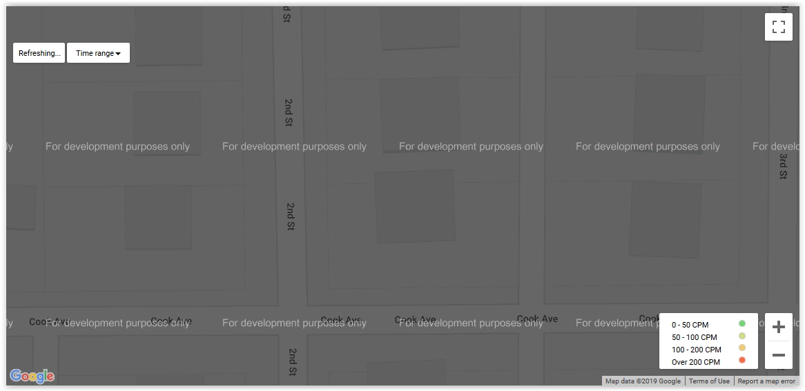

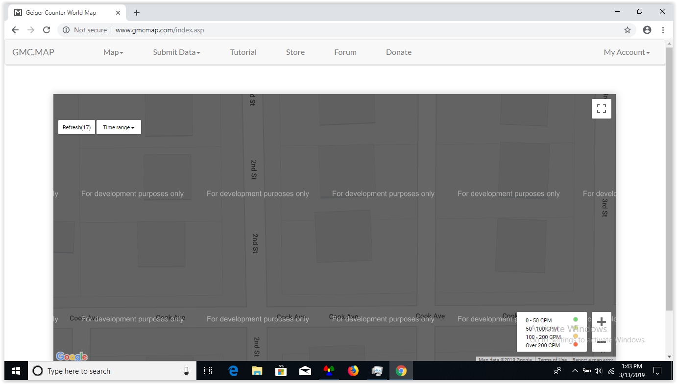

Posted - 03/13/2019 :  10:56:42  Show Profile  Reply with Quote
Still not working with Chrome. I even tried fixing this using my phone. Nothing works.

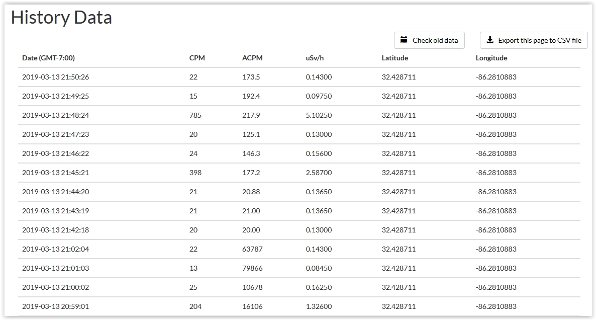

2395 Posts
Posted - 03/13/2019 :  13:07:13  Show Profile  Reply with Quote
Have you tried submitting data?

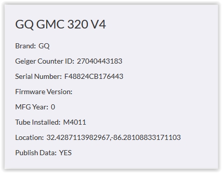

Can I ask for your geiger counter ID?
Michael McKenzie
25 Posts
Posted - 03/13/2019 :  15:53:33  Show Profile  Reply with Quote

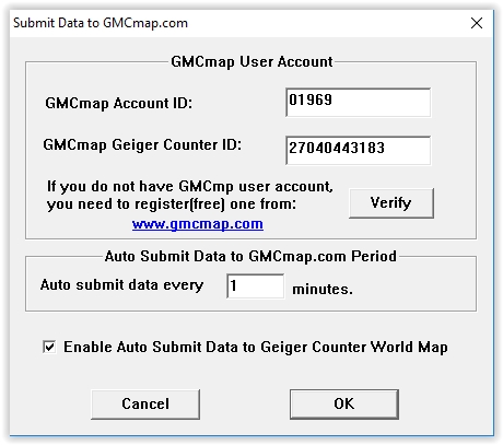

How do you upload the data? Can I ask for the server parameters? Thanks.
Michael McKenzie
25 Posts
Posted - 03/14/2019 :  08:58:31  Show Profile  Reply with Quote
You asking about this?
79419 bytes

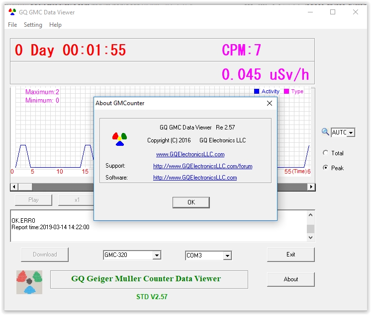

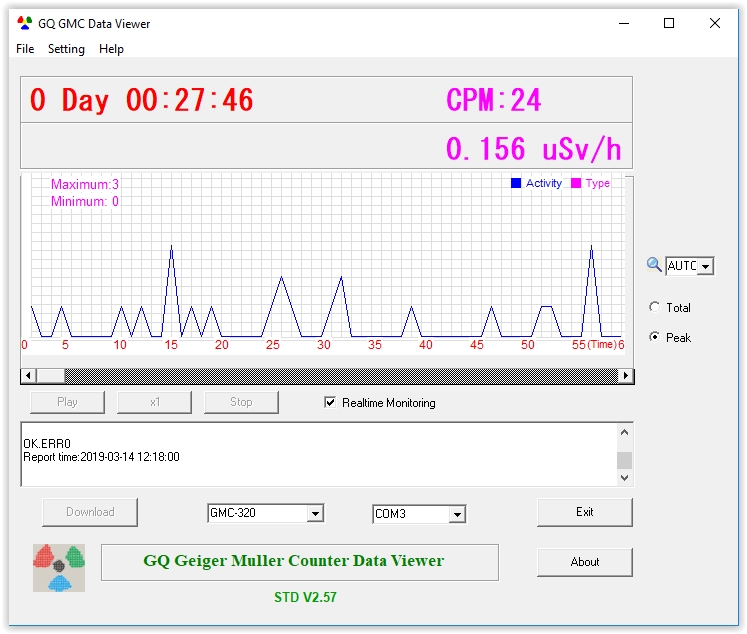

Are you using data logger pro? or data viewer? And can I ask the version? it's in "About".
Michael McKenzie
25 Posts
Posted - 03/14/2019 :  09:21:18  Show Profile  Reply with Quote
206518 bytes
2395 Posts
Posted - 03/14/2019 :  09:42:52  Show Profile  Reply with Quote
Can you please click the help and about to check the software revision? I'm trying to figure out if it's in the correct database.
Michael McKenzie
25 Posts
Posted - 03/14/2019 :  09:45:51  Show Profile  Reply with Quote
192103 bytes

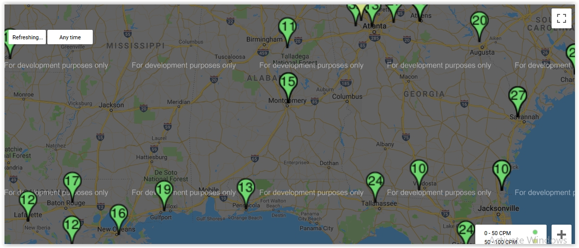

Posted - 03/14/2019 :  10:02:22  Show Profile  Reply with Quote
1PM and I haven't seen nothing yet
Reply #27
Michael McKenzie
25 Posts
Posted - 03/14/2019 :  10:04:19  Show Profile  Reply with Quote

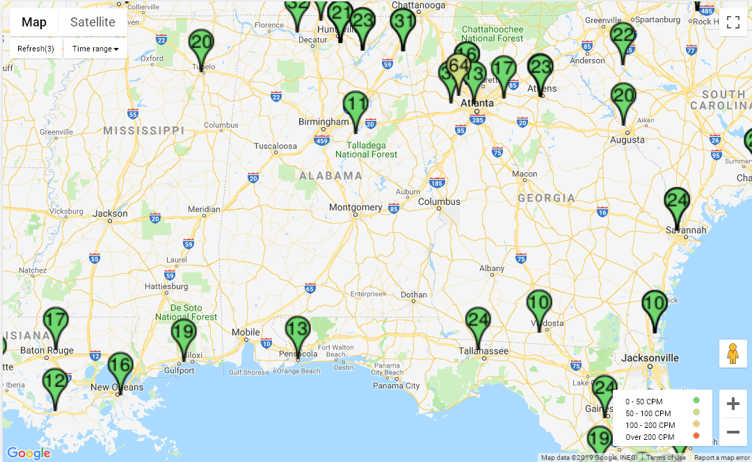

Ok I see 15 now.
Reply #28
Michael McKenzie
25 Posts
Posted - 03/14/2019 :  10:06:51  Show Profile  Reply with Quote
397784 bytes
Reply #29
2395 Posts
Posted - 03/14/2019 :  10:16:39  Show Profile  Reply with Quote
That's my data. I now deleted it. Maybe try to create a new one. But don't delete the old one. I even checked the "Only I can see my data" box and I still can see my pin.

Ok before doing that. Try this first. On the data viewer Geiger Counter World Map option, remove the zero "0" in front of your user ID.

That's the new one. Yes but i think the problem was the userID under the Geiger Counter World Map. You need to remove the leading Zero. Right now you won't be able to update the number in the pin if you don't remove that zero.
Reply #39
Michael McKenzie
25 Posts
Posted - 03/14/2019 :  11:37:37  Show Profile  Reply with Quote
Just removed the zero.
