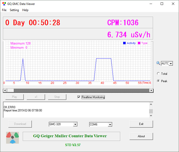

Question about large bursts, like this one I just watched roll by. For several seconds, the Viewer records a large burst and the CPM just keeps climbing. I don't hear clicks. Data is still being uploaded so you'll probably see it in the data. Nope - gmcmap recorded 19CPM for the next capture but the NEXT one, 5 minutes later, is 911CPM? I do see these burst in my data periodically.
106415 bytes

Hello. I don't know if Data Viewer is sending my info or not. You asked me to specifically set up my unit with Data Viewer and that is what I did, without touching the buttons, as I said. And I left it running that way. Now I have been sending data for six hours. I can see my data on your site so certainly something is working correctly? Should I close Data Viewer now to see if sending stops? I have data there and I am not on the map. That was my main reason to get the V5 version.
bigfatdaddy
Posted - 02/06/2019 :  11:54:02  Show Profile  Reply with Quote
Ohh I see. The screen shot shows "Report time:..." which means the data viewer is sending your data online. But I don't know if you also configured the device to send online so they can be sending at the same time. When I said configure the unit to send online using data viewer, I was trying to say that you can set the WiFi and Server parameters on the unit using the Data Viewer under Data Viewer Settings -> Other. But seems like the data viewer is working for now. Make sure there are no interference with the COM6. It can cause wrong data readings.
If you want to not use the data viewer or want to disconnect it. Just configure the device to send online to see if it works. Looks like it worked before for few hours then the server parameters on the unit became garbage(it can be an issue from the unit). After configuring, you can disconnect, then connect to WiFi, and then use test connection. After that it should continually send online. If the server parameters get messed up again, then there is a problem with the unit.
Edited by - EmfDev on 02/06/2019 11:59:33
