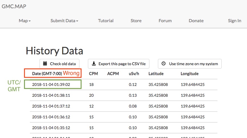

Posted - 11/03/2018 :  17:37:33  Show Profile  Reply with Quote
CPM is sent every minute as a positive Integer value.
Floating point values with decimals are unnecessary.
It is also unnecessary to send ACPM which has to be the same anyway.
From now on:
- ACPM value is omitted.
- CPM (CPM1st value) is positive integer.
gmcmap popup window of the monitoring station should not show 0 value for ACMP.
Should be left empty instead
See image below.
44528 bytes
To bug or not debug, that is the Q
