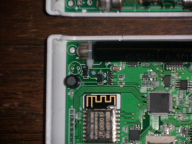

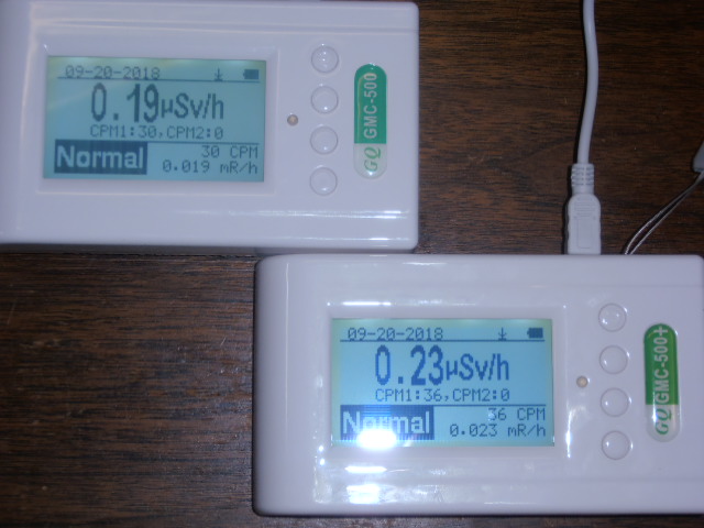

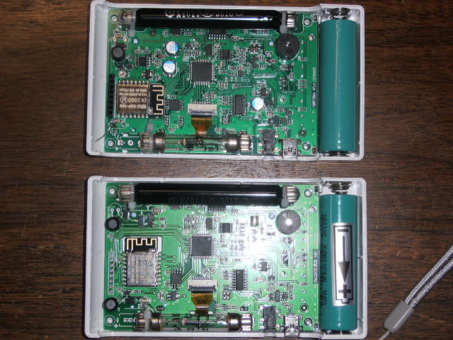

Here are my two 500 meters. At the top labelled GMC-500 is my first 500+. Lower right labelled GMC-500+ is the GMC-500+V2.
79109 bytes
One hardware limitation of the 500+ is that both GM tubes are connected in parallel to the HV power supply. This allows response of the higher sensitivity tube to affect the response of the lower sensitivity tube. The 500+V2 eliminates that issue with a separate power supply for each tube. Here is a picture of the PCB boards with 500+ at top and 500+V2 underneath. The twin power supply sections are obvious in upper and lower left corners of the lower PCB board. The larger black components are an inductance coil for each. Missing from the 500+V2 is the pot controlling the HV voltage level to the tubes (silver component just below the upper large black component in the upper left corner of the upper PCB board). The voltage of each power supply is now controlled by firmware with new menu selections under Init Setup at the first menu level.
78835 bytes

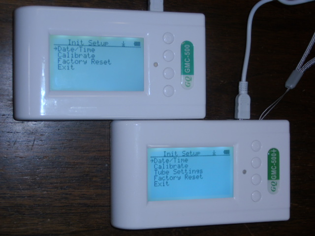

Previously at the first level under Init Setup, tube selection, display and calibration items were under the Calibration menu. In the V2 there is now an additional selection titled Tube Settings.
78799 bytes

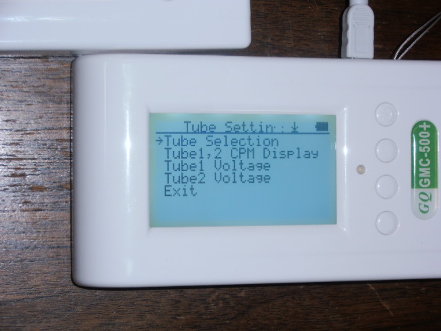

Calibrate now only has the three calibration points to set. Choosing Tube Settings gives access to Selection, Display and the ability to set the voltage for each tube.
78916 bytes
When you select Tube1 or Tube2 Voltage you get a popup window with the percentage of the power supply's output. It goes away pretty fast if you don't change it but you can increase or decrease by unit count. The meter arrived with both power supplies set to 22 (22%). At these levels the power supplies each measure 392 VDC. I haven't yet tested how much change each unit increase provides, but will be one of the first things I measure when I next get some time.
That covers the first aspect of the existing hardware we were concerned about. The other was current draw and voltage drop with increased counts of most sensitive tube first and its effects on voltage at least sensitive tube. Given that we now control voltage of both power supplies with firmware (manually at present with menu adjustment of percentage), later adds to firmware may be able to adjust power supply voltage automatically as the tube draws it down due to count loading. We can also set voltage of most sensitive GM tube to 0%, effectively turning it off. Again something we've discussed as a requirement of fully utilizing each tube across its plateau area of response.
And one more optional plus to the V2. The new PCB has room to augment the primary tube power supply (M4011). Four user installed components can be added to double the current the power supply can provide. In the upper left corner of the PCB there is a parallel branch missing these components. Above the larger black component is a second spot for another inductor. The other components have already been added to this PCB (resistor, diode and a transistor as surface mount devices). When the inductor is in place the current the power supply to the primary M4011 tube is doubled.
80764 bytes
We have a lot to evaluate anew. And I for one am once again pretty amazed at how an electronics company can be this responsive to user feedback. I remain committed to the belief that they intend these series of GM meters to set the standard by which other will be measured.

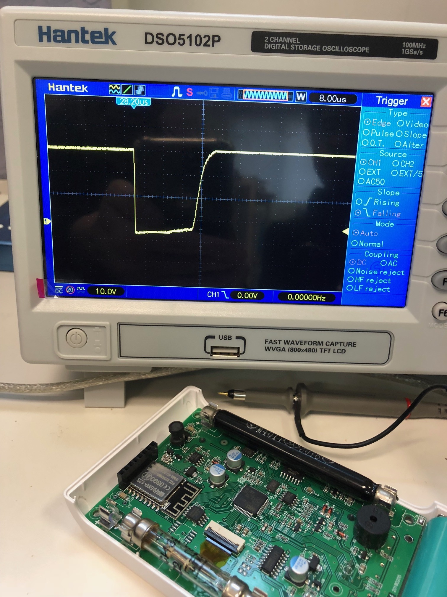

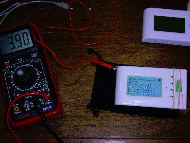

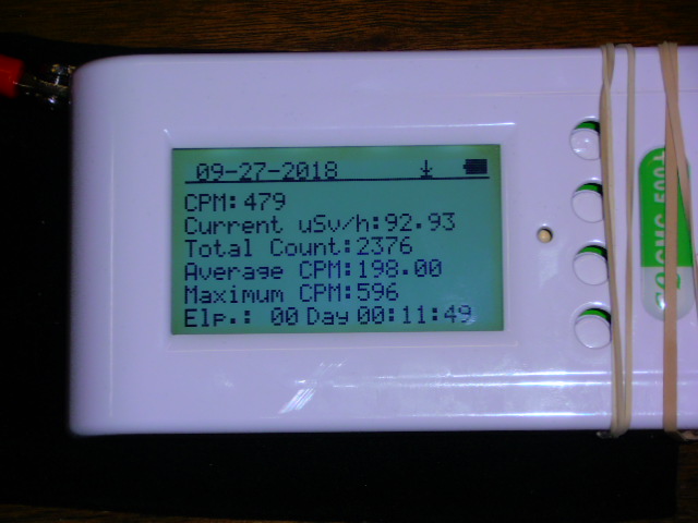

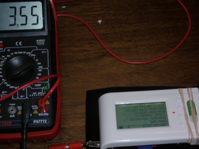

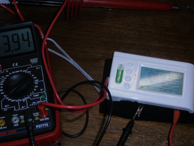

I finally got workable wiring to DMM to make a couple measurements. First pic is the 5 uCi Cs137 source with M4011 tube laying on it centered. Counts are quite dramatic (over 100,000CPM). ullix's 60,000CPM easily surpassed (ZLM said same power supply as in 500+, just two of them IIRC.)
68813 bytes
The second picture shows the screen still with the Cs 137 5 uCi source against the M4011 tube but also showing the voltage of the anode cathode measure of the SI3BG tube voltage while the M4011 tube at same high CPM.
79858 bytes
Reading of tube 2 voltage didn't change at all with high counts of tube 1 and is still as set at GQ prior to shipping (394 VDC).

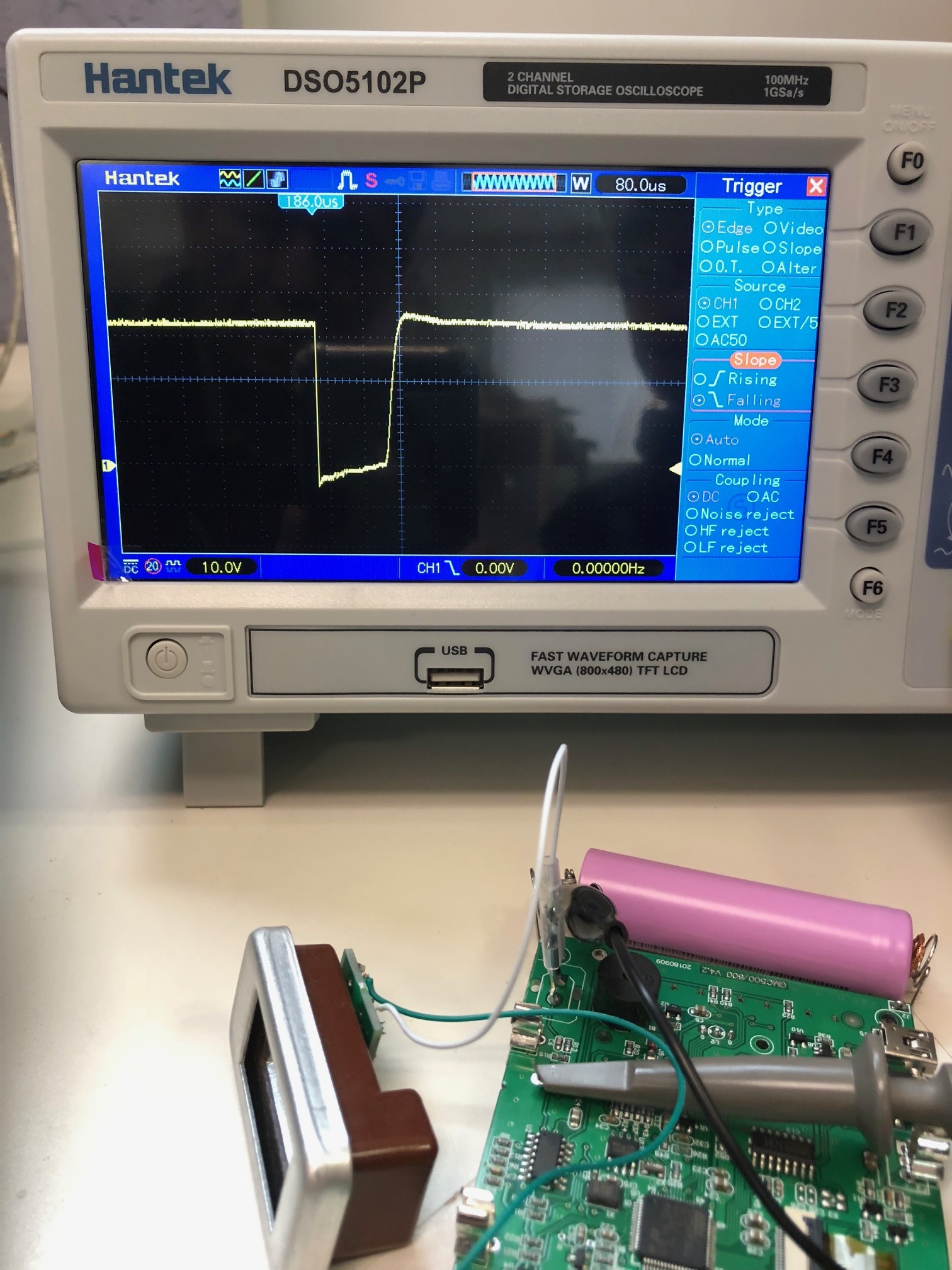

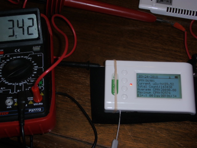

Next image is now showing measure of counts after attaching clips to anode and cathode of M4011. (Both tube voltage measurements were without the anode resistor included.) The voltage of the M4011 tube had been increased to 435 VDC by raising voltage percentage of tube 1 to 26 from 22.
79038 bytes
CPM are down from slightly different position of source, but still over 85,000. Voltage of tube 1 has dropped below starting voltage to 342 VDC. So one of two things has happened. Tube 1 voltage has been pulled down to a point where we are out of the plateau region (for sure) and simply accepting counts as the PS recovers (although still a very high rate), or we might still be reading max counts and this tube might still be functioning well in the plateau region, but we're not getting true voltage because our DMM is not sampling adequately.
Probably could tell by building a stand and bring source closer step by step. Down the road maybe.
These power supplies appear completely independent so far, with high counts on tube 1 not affecting voltage at tube 2.
Stargazer 40
Edited by - Stargazer 40 on 09/24/2018 13:00:14

Thanks Stargazer_40. Very interesting measurements! And good news in any case. Just a couple of points:

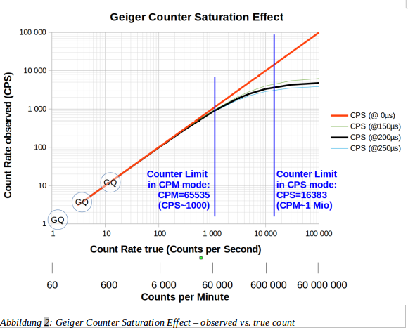

When you get your measurements using the DMM, are you correcting for the effect of the multimeter+1GOhm impedance in parallel with the tube? If you don’t, then you cannot know the exact voltage. For example, if your DMM reads 3.809 V, the actual voltage in the tube when the DMM is connected will be 101*3.809=384.709 V (10 MOhm DMM with 1GOhm resistor). But the tube will be under higher voltage when you disconnect the DMM, and that depends on the internal (output) impedance of the HV circuit. For 16.12 MOhm (shown in ullix’s circuit), 384.709 V will become 392 V when the DMM is not connected (and the tube is not counting or is counting at low CPM).
That could also be the reason why your M4011 reduces the CPM when the DMM is connected to the tube terminals (not because of the source), as you are increasing the current consumption with the DMM in parallel and the HV PS cannot provide enough power. When you measure the HV system you change the system (like the Heisenberg's uncertainty principle).
If you are measuring around 100 kCPM and not the ullix’s predicted 60 kCPM is probably because the HV circuit of the 500+V2 can deliver more current (is more powerful) than the original 500+. Effectively, that would mean that its internal impedance is lower. Ullix, where did you find the internal impedance of 16.12 MOhm for the HV PS of the 500+? To be fair, I haven’t looked into the PCB.
And by the way, for 100 kCPM, we are entering a region where the dead counts due to the tube response time become important! For 200 us of recovery time, 100 kCPM will become 150 kCPM after the correction. A big error percentage! But now fixable by firmware ;)
Edited by - ikerrg on 09/24/2018 13:40:07
Stargazer 40
431 Posts
Posted - 09/24/2018 :  14:28:27  Show Profile  Reply with Quote
To be correct I have a 990MOhm probe. So reading with 10MOhm meter is direct times 100. I'll go through your thoughts again tomorrow when I have more time and also look at EmfDef's approach to increasing voltage while measuring (after all we want to do that with firmware as voltage drops during counts. Good to try.)

Posted - 09/24/2018 :  15:26:28  Show Profile  Reply with Quote

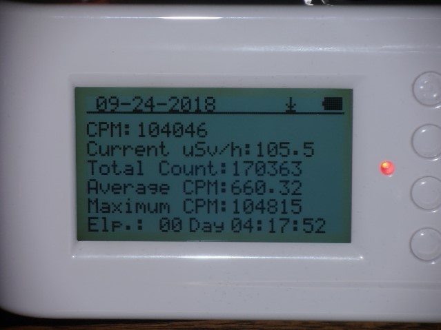

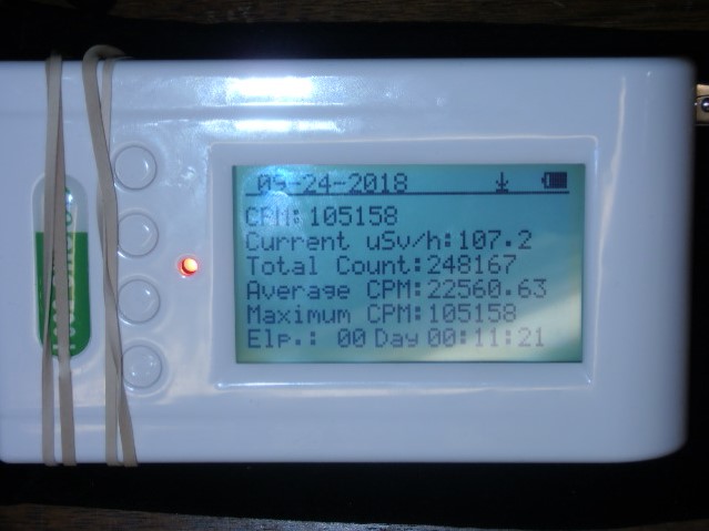

Instead of adjusting while high counts (difficult when device is apart), I set the tube 1 voltage to 550VDC (40%, and Limit Working Voltage of M4011 is 600VDC so okay) and then set the source underneath the center of the M4011 tube. The voltage fell immediately to between 350 and 357 while counting up, so below plateau start of 360VDC (but remained at or above max starting voltage of 350VDC). Placement of center of source and center of tube critical for highest counts it appears. Got over 105,000 CPM (so if meter affecting things not a lot).
79146 bytes
Then a pic of the tube 1's voltage and screen of meter with source.
79559 bytes
So with this 100,000CPM source, we need a starting voltage of 550VDC to be able to stay at or above the Max Starting Voltage of 350DCV. I think if we can start at 400 VDC (middle of plateau - Tube1 Voltage - 22) and raise voltage when it drops below middle of plateau (400 VDC) using whatever percentage it takes to keep it above 400 VDC with firmware (Auto Voltage Adjust - On/Off and Auto Voltage Trigger Level Percentage - 22 and Auto Voltage Upper Limit Percentage - 75) we would have a very flexible meter.
Stargazer 40

So I have reviewed the dead time calculation and see that if dead time is 200 usec (as ikerrg suggests) then we are looking at 20 sec of dead time for 100k CPM. So 100k/(1-(20/60)) = 100k/(1-.33) = 100k/.67 = ~150k CPM actual. However, if 100 usec, then we get 100k/.83 = ~120k CPM actual. Do we have any idea what the actual dead time is for this M4011 tube (and the SI3BG tube for that matter)? One place I read says 100 usec dead time is average. But perhaps we would need to make dead time a user supplied variable in any correction.
Stargazer 40
Edited by - Stargazer 40 on 09/25/2018 03:48:14
ikerrg
334 Posts
Posted - 09/25/2018 :  04:04:59  Show Profile  Reply with Quote

Posted - 09/27/2018 :  04:52:03  Show Profile  Reply with Quote
In reply #21 of ullix's 500+ review I measured the CPM of my 5 uCi Cs 137 source with the source against the outside of the case in the center of the SI3BG tube with my original 500+. Got 217 CPM. I think now that that number was not correct. I hadn't removed the M4011 tube and the value has to be a combination of the two tubes counts. With the V2 I removed the back of the case, turned the voltage of tube1 to 10%, effectively turning off the tube and placed the source in contact with the center of the SI3BG tube. CPM stabilized just below 500CPM and there was only a couple volts drop on the meter (
77528 bytes
80970 bytes
Compared with the source counts I got with the M4011 tube in the same configuration (105,000CPM) there is a difference of 214 times. So for both betas and gammas coming off the source I see a conversion factor of 214 * .0065 = 1.391. Entered into the 25 count calibration point 3 would be 34.775 and this is about half the sensitivity I have gotten before with gas lantern mantles (15.85) and about one seventh the sensitivity of GQ's .195 conversion factor for the SI3BG tube. While I think a better number than anything I've come up with so far, it doesn't really mean much as I think I really need to separate out all the beta noise as ullix has said on numerous occasions. The thin lead plates on either side of the source will likely allow that as we have seen again in post #21 of ullix's 500+ review. That will be next experiement.
Stargazer 40

Posted - 09/27/2018 :  06:21:19  Show Profile  Reply with Quote
I think you should always use the "Large text" screen with the corresponding option activated to see the CPM of both tubes at once. If you take a picture to that screen, then you will be able to see later if the other tube was measuring counts and what number, to see if the results could be cross-talking. This is not so important for the 500+ V2, I suppose, as the cross-talk is small or non-existing.

Posted - 09/27/2018 :  07:09:20  Show Profile  Reply with Quote
I agree, as I had the original meter a couple inches away on tube 1 and it was adding between 100 and 200CPM from the proximity to the source. Nice to be able to turn off the M4011 in the V2!

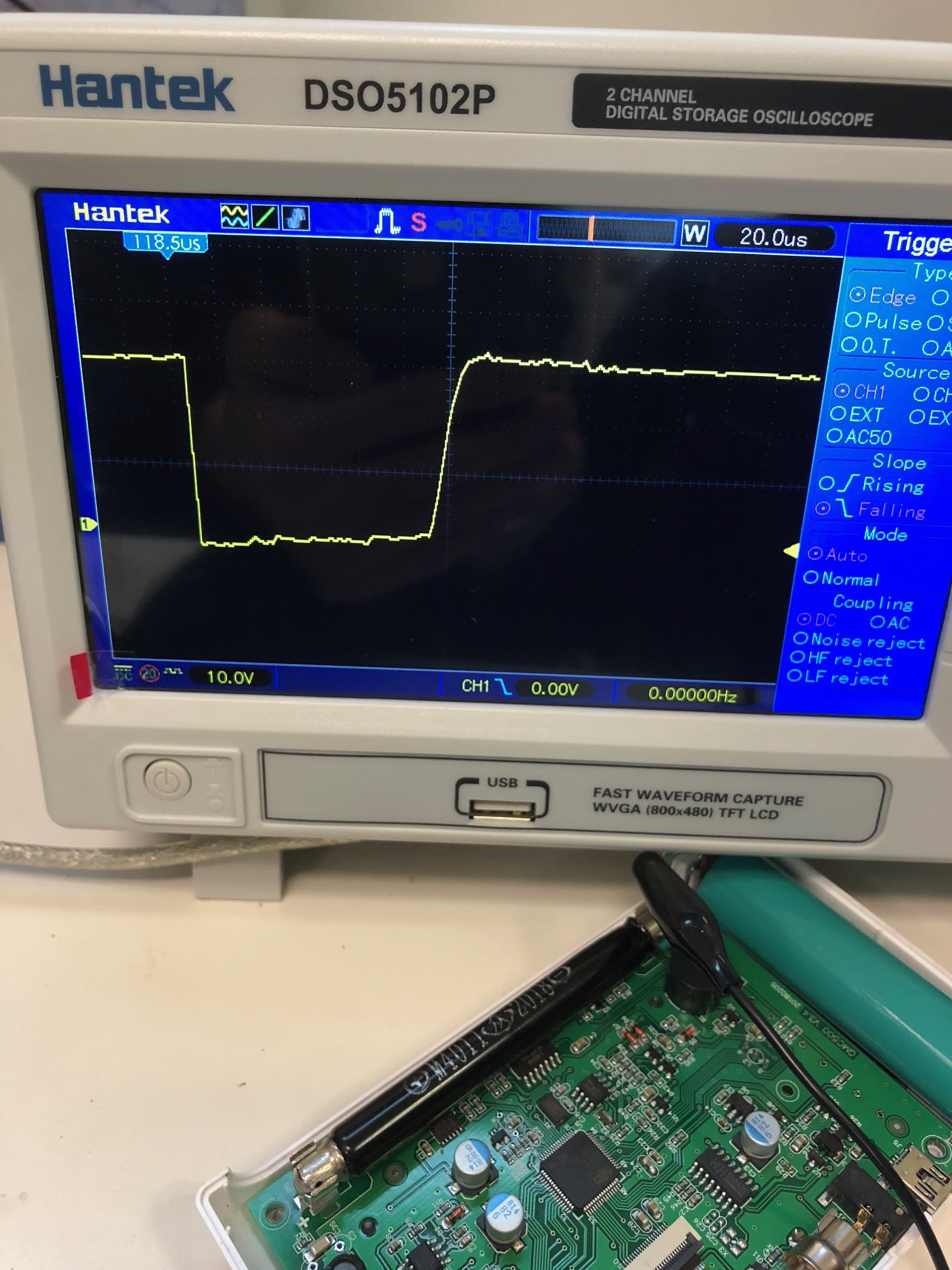

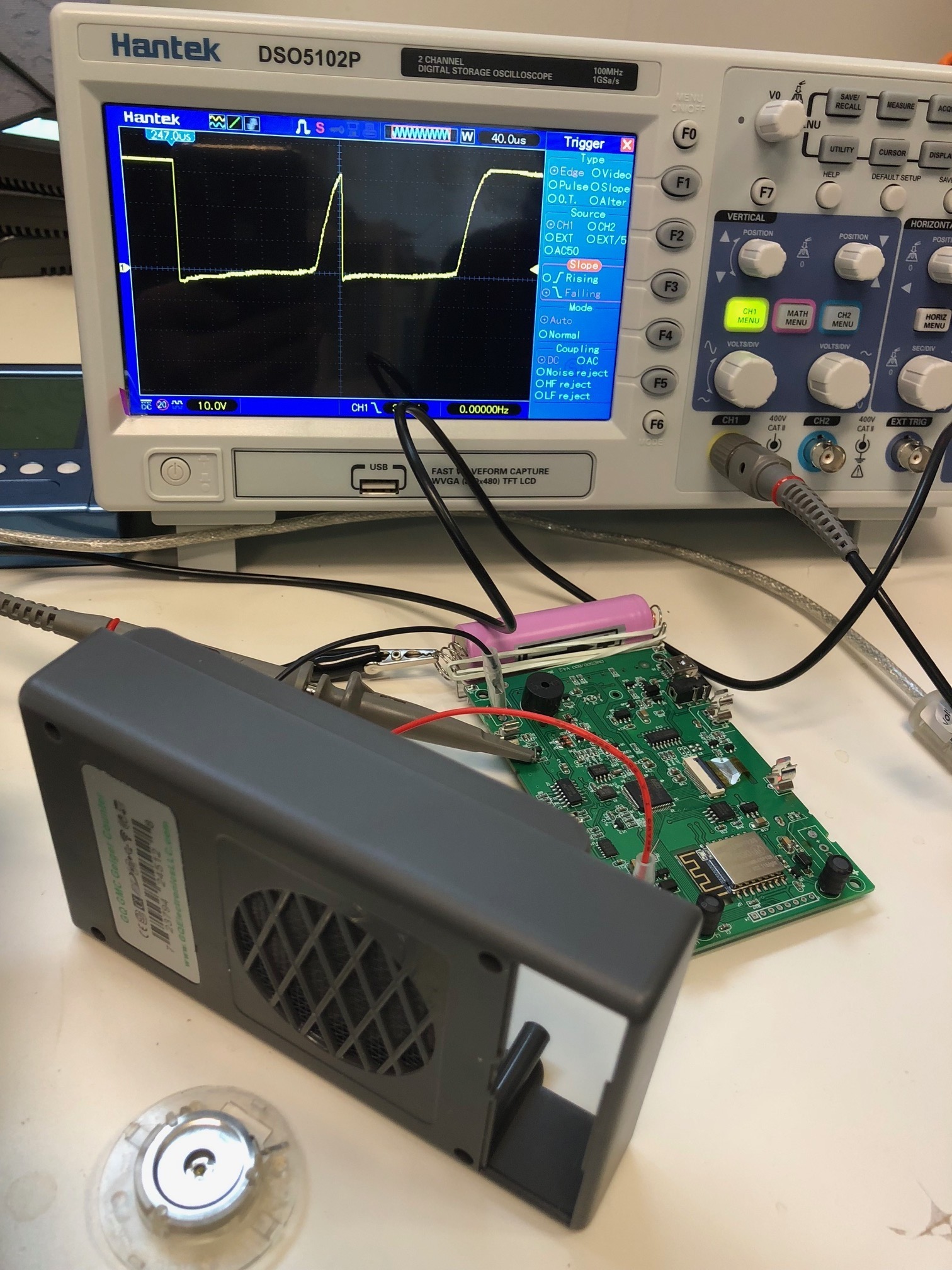

There is a whole bunch of pulse width measurements done by myself and others here:
http://www.gqelectronicsllc.com/forum/topic.asp?TOPIC_ID=4598
Read carefully and note the impact of capacitance!
Not mentioned there is the impact on the Poisson distribution; make sure you look at that carefully. Very important!

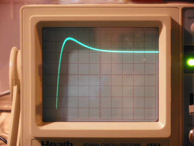

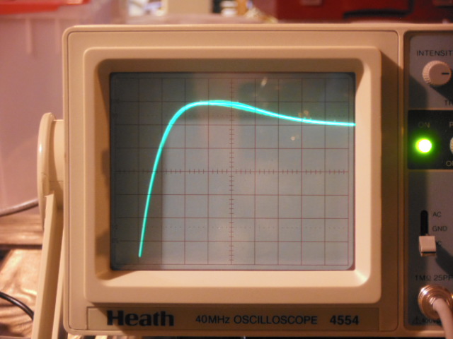

I have added the inductor to the tube 1 augmenting power supply, turning it on. With comments made about a 10 volt increase for 1GOhm meter effect, I believe my measurements so far show that the 500+ with the second tube1 power supply added in and voltage set at the upper end of the plateau (440VDC) supports the 5uCi source (properly placed) in the plateau region of M4011 voltage. This makes the DIY component adds a good thing if you want to make use of the M4011 tube independently of the SI3BG tube. That said, if you're wanting to use the pair of tubes in tandom (as originally designed), then the power supply as we have said through all ullix's work and some of what I've presented shows that 30,000CPM (crossover point for tube1 to tube2) can be supported by the independent power supplies of the V2 as shipped. We still have to work with conversion factors though and ikerrg's access to some high gamma counts is very much welcome. I will show the data from the meters when I resolve a better voltage out terminal structure. The V2 meters don't have that handy capacitor PCB hole that I was able to solder a wire to on the tube1 power supply of the original 500+ that I have, so I have to clip to the tube clips and that is fraught with mechanical instability at this point.
Stargazer 40
Edited by - Stargazer 40 on 10/02/2018 09:45:02

Looking forward to seeing the final voltages and pictures! So it seems that the additional inductor is actually needed to keep the voltage of the M4011 tube when measuring 100 kCPM? Could you tell the inductor characteristics?
The combination algorithm (if it works as expected) is only valid to combine the readings to get the dose rate in uSv/h. The CPM reading is still the addition of both tube CPMs, afaik. With your radioactive sources you could now check how the combination algorithm is working by taking the CPM and uSv/h readings at different radiation levels. This is the next stage of this debugging process. I think GQ should program the combination mode (tube 1 + tube2) in a way that the CPMs are not added, but just combined using the tube’s programmed sensitivity ratios. In http://www.gqelectronicsllc.com/forum/topic.asp?TOPIC_ID=5304 reply #22 and following ones, the algorithm seems to be applied to the calculation of the dose rate in uSv/h, but there is no reason to not to apply it to combine the CPM of both tubes:
CombinedCPM = (tube1CPM*tube1Weight + tube2CPM*tube2Weight*X)/(1+X)
where X = sqrt(tube2weight/tube1weight)
and then the dose rate in uSv/h is straightforward by multiplying the CombinedCPM*tube1sensitivity (the famous 0.0065).
@EmfDev: What are your thoughts about that?
I did an Excel spreadsheet some time ago to prove the algorithm, I can review it now that the hardware is capable of driving both tubes.
On the other hand, I am getting these voltages with the DMM connected.
@22%
M4011: 366 V
SI-3BG: 359 V
@26%
M4011: 404 V
SI-3BG: 397 V
So, much lower voltages that your device, Stargazer_40. There is the uncertainty of the 1GOhm tolerance and the DMM internal impedance, but it seems too much of a difference!
And by the way, I can confirm that the voltage of the non-selected tube is close to 0, so it seems that the 500+V2 is turning off the tube that is not measuring! Well done, GQ!
Edited by - ikerrg on 10/02/2018 12:45:03

Another comment that I forgot in the previous post. The new device has a hole on the PCB where the antenna of the WiFi module is located. I suppose that it is to avoid the RF shielding of the copper layer on the PCB. However, it would have had the same result if you had etched the copper on the surface beneath the antenna, as the PCB is just fiberglass and resin that it is totally transparent to the RF waves. I suppose that the PCB would have been a bit cheaper without that hole cut in the middle.
And does anybody know why there are now two anode resistors in series per tube? RH1 with RH2 for tube 2 and RH3 with RH4 for tube 1. This is a hi-res picture of the PCB: https://www.dropbox.com/s/3mr5fvqowz1kqf6/GMC-500%2BV2%20PCB2.jpg?dl=0
Edited by - ikerrg on 10/02/2018 13:10:20
Reply #36
Posted - 10/02/2018 :  14:09:58  Show Profile  Reply with Quote

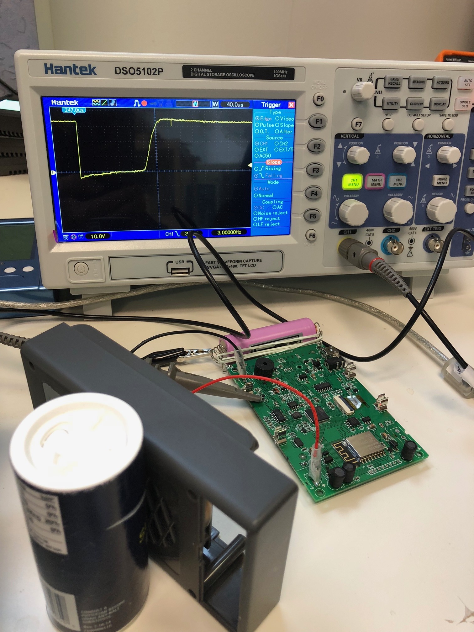

We are going to look into changing the CPM.
As for the voltage, you can use a normal multimeter to measure it.
With a 10M-ohm multimeter, the reading should be around 150V. To check if your device has actually lower voltage.
The hole is there so that we don't worry anymore for any interferences. It might have worked same as without hole.
One of each RH1/RH2 and RH3/RH4 pair is 0 for flexibility. You can change it to anything when necessary.

Posted - 10/02/2018 :  14:24:32  Show Profile  Reply with Quote
Also, when a tube is turned off or (0%) there should be ~3V between the terminals because of the power supply.

I also confirm that if a tube is not turned on its voltage is a nominal couple of volts and not the percentage number in its tube voltage menu selection.

I measured the voltage directly with the 10MOhm multimeter @22% and it was 143V and 140 V. So either my multimeter does not have a precise 10 MOhm impedance (odd, because it is in the specs) or my 500+V2 has a voltage regulation much lower than Stargazer_40's. When I measured the old 500+ some time ago using the same voltimeter and 1 Gohm resistor I found very similar values to ullix's and everybody else, so my guess is that something is different in the HV PS of my 500+ V2. It might be the tolerance of the installed inductors/capacitors, no idea.

It's the inductor ikerrg. One V2 I have gets to 450VDC at 22%. The other gets to 450VDC at 27%. So as long as you can achieve top of the plateau range then PS is working okay.

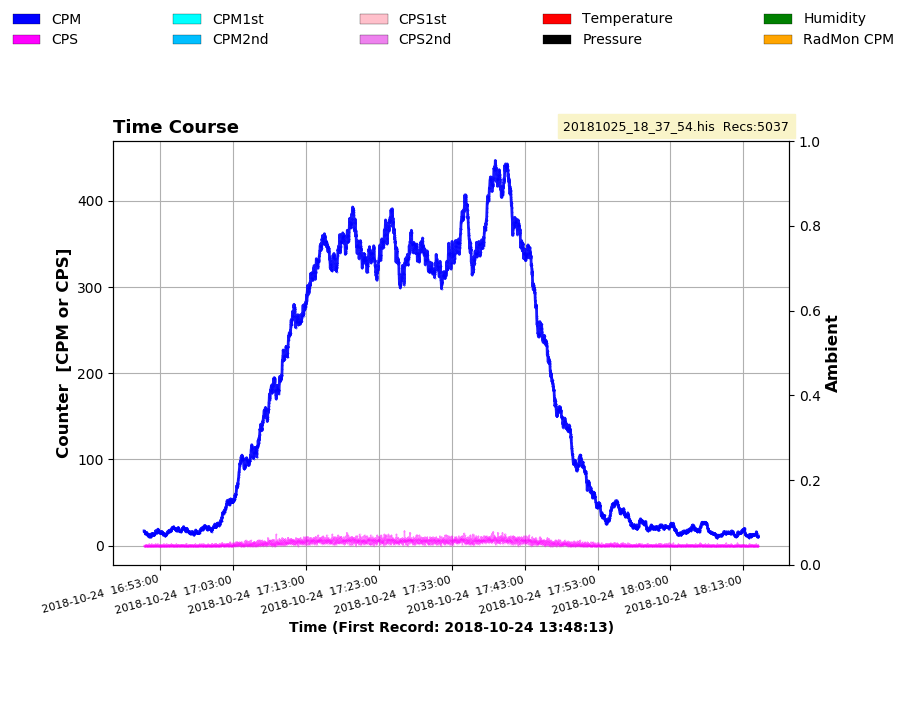

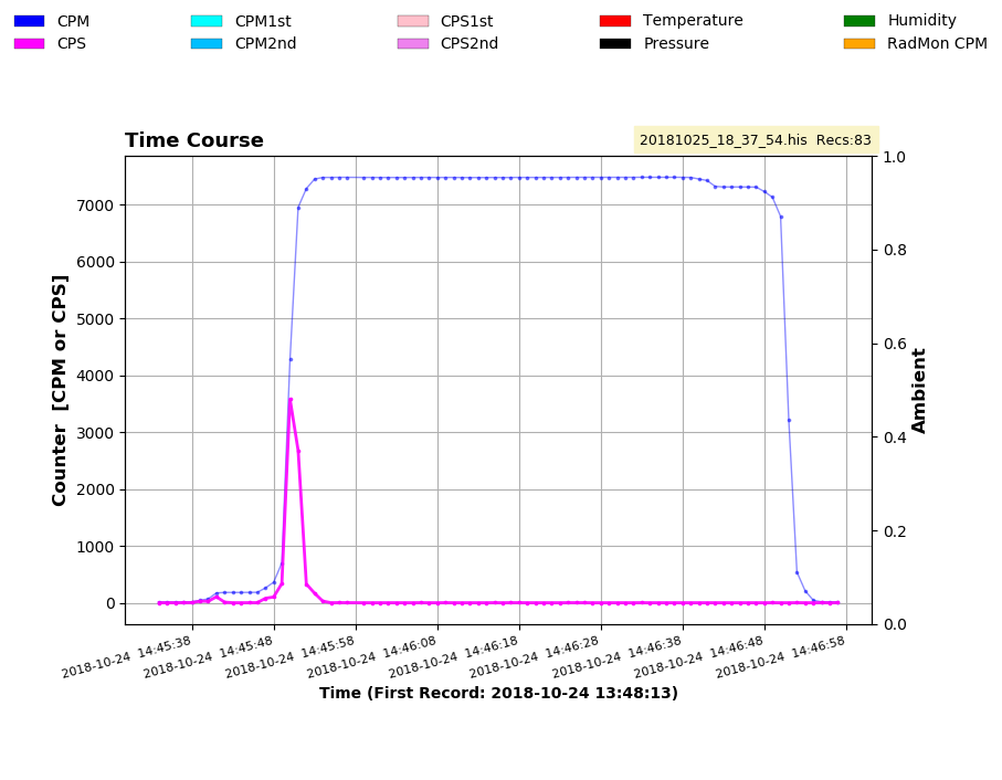

Here it goes an additional piece of data. My last flight from Geneva to Heathrow measured with the 500+V2 and now only using the sensitive tube (M4011). When passing through the x-rays, it peaked at 3581 CPS, with a total of 7025 counts in 5 seconds. This time, the M4011 tube did not look saturated, but the x-ray machine was different and the voltage in my 500+V2 was much higher than when I did the same in Heathrow last summer. I am starting to think that the Heathrow x-ray machines are much more powerful than in other airports! I need more trips and measurements to confirm this.
61120 bytes
About the flight, it was quite a nice collection of data:
84092 bytes
The Poisson distribution looks about right, considering that the cosmic radiation is not homogeneous at all.
By the way, @EmfDev, the parsed data from the DataViewer software is totally wrong again! I did the parsing with GeigerLog and it worked perfectly. Thanks ullix for such a great tool!
Edited by - ikerrg on 10/25/2018 10:53:53
Reply #53
Posted - 10/26/2018 :  01:05:27  Show Profile  Reply with Quote
What kind of supersonic aircraft were you boarding in Geneva?
The graph shows a flight time from 1700h to 1800h, i.e. 1 hour straight from start to landing. The typical duration for that route of some 760km is 1h30min or even 2h? The clock in the 500+ is working correctly?
Re the Poisson Plot: It is applicable only for a constant radioactive source, which must not be moved relative to the counter for the duration of the measurement. When the source's intensity changes, like during a flight, it will become an overlapping set of an infinite number of Poisson distributions. A "good" or "bad" Poisson fit then has no meaning.
But, of course, it might still be a tool usable to verify that nothing unexpected has happened.
Try the FFT on the profile; you should at least see the 1h period being dominant.
Reply #54
ikerrg
334 Posts
Posted - 10/26/2018 :  09:02:16  Show Profile  Reply with Quote
We were delayed and the pilot said that he would try to recover the lost time by going a bit faster. And you have to consider that the radiation increases sharply above some altitude, so the flight might well be from 16:50 to 18:15 or more, and that is 1h 25 minutes. I actually saw just a little above ground background radiation when we were still at 3000 m.
Re the Poisson, I did it only of the flat top, about from 17:13 to 17:33. Even with that, I suppose the cosmic radiation cannot be considered constant.
Edited by - ikerrg on 10/26/2018 12:02:16

First, you seem to assume a non-linear increase of cosmic radiation with altitude, because you mention very little increase up to 3000m.
Second, the "alpine" profile at cruising altitude looks like being well beyond any Poissonian fluctuation. I suspect the flight went up and down to stay in some assigned flight corridors?
Would be great if next time you could register time of takeoff and landing, as well as altitude over time?

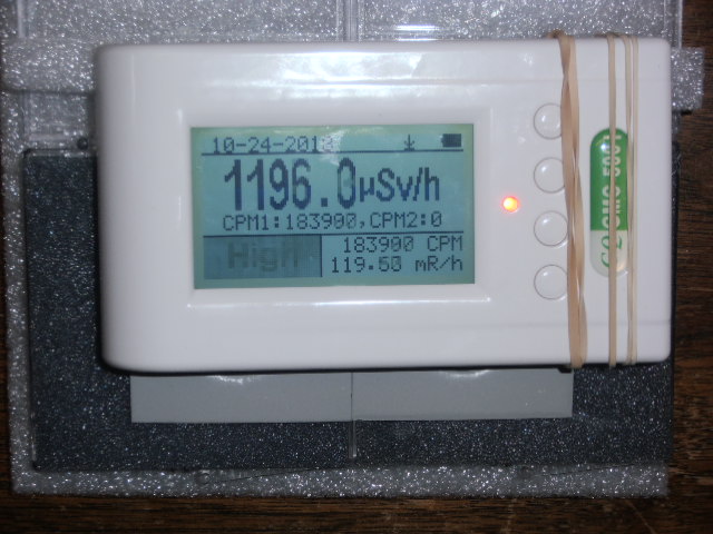

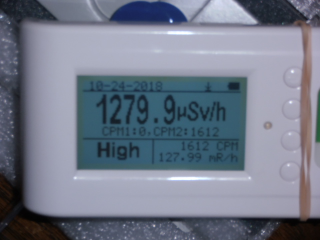

In anticipation of the dead time correction addition to firmware I have been looking more closely at the comparison of M4011 tube performance against the SI3BG. I am more convinced than before that the SI3BG GM tube is a very nice compliment to the M4011 GM tube (as far as Cold War GM tubes go).
Receipt of higher activity Cs137 source has allowed both tubes to be effectively employed and shed some light on dead time correction, but will be better comparison once firmware does the work.
Here is a pic of the M4011 tube with both 5 and 10 uCi sources stacked with slight offset at center of tube. ~184,000CPM and ~1,200uSv/h
79407 bytes
Here is the SI3BG in the same configuration. ~1,600CPM and ~1,280uSv/h
81027 bytes
In rough numbers, the 184,000 CPM has a corrected for dead time CPM of ~217,000CPM. In order for the SI3BG tube (with a dead time correction at 1,600CPM of only +9CPM) to match the corrected CPM of the M4011 tube at conversion to uSv/h (.0065) the SI3BG tube's conversion needed to be at 1.13CPM/uSv/h (.885). I had initially wanted to use .797 as the average of high and low given in specs, but in fitting the data I found lower end was better. The other significant change was I needed to lower the dead time of the M4011 tube to 50usec. ullix showed that dead time is somewhat insensitive adjustment, except at very high counts, and we really don't know yet what the actual dt of the M4011 is, so all is good in my opinion until we are comparing the two with working firmware to adjust the calibration with both conversion factor and tube dead time. That the dead time correction for the SI3BG is inconsequential at 1600CPM makes this pretty straight forward.
What my expectation is after this comparison, is that the dead time is going to be just one of the factors involved in getting the best calibration of the meter (both tubes to agree). It remains an important add, but we are going to find that once implemented the best numbers for conversion of both tubes and dead time for the M4011 tube will be essentially standardized, and for the out of the box performance of the meters we can say with some certainty that we are adequately incorporating the correction. The dead time of the SI3BG was estimated at 200usec for this test, but I don't think I'd worry much about that.
Further work here will wait till firmware is done. Then with three M4011 tubes and four SI3BG tubes in stock to get better averages I will go through this all again to see if I can come up with a better estimate of parameters for conversion and dead time in general. I also want to look at these numbers with shielded sources for gamma only. The mixed energy levels of betas and gammas are certainly affecting the numbers and the gamma response is what's in the specs.
I was just going to start writing before I finished reading your full post, but your last sentence is exactly what I was going to say. In order to compare both tubes, we need to use only one type of radiation, because both are quite different in their response to betas and gammas. And the best are gammas because it is not possible to shield at once the gammas and not the betas.
The conversion to uSv/h is irrelevant for this comparison, it only adds confusion. We need that the firmware can be flexible enough so the users can calibrate their counters for a given type of radiation and source, but we cannot expect to set perfect default values valid for any kind of radiation out of the box (just to use something sensible). The most we can ask to GQ from their product is that the counter firmware can use a dead time correction and a uSv/h to CPM ratio specified by the user, and that the hardware can keep the voltage of the GM tube inside the plateau even at high count rates. We almost have everything already! With all that, it is up to the user how to use the counters in the best possible way.

We just found that the 600+ LND 7317 dead time is on average about 240 microseconds.
Gamma
671843 bytes
Alpha
667953 bytes
Edited by - EmfDev on 11/01/2018 15:04:41
Reply #80
Posted - 11/01/2018 :  14:07:53  Show Profile  Reply with Quote
These are for the 500/+ tubes.
M4011 = 120 uS
SI-3BG = 30 uS. (very different from the specifications minimum of 190 uS)
M4011
657811 bytes
SI-3BG
724945 bytes
Edited by - EmfDev on 11/01/2018 14:11:18

@EmfDef, what two points on the board are you taking measurements from?
Stargazer 40
Reply #87
Posted - 11/01/2018 :  16:06:35  Show Profile  Reply with Quote
Tube 1, is from ground and the collector of transistor V3. And ground to collector of transistor V4 for tube 2.
Some interesting findings for M4011. We tried to measure the dead time by varying to voltage and observed that
the dead time becomes narrower or shorter (66 micro seconds with ~350V) compared to the 120 uS with around 400V.
Does that mean that the minimum dead time from the LND 7317 of 40uS can be reached at very high CPM when the voltage
drops really low? We'll need more testing for this one.
Reply #88

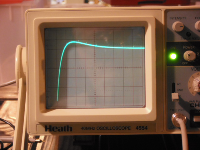

My oscilloscope is a bit dated, but the functionality is there. Testing the M4011 with voltage set at 450VDC with 1G probe in series and gas mantles. Connections are (-) battery clip and anode clip (after anode resistor). Here is a shot of the screen (I will get better at this) with vertical .5VDC and horizontal 50usec per large division. I can see recovery, but aside from voltage settling only the quicker settling between tubes is indicative of smaller deadtimes.
80950 bytes
And here is SI3BG with 50usec. Faster recovery from power supply response.
81166 bytes

Next I did the SBT-11A at 450VDC. Here is 100usec per major division. With mantles.
78663 bytes
I tried to measure the LND-712 that I adapted to the 500+V1. It has a 10Mohm anode resistor in the wand and the LND-712 is glued to the tube so can't get at it to get past it to just the anode. I could see very small voltage drops at the meter connection to the wand cable, but couldn't get low enough trigger to get pulse locked in on the display.

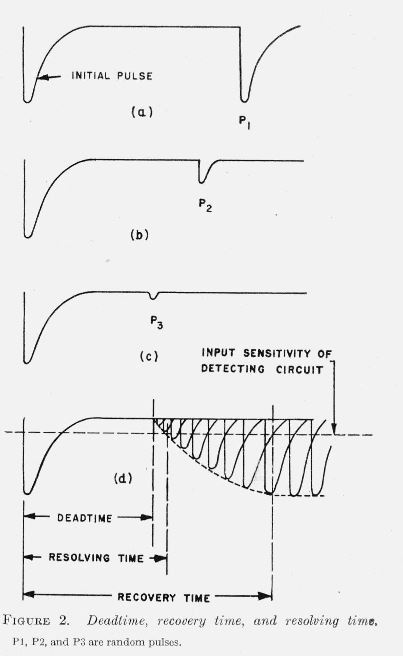

I don't believe that it is sufficient for the voltage drop to return to the level prior to the particle caused avalanche for determination of dead time. This paper from 1949 discusses further delay while positive particles redistribute within the GM tube. It is not simply a function of power supply's ability to support with enough current.
https://nvlpubs.nist.gov/nistpubs/jres/42/jresv42n3p241_A1b.pdf
Here is figure eight
28626 bytes
The GM tube won't be fully ready till Recovery Time complete, but probably will generate a pulse at Resolving Time. @GQ, what does your measure at the Collector of the transistor actually mean? It doesn't look like the pulses we've seen so far.
Stargazer 40
Edited by - Stargazer 40 on 11/03/2018 05:33:17

It is not so difficult to measure the "Resolve" time. All you need is a 2-channel storage oscilloscope; a simple but sufficient one is this: https://www.amazon.de/gp/product/B00SXVUETU/ref=oh_aui_search_detailpage?ie=UTF8&psc=1
Look into my measurements shown here http://www.gqelectronicsllc.com/forum/topic.asp?TOPIC_ID=4598 under Reply #14.You see dual traces of anode signal and audio signal. The bottom 2 pics are most relevant.
You see that @100µs there is no audio signal, while @150µs there is. Now, this is using the audio signal as a proxy for a "good" count, which needs to be proven to be true.
With this and other measurements I concluded back then that the "deadtime" - you now call it "resolve time" - was 200µs. This time would be used for the "deadtime-correction" with the formula I gave.
For new measurements I'd suggest to use channel 1 at the cathode (not anode, because the counter uses cathode sensing), and make this the trigger signal, and use channel 2 at the interrupt pin of the microprocessor, which is used for counting.
And then use a high-count source and restart single osci shots until you have some where 2 pulses come in close enough succession from 50µs ... 500µs. Is a bit cumbersome but possible.
Bear in mind that it is not overly critical what the exact deadtime/resolve time is, as shown in this graph:
92306 bytes
