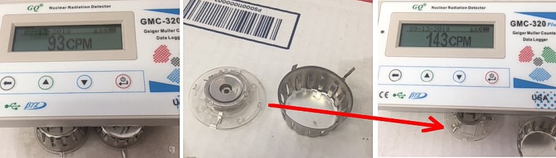

All your source are very low radiation, you need to use Timed Count to compare with regular back ground level. Longer Timed Count period, the more differences you can see.
The smoke detector only has very little Gamma radiation.
Here is one of the picture showed how a smoke detector sensor used to test the unit:
