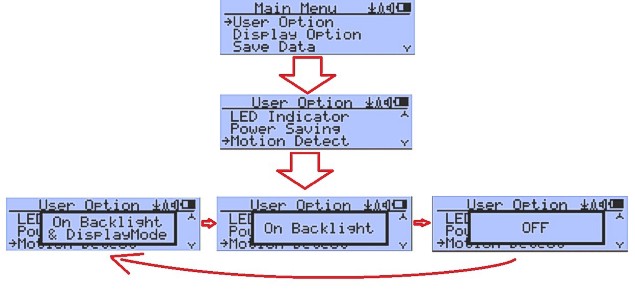

Posted - 08/17/2018 :  06:43:28  Show Profile  Reply with Quote
This Display Mode Controlled Motion feature can be disabled from device menu.
It can be disabled by user.
