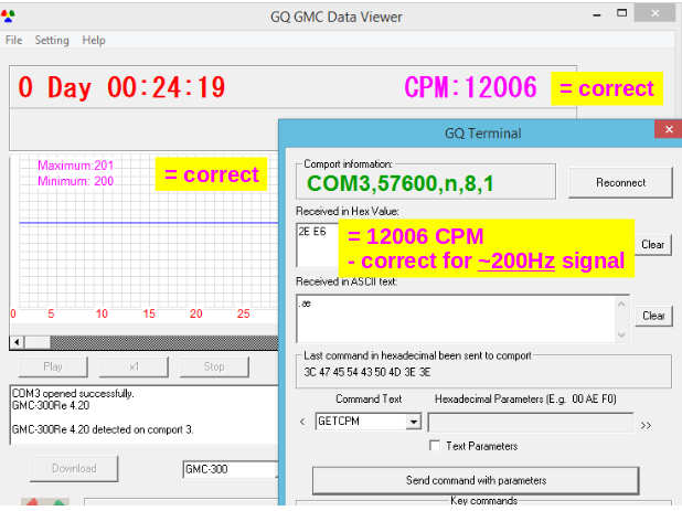

I fed a signal from a signal generator to the counter as described here http://www.gqelectronicsllc.com/forum/topic.asp?TOPIC_ID=4613 but this time I watched the counts using GQ's DMC Data Viewer Software 2.35 (2016). At 200Hz DV gives the correct answer of CPS=200 and CPM=12006. Calling 'GETCPM' in the GQ Terminal gives 2E E6 in hex, which is 12006 in decimal. OK.

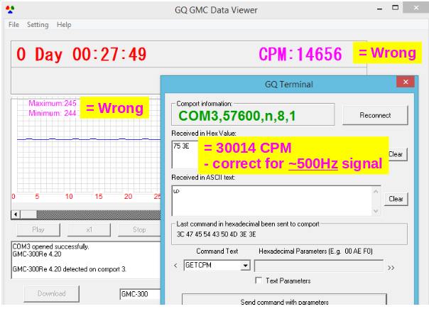

But when you increase the signal to 500Hz, which should give you CPS=500 and CPM=30000, you only get 245 and 14656, resp.! However, again calling 'GETCPM' from the GQ Terminal gives the proper 75 3E or CPM=30014, ok for an ~500Hz signal.
