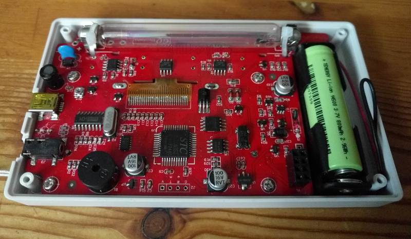

Posted - 08/04/2017 :  04:35:10  Show Profile  Reply with Quote
Hey tcp100
Try to open the (turned off) device, and check if the tube is mounted correctly (there's a + - sign on the tube, it should match the to the plus-pole on the board... (attached a photo of my 320v4; the plus-pole (indicated by a picon) is on the left
(if you have to turn the tube, don't touch it with your fingers, wear some gloves)
If this is correct, i suspect the tube is getting too many volts - this would be a task for the support@gqelectronicsllc.com
