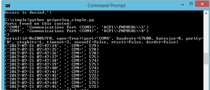

I am currently experimenting with Windows Virtual machines, so here geigerlog_simple.py is running life on a virtual win8.1 under Py:
9623 bytes

$ python3 ./geigerlog_simple.py
Ports found on this system:
/dev/ttyUSB0 - USB2.0-Serial
2017-07-21 17:40:27 , CPM= 513
2017-07-21 17:40:28 , CPM= 515
2017-07-21 17:40:29 , CPM= 519
2017-07-21 17:40:30 , CPM= 523
2017-07-21 17:40:31 , CPM= 517
2017-07-21 17:40:32 , CPM= 520
I didn't bother to clean up the print statement, but the log file is clean on all systems.
