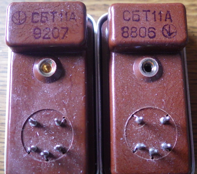

I just got SBT-11A tubes. At least this is what it says on the imprint stamped on the back of the tube, see picture. It does look like a genuine print, and not with an "A" added later.
The line below says "9207" and "8806". Is that July 1997 and June 1988, or is that lot 92 from 2007 and lot 88 from 2006? Or something totally different?
I tested the tubes against each other and a M4011 and a SBM-20. The SBT-11A come out very close to a SBM20 and about 30% better than an M4011, when tested on K40 (KCl) and Th (gas mantle). I can't say to what degree -if at all- they respond to alpha emission.
What I did NOT see was the lightshow of flashes in the tubes when reciving radiation that some people found on such tubes.
Is that perhaps the distinguishing feature between an SBT-11 and its "A" version?

I would say both of those are SBT-11A tubes, the images of others I saw had a completely different font for the added 'A' (and not the same colour either). You won't see the flashes except in near-darkness.
With your alpha source (thorium not KCl) close to the tube then inserting a sheet of paper between the two should reduce the count dramatically, that would be a crude confirmation of alpha sensitivity by physically blocking the alpha particles. Because they are so easily stopped you'll only pick them up in the first place with the detector placed within an inch or so of the source which itself is not enclosed (not in a container or plastic bag).
