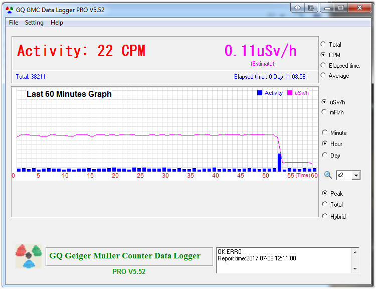

Spotted another spike... As noted, I don't watch the output so no knowing how often this happens - but it looks like this:
148765 bytes
