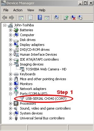

Com1 port error probably means you're using the wrong port.
Go into the Device manager under PORTS with the device connected and see what actual COM port it grabs.

The COM1,COM2 for all windows are reserved for real comport. All virtual comports should start from COM3. So, COM1 open error is the problem that you signed a wrong comport to the software.
Open device manager and to see what comport number is assigned to your device. OR you can try auto detect from menu.
See:
64965 bytes
