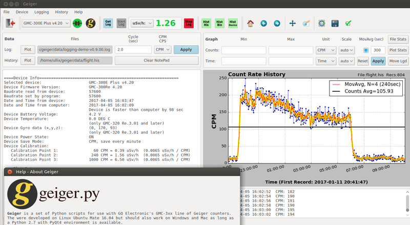

My Python scripts have matured into a GUI program, version 0.9.00 just uploaded to https://sourceforge.net/projects/geigerlog/ and is available from there.
239605 bytes
Geiger is a set of Python scripts for use with GQ Electronic's GMC-3xx line of Geiger counters. Beginning with version 0.9 it is a windowed (GUI-) program. It was developed on Linux Ubuntu Mate 16.04 but should also work on Windows and Mac as long as a Python 2.7 with PyQt4 environment is available.
The program allows reading of Geiger counter data, printing to screen and logging to file. Comments can be added to the log file during logging. The history stored on the Geiger counter can be extracted and converted into files that can be printed and analyzed.
From all data - Log data or History data - graphs can be created and shown as Count Rate History versus time. The Count Rate can be shown in units of CPM or CPS or uSv/h. The time can be shown as time-of-day, or time since first record in units of sec, min, hours, days, or auto-selected in auto mode. During logging the graph is live auto-updated. Both graph axes can be in either fixed scale or auto-scaled mode. The graphs can be stretched, shifted, and zoomed for details, and saved as pictures in various formats (png, jpg, tif, svg, ...).
Time ranges can be set to analyze statistical properties of the data set within that range and be plotted within that range. The ranges can be entered manually or by left and right mouse clicks for left (min) and right (max) range limits. All manipulations can be done during ongoing logging without disturbing it.
A log can be collected in the background, while you analyze a history in the foreground.
Geiger functions can be controlled from the program, and changes made without interrupting logging. All communication with the device is checked for errors, which unfortunately do occur occasionally. The program attempts to auto-recover from an error, and continuous if successful, which it is in most cases.
The USB port used and its baudrate for the connection with the device can be auto-discovered.
A genuine recording of Geiger data from an international flight is included, indicating count rate increase with altitude, and reduction of cosmic rays when going from north towards the equator.
