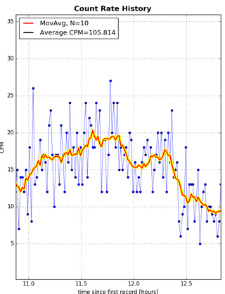

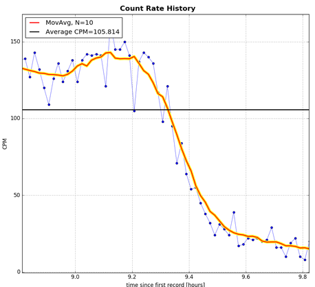

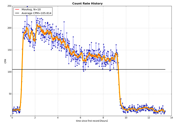

A genuine recording of Geiger data from an international flight is included. When the GeigerLog scripts are run on this file (note instructions in README.TXT), it produces the first graph, showing the count rate from check-in to after landing. One sees the count rate increase with altitude, and the reduction of count rate during the flight. This is due to changing magnetic fields reducing the cosmic rays when going from north towards the equator. This effect is known since early last century. But then the device had a weight of almost a ton. Today it slips into a handbag ;-)
The little bump around 11-12h is due to a flight in a seaplane to the final destination.
The other 2 graphs are zoomed-ins from the first. (using the little controls you find on the lower left of the onscreen graphics)
