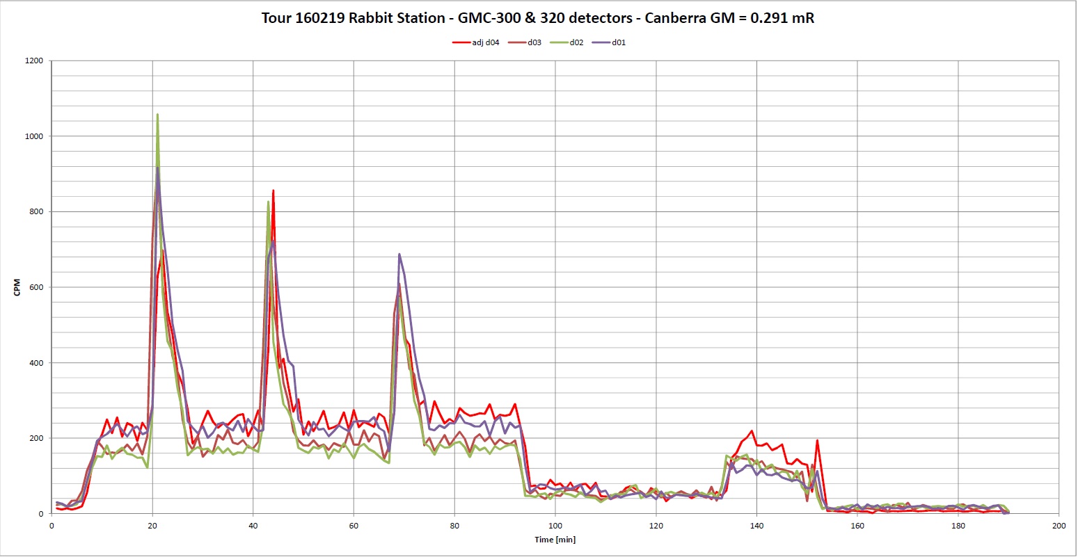

I recently used four different devices, two GMC-320+, one GMC-320, and one GMC-300, in an experiment at our research reactor. We were giving tours to high school students and part of the tour was activating a small foil of aluminum. The Al-28 has a half-life of around 2.5 min and makes for a nice safe demonstration of certain radiation experiments. I had placed the four GMC geiger counters (in data logging mode) near the location where the experiments were conducted. A plot is shown of the response curves from the detectors. For one of the units (a GMC-320+ shown as d04) it was necessary to adjust the response (divide by a factor of 2.5) to be consistent with the other three units. The source-to-detector geometry was the same for each detector. It is interesting that one unit has such a higher response (in counts) than the other units. The peaks in response were from the freshly activated foils being returned from the reactor core via a pneumatic "rabbit". The initial elevated background was due to the operating reactor. The later elevated background was due to my movement of some other gamma sources near the GMC detectors for a short while.

The logging interval is a too big to make out the 2.5min half-life, otherwise it's awesome! Did you activate them using a neutron source? I suppose there is no way for me to repeat this experiment at home... :(
