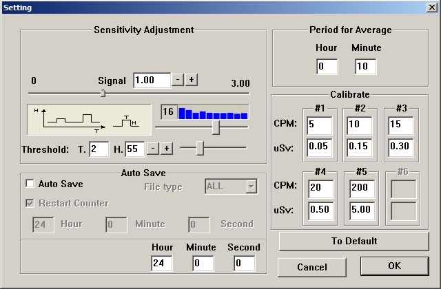

Am new to this instrument and software so please bear with:

Posted - 08/28/2011 :  19:30:54  Show Profile  Reply with Quote
1. "Data Input Sensitivity adjustment" is a general term. It includes more than one factors to be adjusted. Such as number of spectrum bars, W,T threshold value, gain etc. All those settings can be found from Setting->Other menu items.
2. When registering, please make sure your registration computer has full internet access. If first time registration fail, try one more time. Exit and restart the software after successfully registered.
Please exit the software and re-run the software if it failed registration after two attempts.
software menu Setting->Other
