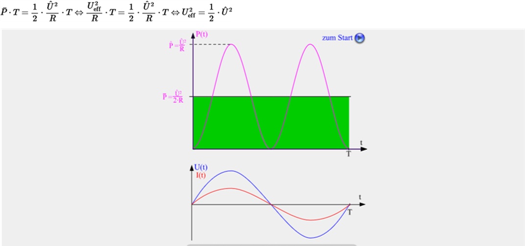

Posted - 08/24/2025 :  07:28:49  Show Profile  Reply with Quote
I need to get back to your answer.
You said They use Peak readings.
Does EMF-390 show the peaks of power P across time (green field) or the peaks of the sine function in the image?
Thank you.

Posted - 09/10/2025 :  14:44:27  Show Profile  Reply with Quote
Dear all, I gave it some more thoughts about my question and as the tool is measuring multiple electric fields with different frequencies simultaneously my previous picture in Reply #4 does not apply.
An oscilloscope would most likely show something that looks like a graph of rock music.
Trying to work with U²eff to determine an electric power for direct current will always fail because peak values are measured, saved and displayed (see Reply #2 above).
This is why using an arithmetic mean is fully acceptible.
Many thanks to EmfDev and the answer that I did not understand before.
Good work.
